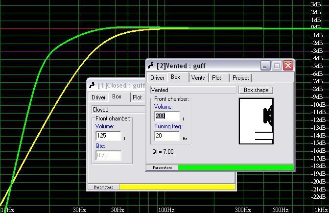

I know I have many questions, but the first is: Vented or Sealed? :scratch1:

-_nando-_ said:
IS IT 125 and 200 LITRES?? :bigeyes: :bigeyes:
Can you sugest me a better subwoofer (for home use) and cheap ?
I'm taking a look about linkwitz transformer around the forum :)
Yup, 125 and 200 litres according to the specs you posted,
main cause is the 125L Vas of the driver.
Personally i'd go for two seperate subs with 300Hz c/o frequency.
Not sure what drivers are available in Brazil,
not much as far as I could tell when I was there.
If you can get them two Tangband 8" drivers would be good :
http://www.partsexpress.com/pe/showdetl.cfm?&DID=7&Partnumber=264-833
note the Vas of 18.5L.
:) /sreten.
