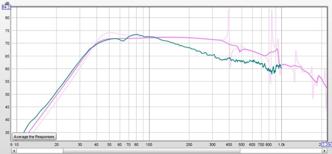

Does it matter if the enclosure size for the coaxial car speakers are much smaller than recommended enclosure size when i add a sub with correct volume and a passive radiator?
Thank you for the feedback on the executive! Can you give more detail about the results? I've been planning to build one for someone else and I hoped that long excursion tang-band with the passive radiator would have been enough. Do you think it is underamplified, and/or are you hitting excursion limits? As a fallback from an outdoor party speaker, would it at least do well as an indoor, medium size room stereo?
I would think your mids would be fine in a smaller box but it would raise the f3 and you'd want to raise their high pass filter (and raise the subs low pass) to compensate, or else you'd end up with a hole in the response between the two.
It will work alright for a small/medium sized. The sub starts rattling at high volumes and the speakers just sounds to bright and harsh at high volumes. But i still think it is better compared to anything else on the market at this time. Would recommend making a bigger battery pack if you consider building one.
