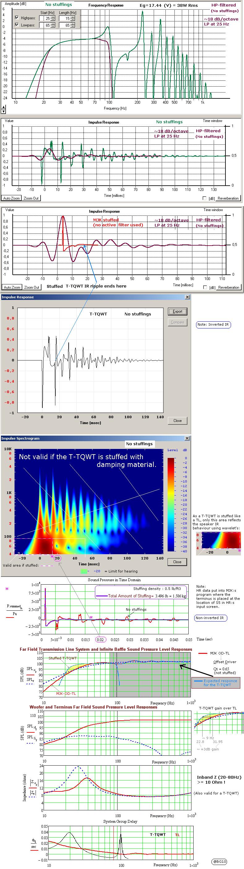

Hi, You wont regret if building a T-TQWT with Skytronic 902.222 driver😀

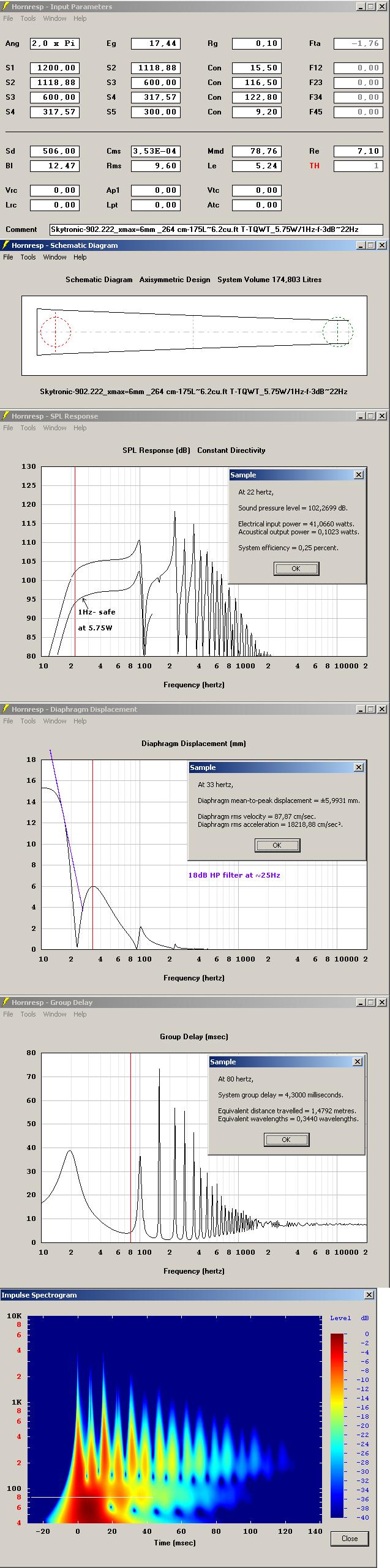

It sounds like you're setting off in a similar way to I did. I actually bought the driver after being convinced by the sims that it'd go flat out to 30Hz. The box was large, though. Needless to say, I didn't build the large box, and bought one of these pre-made car "sub" boxes. It wasn't very good. Hit you in the chest at 80Hz, but very little below that.
So, I tried again, this time, I did some research into bass from smaller cabinets (for a bedroom system). Came up with 2x8" drivers, 42L sealed, with a Linkwitz Transform circuit to get the bass nice and low.
Anyway, here's a link to a supplier that delivers pretty quick (linked to the page with lots of Visaton woofers - they're not the best, but parameters are available, which is a plus...).

Yeah, as soon as I saw that the specs had TL 'written' all over them, I figured that if you hadn't simmed something by the time I got done with rearranging leaves........... 😉

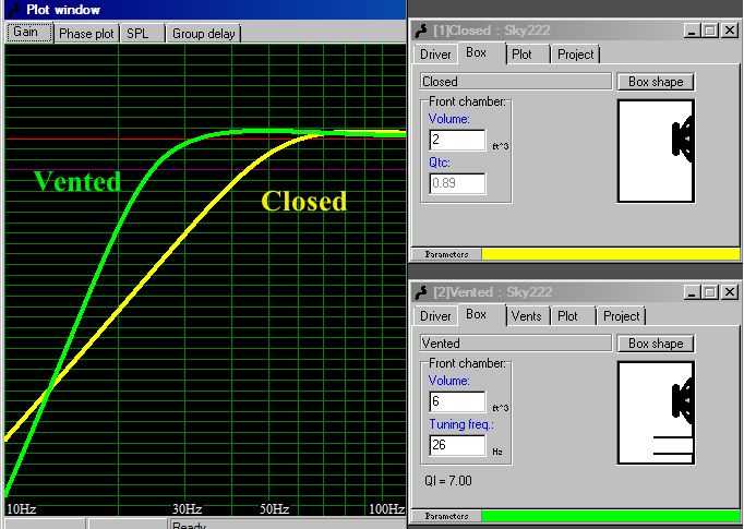

Thanks for your thoughts folks, a few in return :
sreten> "that comes from trying to vent
a driver that should be used sealed"
Yes, that is what puzzled me and why I added the PS in my orig. post
about the closed box that WinISD proposed, didnt
look as good, to my untrained eye, as the vented
proposals.
see my new attachment, in which a closed box of 2cuft is shown

If you build a 2 cuft box and stuff it well you should be able to get the Q
somewhat lower than 0.9, though you could go a little higher, say 2.5cuft,
(assuming the published Vas is accurate, you can check driver parameter
consistency in WinISDPro, and quite a few other things not in WinISDbeta.)
Room gain is a fickle thing, the box roll-off might work well or add a bass
boost circuit very low, similar to Baffle Step Compensation
but with a much bigger capacitor.
rgds, sreten.

..bjorno> "T-TQWT"
errr ? I found TQWT via google but what is the T- bit ?
I fear that my woodworking skills may not be up to
that ! Perhaps for my second project LOL! and those
resonances/comb structure looks a bit fearsome.
I will have to do a lot more reading on that, thanks for
the pointer tho,,
T stands for Tapped and as GM wrote:'the specs had TL 'written' all over them', I too agree.
A T-TQWT is IMO a very simple enclosure to work with:
Just a box with an internal divider + an access lid where the terminus is located but if not mounted, turns the T-TQWT into an OD-TL(TQWT) Offset Driver that comes very handy for an in-room smooth FR if the box is placed in a 0.5PI corner where most speakers picks up a lot of boundary gain.
The wavelet picture is misleading because it shows an un-stuffed box: You have to shave off a lot of shown resonances and combs before an interpretation can justify the T-TQWT: See the picture..
b🙂
