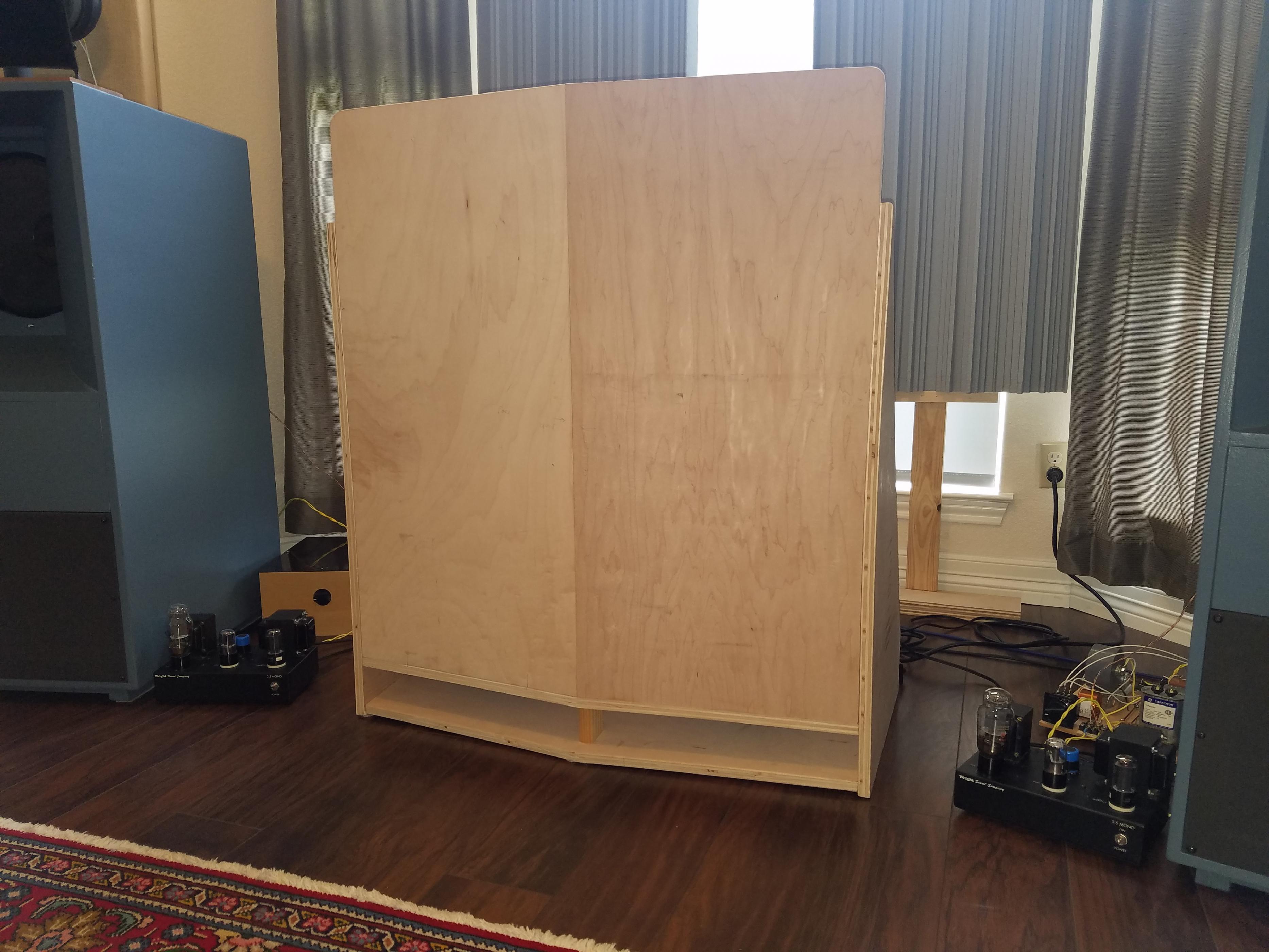

I am using two 421 8LF drivers for sub duty, SLOB implementation with miniDSP XO with steep slope and some low end boost .
Best combo so for and blends very nicely.
I have tried a few different subs and this is by far the best
Using 825 cabinets, 416 8A / 805B horns / 299 8A
Nice. :up: What sort of cabinet for your 421s?
It is based on JC Morrison SLOB article and a down sized version of the v shape down firing one.

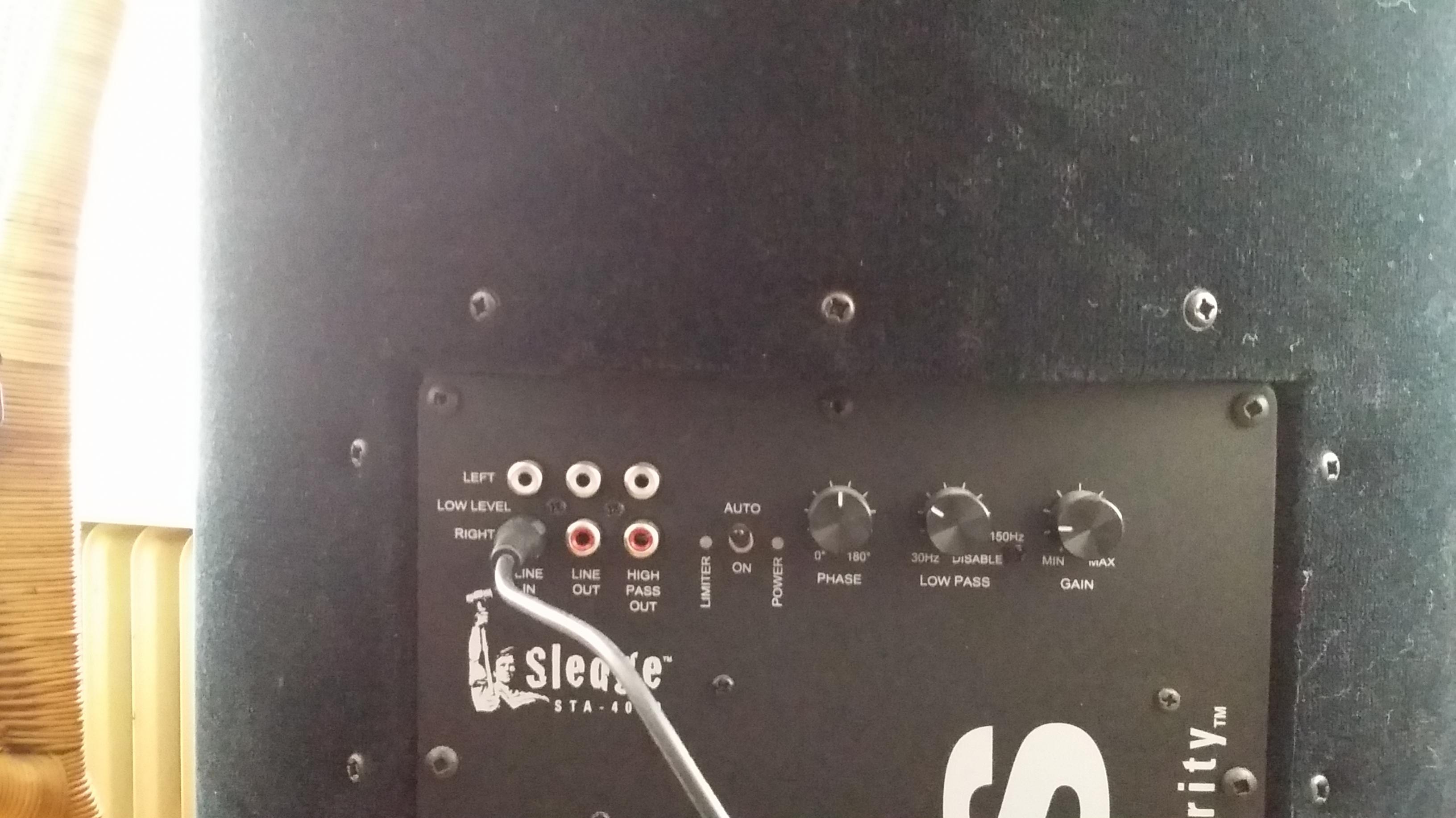

I run my sub with a Crown amp with integrated dsp.

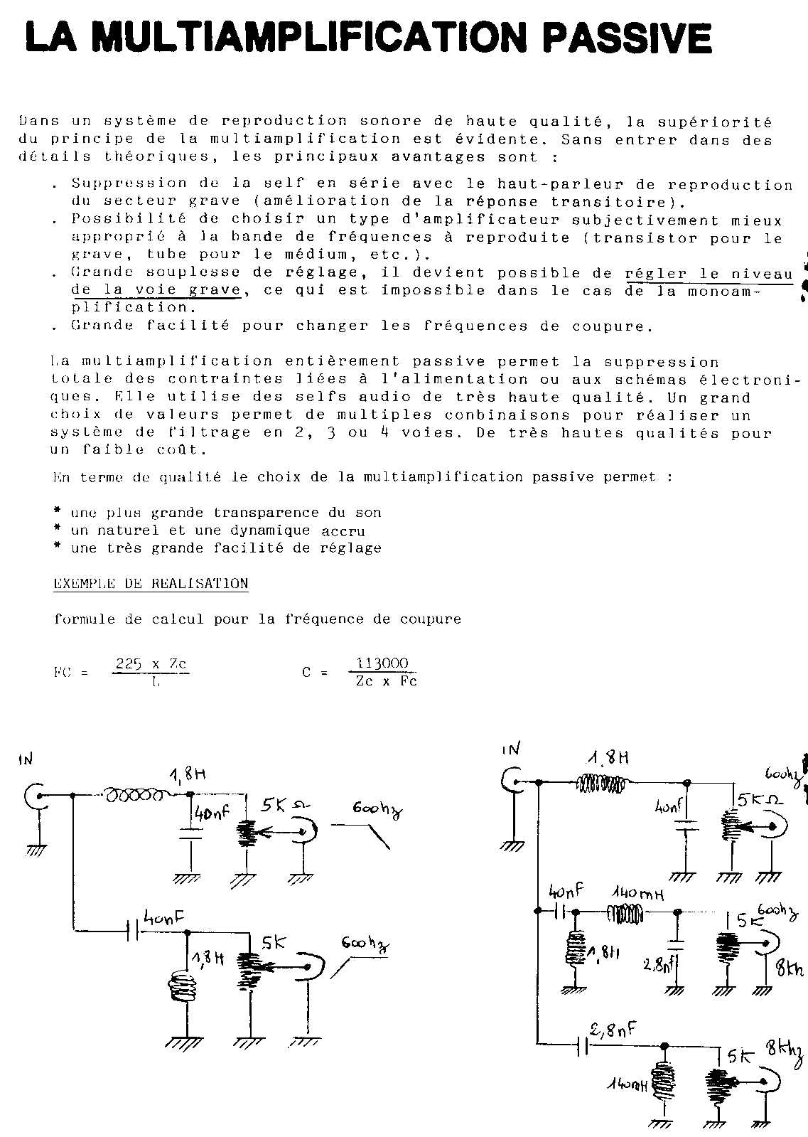

I will be using a 12 db filter between pre- and power amps.

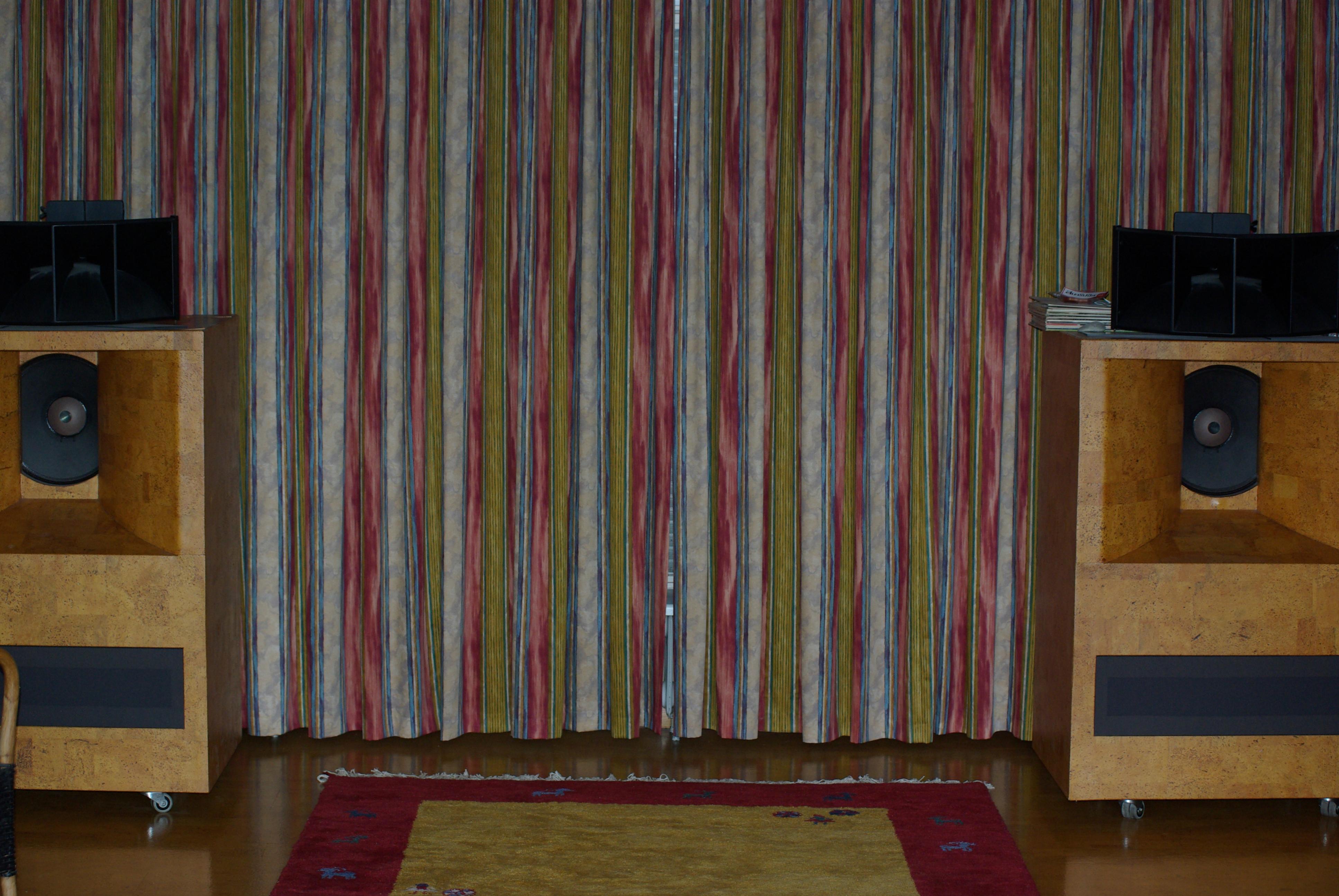

It would be nice if i can just blend in my two SVS active subwoofer with their built in SDS filter and using the Altecs 515 without any filter element to filter out let us say 40/60 hertz.
I dont know how Jean Hiraga blended the Magnat woofer with the Altec. Most people dont have the space to use VOT. I have but i cannot add anything more. I could add wings but it would be nicer to use the two active SVS subwoofers. They are kind of big but they blend in well with the other furniture.
Greetiings, Eduard
