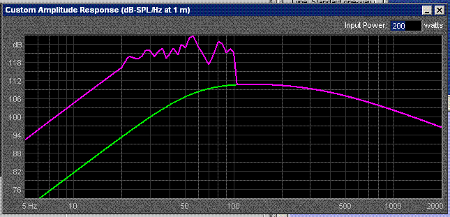

paulspencer said:
No simulation program is really going to tell you the actual SPL you will get out of a subwoofer. Room gain and modes are too unpredictable for a start and they will have a big impact.
Also power compression is not normally allowed for.
Also what you simulate at 1m takes no account of the size of the room.
If anyone can come up with a comprehensive simulation/calculation of the actual max SPL achieved and then verify it with measurements, and be accurate within 3db, I'm impressed (or they are lucky).
If you can get a baseline performance of a "reference" subwoofer in the intended location it's pretty straight forward to get a model of the response of whatever design you intend to use in that environment.
For example, I've measured the cabin gain of various vehicles with different sub locations and configurations of sub enclosures, I can then model a design and super impose the cabin gain on it to see how it would perform in the car (see attachment, note my measurements only cover 20-100hz hence the abrupt jump)
It's simply a matter of getting sufficient data.
