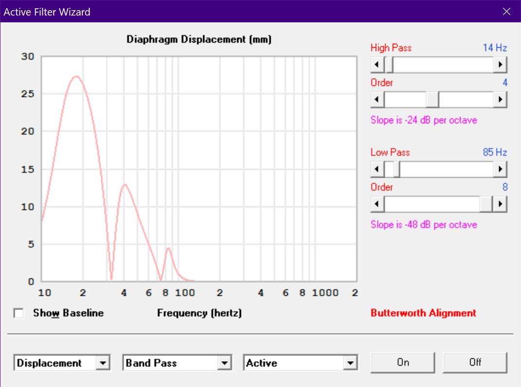

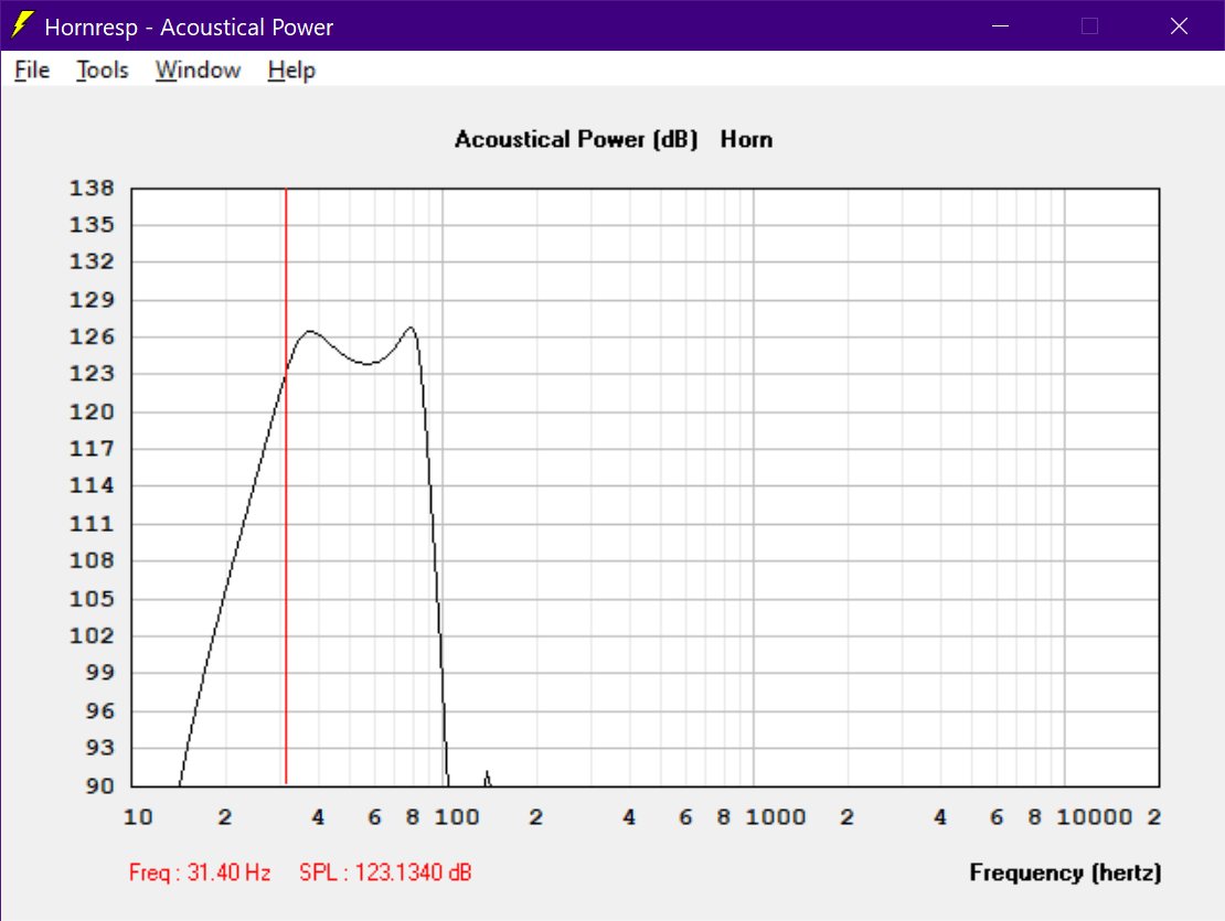

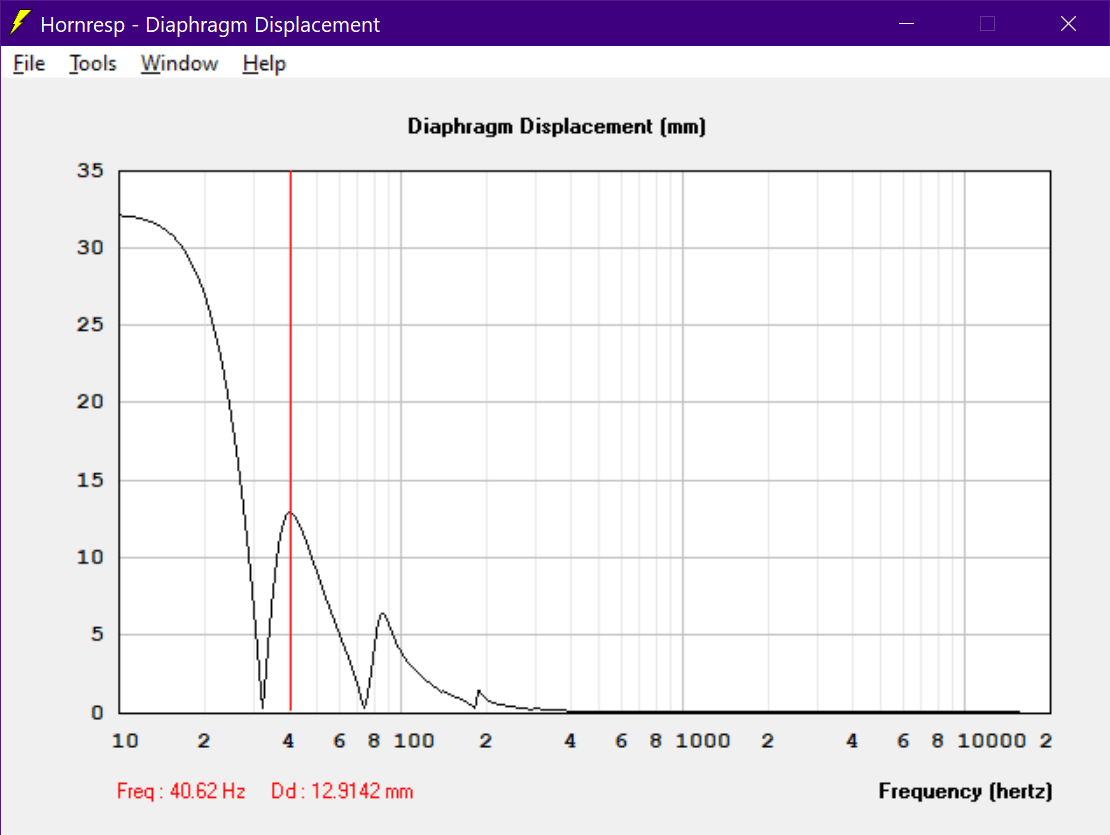

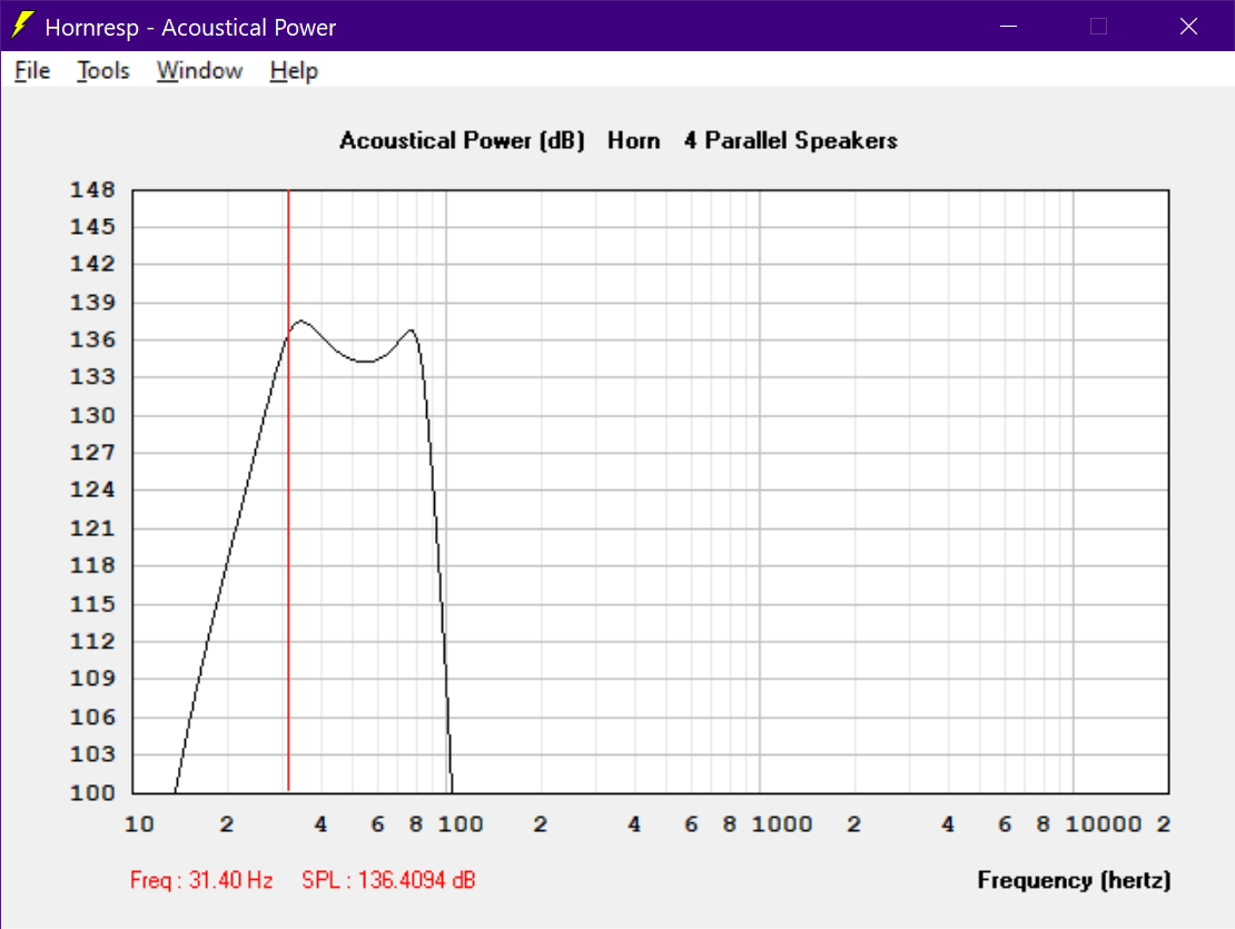

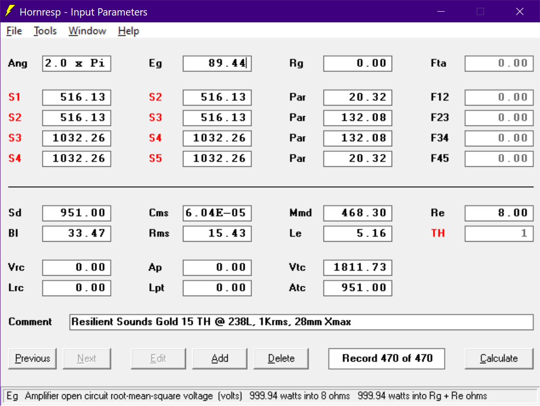

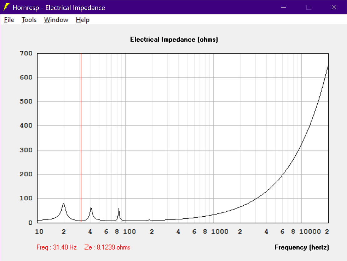

For efficiency most important is having big drivers and enough of them. Qts and Qes is less important (with dsp) :
https://www.diyaudio.com/community/...how-off-my-new-18in-build.365764/post-6711139
https://www.diyaudio.com/community/...how-off-my-new-18in-build.365764/post-6765958
High Qts can give you more efficiency
https://www.diyaudio.com/community/...how-off-my-new-18in-build.365764/post-6767025
If all else being equal, Higher Bl, lower Qes and Qts are always better.
