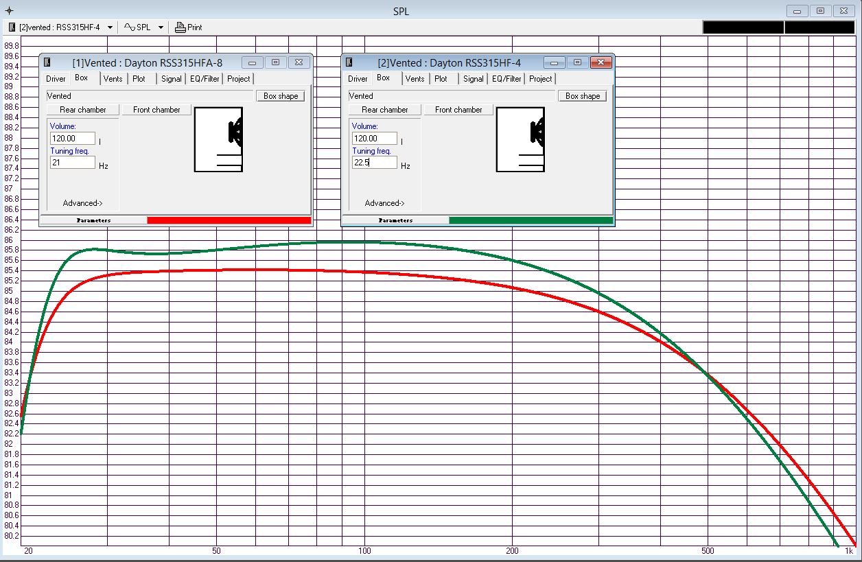

Attached ported 120 liter WinISD plot for 12" Dayton RSS315HFA woofer in 4-ohm and 8-ohm.

For what it's worth, I'm using that dayton 12" hf up to 500hz, and I love it. Measure great too, although I've never done distortion measurements. With a very steep xo though. I have some expensive 10" woofers sitting on the shelf, can't recall the model. They should have been better, but didn't sound nearly as good to my ears. My theory is that the very stiff cone and massive motor are a better match to the aluminum dome compression driver they are crossed to.
