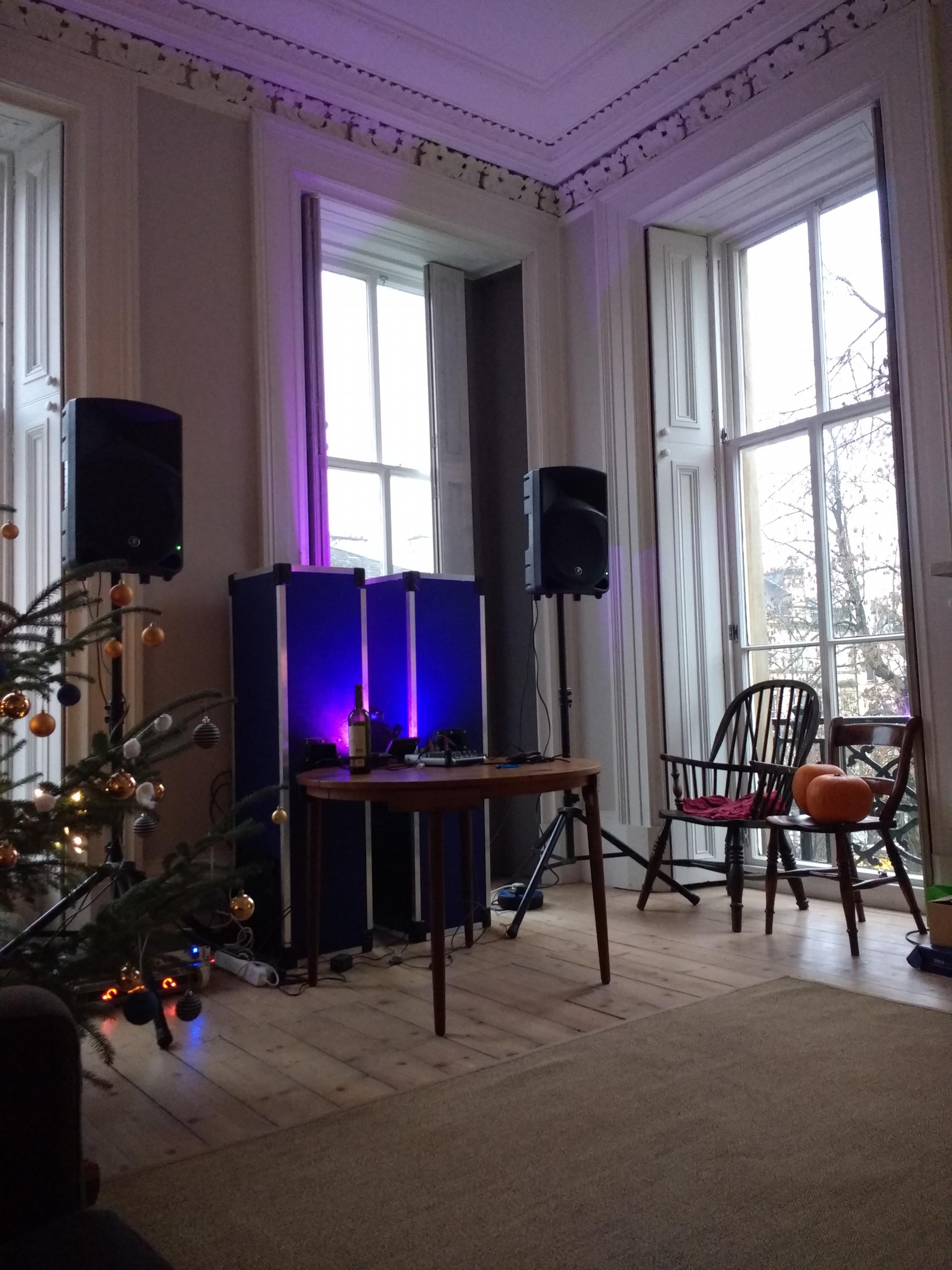

I used 120Hz LR4 the other day with the attached configuration bass was not locatable and no noticeable distortion until hitting the limiters where the bass just got a less loud. Using the same tops without subs they start heavily distorting at the same levels. I would recommend using an active crossover which will be adjustable as you will need to equalise the bass anyway. This system was just using a cheap analogue active two way crossover which has a setting for 75Hz and 120Hz.
2*1.4" compression drivers, 2*12" midbass, 6*15" sub bass
