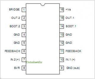

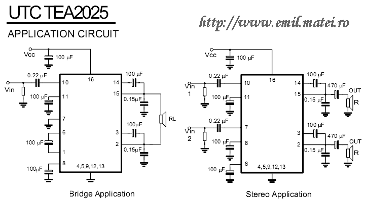

You cant just put the jack on the ic, only wau is to find out wich one of the pins on the Bluetooth are the inputs of the ic, than remove the Bluetooth and solder the jack
Here is the schematic for tea2025, look for the components around your ic s and find oht if they are similar
it might be very difficult to find the mark. but i might be able to make out some other parts of it.

I think it would be more fun soldering some wires and resistors to a 3.5mm cable bridging back to the "aux in" with some insulated wires hot glued in place and soldered.
bypassing the bluetooth module.
If I really felt like it i could just snip all the leads off the bluetooth module completely.
the actual IC chips dont have much static at all. when the bluetooth module is in standby mode and I brush my fingers across the input leads to the IC's. i hear a loud bzuz when my finger hits the input leads but its silent when the bluetooth module is in standby mode. no static from the chip itself. its just coupled poorly with too high of gain from the bluetooth reciever module

The buzzing when only the BT mode is on means that ground isn't referenced to reference ground. Can you input into aux when BT is off?
Yes I can input into aux with bluetooth off.
There is no way to disable bluetooth mode. Its always on whenever the power cable is plugged in just switches its mode to "always on bypass through aux in" which causes the bluetooth module to route the aux in signal THROUGH the bluetooth module before passing into the chip. causing the static.
As far as I can see all grounds are at ground potential. the bluetooth module might be connected with straight wires and no resistors to the IC chip amp. causing too much gain and hissing/fuzz when its active.

no i don't have one but I can emulate one with my PC and an 3.5mm jack plugged into the line-in and a resistor array if I need to.
I could use audacity to record any waveforms input
Try and see if you can. 1khz tone to test perhaps..
Then feed it into the aux and test for where the signal was clean but the next step dirty. Then u know where to bridge the line.
