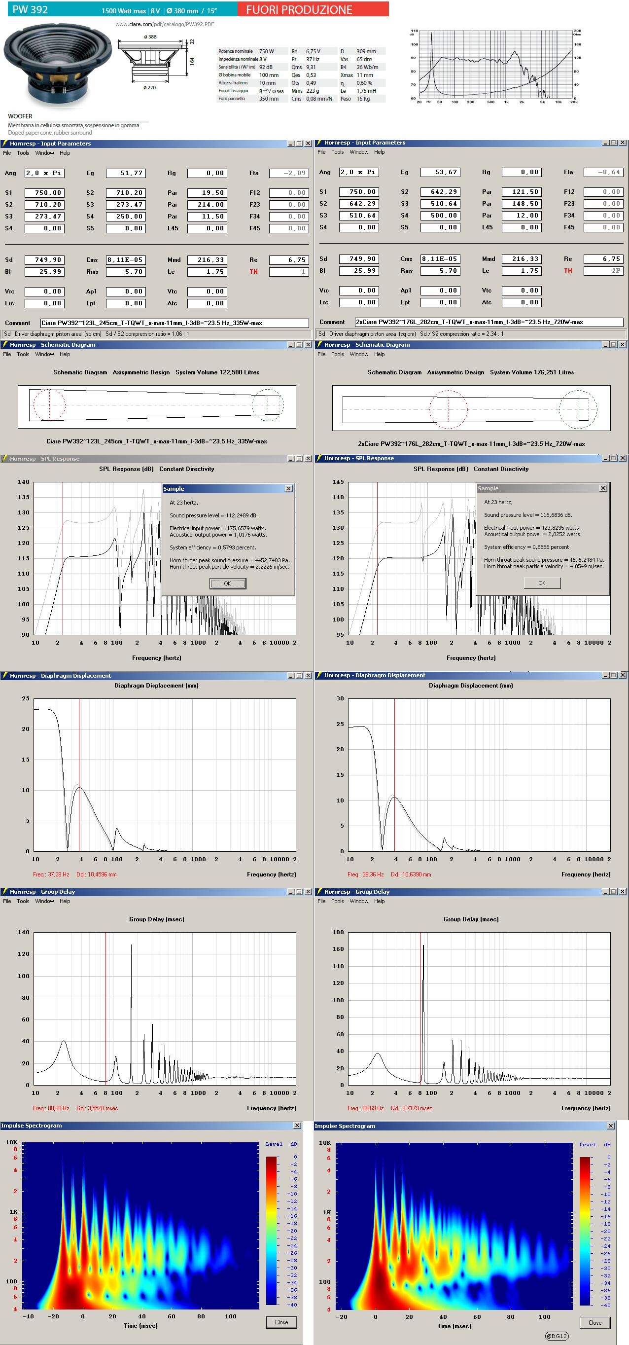

Thank you for your answer! I would a subwoofer with flat response from 20 to 100hz. A powerful subwoofer with a good pressure and deep bass. My shearch, now has restricted to 2 drivers. Monacor SPH-380TC and CIARE PW392 (http://www.ciare.com/pdf/catalogo/PW392.PDF)
I've simulated with winisd pro. For both, i chosed a box of 127 liters tuned to 23,5hz. From my simulations, ciare is better than monacor. What do you think?

But I've simulated the Ciare PW392 driver in T-TQWT's:
b🙂
Hi, i've seen your simulation.. It's great! But one thing isn't clear, the graph of diaphragm displacement, is equal to graph of cone excursion? Sorry but i'm impractical in tapped horn construction..xD
Hi cla89,
In time you'll learn too:The graph of diaphragm displacement is = the graph of cone excursion.
b🙂

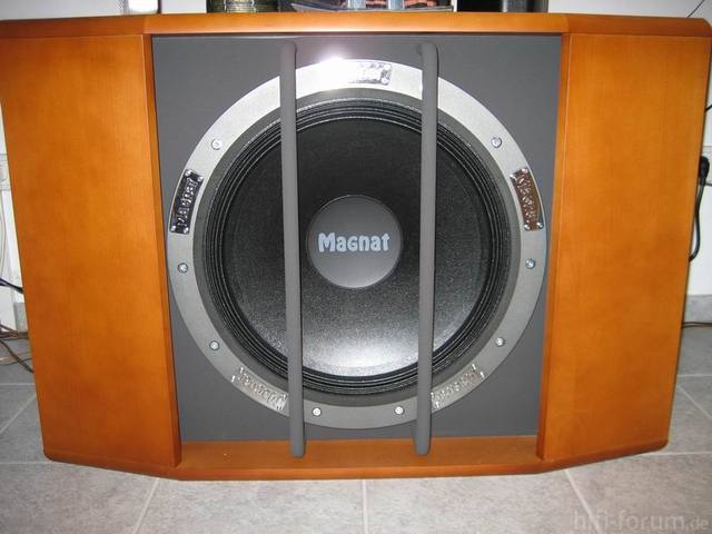

The value for Qms by the SPH-450TC is possibly too low for a clear and tight bass response.
This reminds me at the Qm value of the Magnat Agressor 6000 and 5000, that I have both heard and measured several years ago.
http://www.magnat.de/fileadmin/user_upload/Produkte/BDA139505.pdf
http://www.alt-spb.ru/articles/files/magnat_agressor6000_big.jpg
http://bilder.hifi-forum.de/medium/157418/omega530-001_152366.jpg
http://www.magnat.de/fileadmin/user_upload/Produkte/BDA142401_EN.pdf
http://www.youtube.com/watch?v=uzSfvtglkfM
Very bad for me in all respects (except SPL).

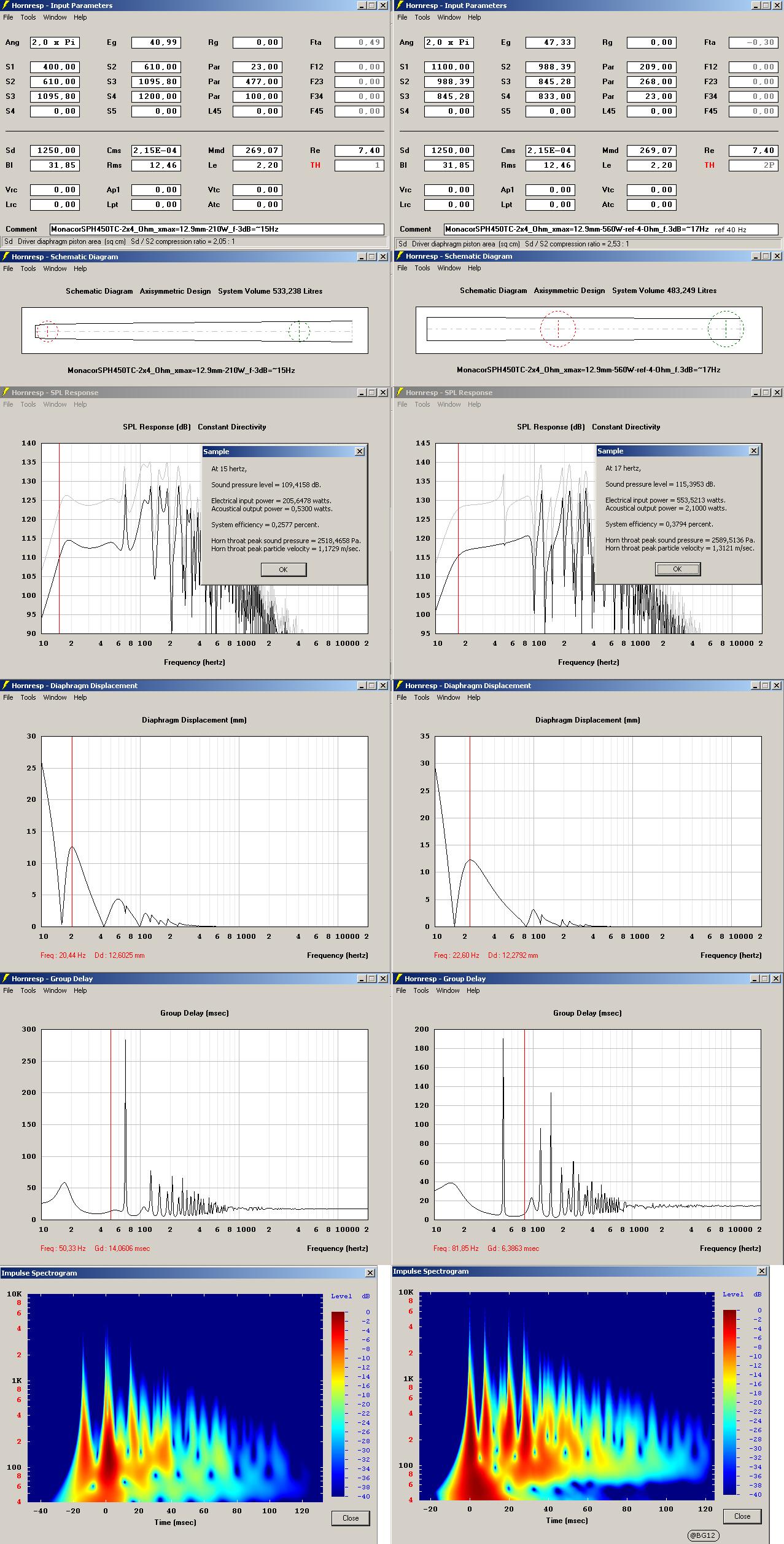

b🙂

Submitting a simulation with the Monacor: Stage-Line_SPH-450TC drivers.
b 🙂
