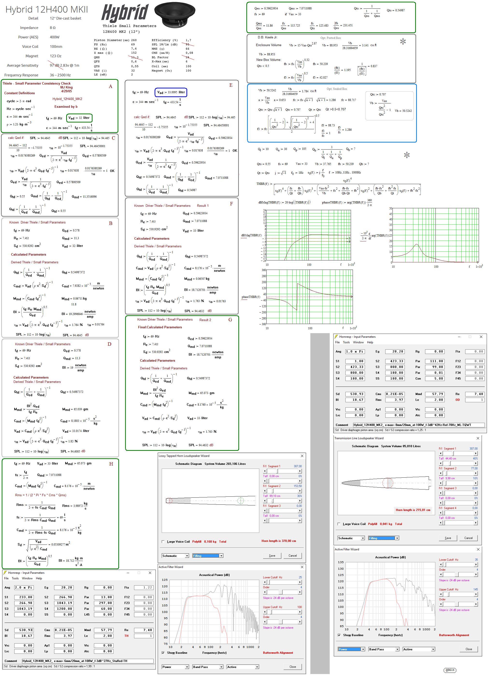

Hi Mrcloc,
😱 Changing the prescription of the Sub(performance) again????
See my simple calculations/plots of your first second suggested Sub:
I expect no comments again as for my first Posted Picture 🙁

Hi bjorno. I didn't overlook the first analysis you posted, I certainly had a good look at it, thanks! 🙂 The sub that I proposed was one that was sort of in my budget, and available. It was a point of discussion as a point of reference. I was told it wasn't good for my purpose, and the subs I'm going to use I have owned for long, so I don't need to buy anything else.
Thank you for the detailed analysis! I so appreciate it, and I'm going to study it at length! I like the results... 🙂 At the moment I'm going to build my 68L box and mount the two isobaric to see what they can do. There is no harm in this, because I can simply add on the extra 68L chamber at a later stage. The filtering and amplifier will stay the same. And I believe I may convince my wife that the size is necessary. 😉
The filter design you have there is great, thank you! It will be more suitable than my 2nd order design I proposed earlier.
You seem to enjoy creating thunderous bass... I'll update the thread on my progress.

bjorno, I've read your entire analysis. What you've done there is pretty much exactly what I've had in mind. I'm doing it slightly differently. I don't need to calm the peak at Fb (Fo). In 65L (min), the peak is outside my bandwidth. I will be designing my filter a bit differently. But what I'm doing is pretty close to what you have shown, and you've really helped me, so thank you!
I just want to add that I'm changing the filter ever so slightly - 4.7uF for C4, because I have it, and I can't easily make 6.6uF from the components I have. 4.7uF widens the band slightly and move the peak about 2Hz higher.
I also added a mixer amp on Vin, consisting of a summing amplifier with 22uF and 1kOhm input for each channel, and 1kOhm feedback, and the output goes through a 10k pot to this filter. I also changed R6 for a 27kOhm for a little extra gain.
