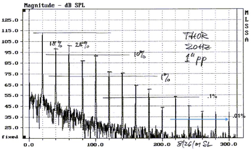

Acoustic foam still has an effect at lower frequencies. For example, Sonic Barrier has an absorption coefficient of 0.1 at 125Hz. At 500Hz it is anywhere from 0.2 to 0.7. It only goes up from there. Linkwitz measured significant harmonics from a "good" subwoofer up to at least 300Hz. Woofer measurements

btw, What was the amplitude of the harmonics at 300Hz?
