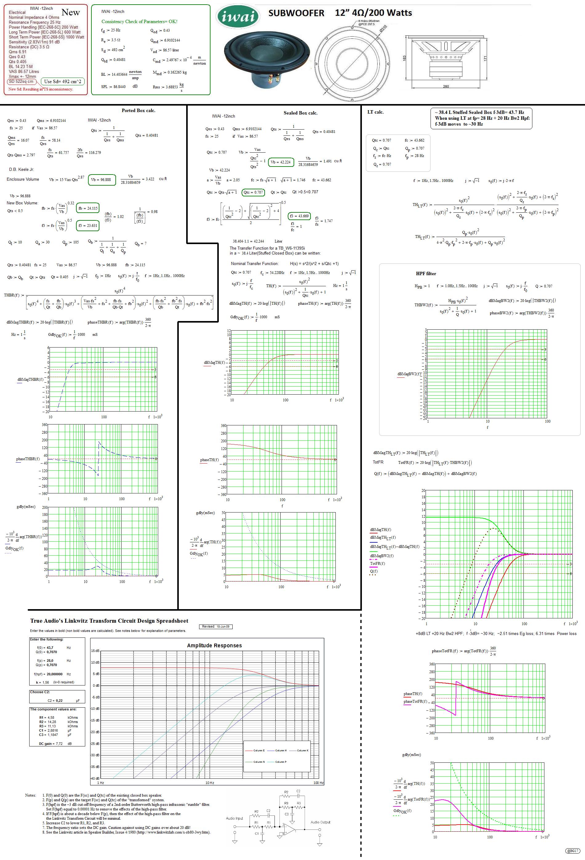

I agree with snappyTurtle. Also the IWAI has higher BL, so a stronger motor. (both are not spectacular woofers). I think it's hard to get Dayton in India like the LS12-44, RSS315HO-44 or UM12-22. But there are some car subwoofer brands like Pyle, Lanzar, Pioneer etc that can be a good alternative for building high power home subs that go low with higher xmax and BL.

I dont quite understand all that you have shown , in the attached image as i am a novice .. from what i could understand is
Ported Box Vb - 96.888L
Sealed Box vb - 42.224L
I arrived at very similar number using winisd alpha , but the port velocity goes very high >20m/sec , using two 3.5inch port of approximately 16inch length ..

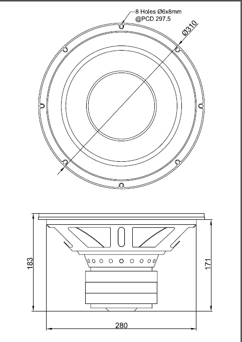

Attached winisd alpha file .. and the subwoofers mechanical diagram ...
Regards

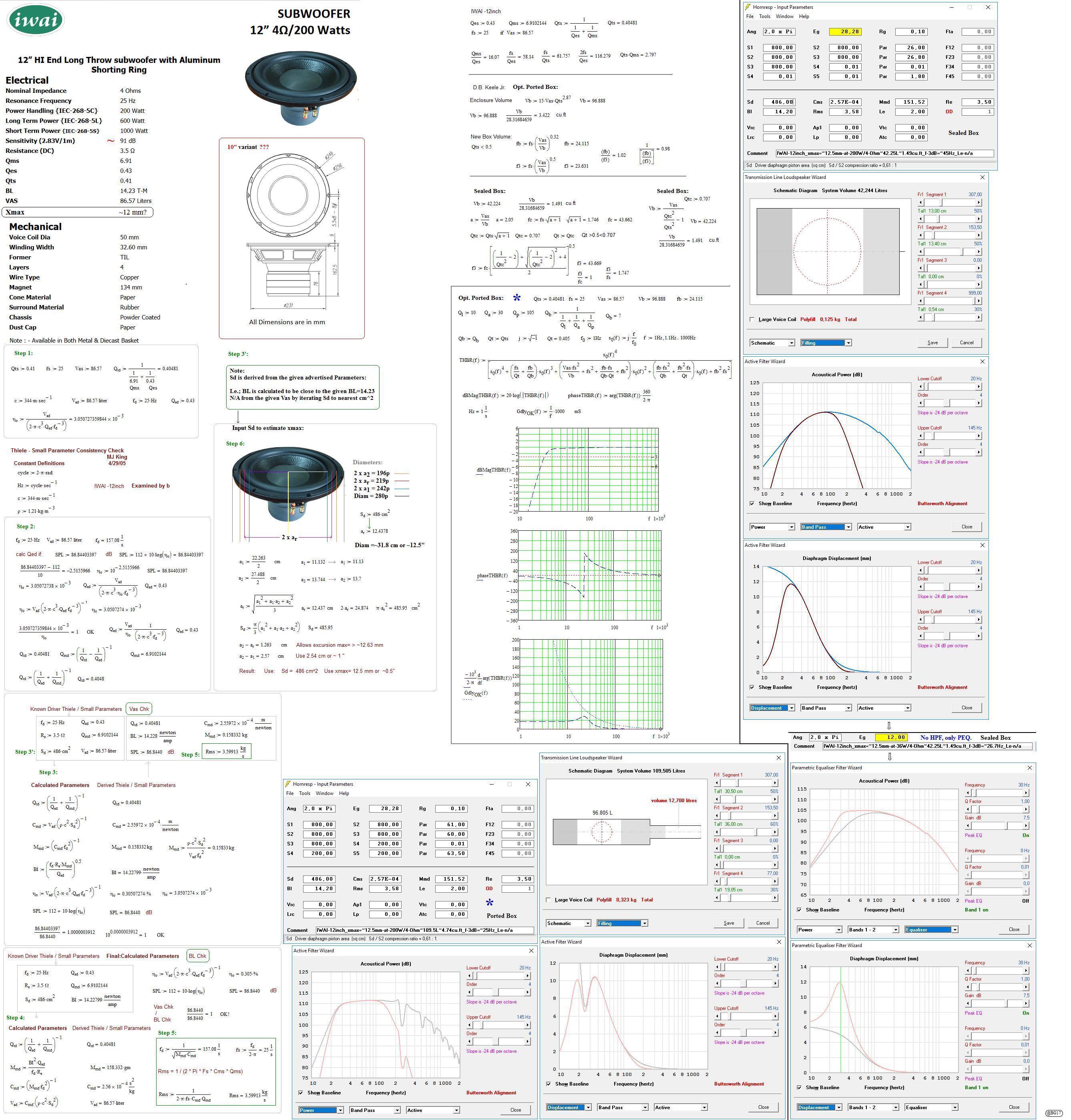

thanks for the pointers , but I have ordered the iwai subs ,now the problem arises with simulation In WINISD alpha it say for chevyshev alingment it gives a box volume of 92.53L with tuning frequency of 24.29hz and at f3 ~ at 23.8hz . with this kind of a box size i am getting port dimensions as 2 X 3.5inch X 24.23inch with a max port velocity of 20m/sec at 20hz with 1st port resonance at 279.22hz.
this same speaker when modelled in bass box pro 6 gives very different results box volume of 74.81L and FB at 23.16hz and f3 at 23.77hz and port dimensions are 2x3.5inch x 34 inch and max port velocity at 19m/sec at 14hz with 200w of power and has a +6db bump at 40hz in the amplitude response graph ??
why are the 2 software modelling the box differently...

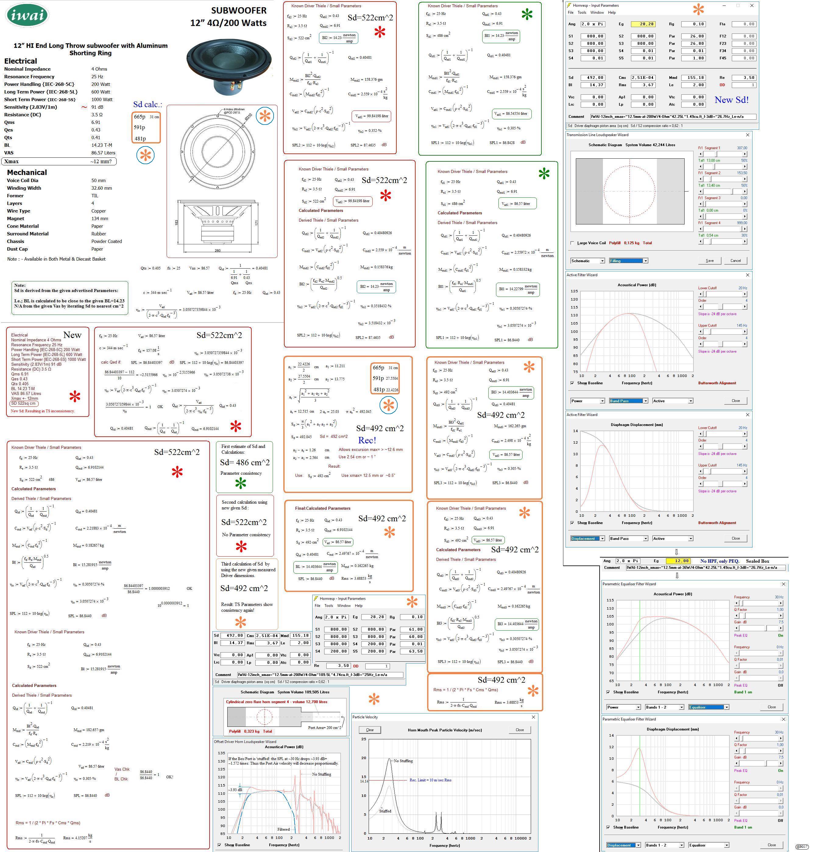

Hi phoenix87,
You're correct about the calculated Box Volumes.
I don't use WinISD and never will..
FYI:New Calculations revealing the new value of Sd=522cm^2 will result in 'inconsistency ' when checking against the other submitted Parameters.

Thank you for helping again , So the box volume with the SD of 492 sqcm comes to 96.888L and the port dimensions as i back calculated from the port area of 200sq cm and volume of 12.7L as mentioned in the files you attached comes to Port Diameter - 16cm and length - 60.96cm ... is this correct ?
So if i keep the volume i.e 12.7L constant and change my port diameter based on the pipes locally available to me it should work ??
