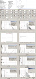

Hi Ted,
I vote for ported boxes if the low frequency cut-off is acceptable, but there are other options too:
b 🙂

Thanks for the reply.Could you send me a larger copy of the drivers measurments.And if possible could you give me an idea as to what would be the best size enclosure for these drivers I will go with two single 10" front firing front port vented enclosures for these drivers if thats what your measurements are saying.I wasnt sure as to go with sealed or ported.I have the room for two 50ltr boxes but would like to keep the hieght of the boxes under 500mm.They will be passive boxes of course.I only have Boxnotes and the program is telling me the best size enclosure at 50ltr is 490D x 490H x 326W.The port vent is 75mm X 490mm and is too long for the box.Does your measurments give you the best size enclosure for this drivers specs.I have tried to seach around for specs for these drivers to see if other people have used them but come up with diffrent quoted enclosure sizes and recommendation.This is my first speaker build and I want to get it right the first time.

Hi Cal,
Thanks for the tip.I tried saving the thumbnail and blowing it up didnt work.
Ok I have had a look at the measurements and to be honest Im little lost.Could someone be so kind as to let me know if I have worked this out right.
The graphs on the left I gather is for a ported enclosure, the right looks like a tube of some decription.The vented box at 50ltrs graph on the left shows the frequency will go down to 15hz at 0db and will climb to a frequency of 40Hz with a db of 105.Flatening off and maintaining around 105 db to round 200hz then fading off till reaching around 400hz .
I guess the cone diagram is suppose to represent a sealed enclosure.The sealed enclosure looks like it will start at 14hz with a 0 db and climb to 24hz at 98db then flattens off to 100hz at 102 db and then the sound drops off a cliff ie a cutoff.
My thinking is I would be best to go with a ported enclosure as recommended by Bjorno thanks bjorno, and adjust my crossover on the NHT SA2 mono amp to around 100hz.
