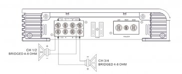

And this is what i mean by wiring it bridged
my amp has the four outputs on top of each other but its wired the same way as in this picture (where it says mono mine says bridged)
that is not bridging
repeat with me:
THAT-IS-NOT-BRIDGING
Bridging means connecting from + to + or RED to RED
You are connecting from RED to BLACK which is common ground, so it´s irrelevant whether you use the Left Black or the Right Black.

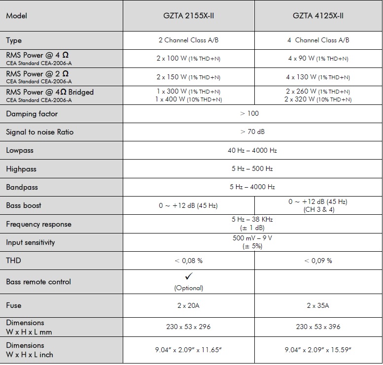

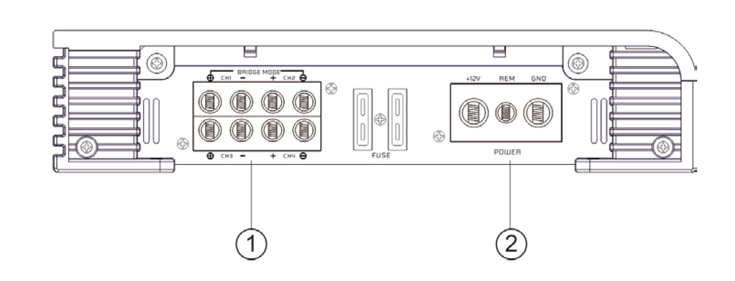

I am at loss. So how do you call it? First of all I assume he is using car amplifier and this whole thread is not about home audio. Most of the car amplifier manuals call it bridge mode (see attachments).
@JMFahey
maybe it is correct type of bridging, internal construction of car amplifier enables that type of connection. In early '90s I have seen lot of car amplifiers which enables connection of the subwoofer with passive filter to the one pair of stereo speakers (for example if you use it for rear and front combination).
He have to check that - connection point is not on the GND (in that case + connection is grounded of the one stereo channel ), user manual will reveal type of connection if he is uncertain, or doesn't know how to check.
Sometimes, amp manufacturers will run alternate channels out of phase. ie,
Ch1+ = signal
Ch1- = ground
Ch2+ = ground
Ch2- = (inverted) signal
A small number of amplifiers do this, but it certainly isn't unheard of.
In that case, bridged output would be between Ch1+ and Ch2-.
Chris

No it´s not.
Read it again, including your own:
Ch1+ = signal
Ch1- = ground
Ch2+ = ground <---- mislabelled as + , actual ground
<---- mislabelled as ground , actual +
Please read this carefully until it clicks:
When you invert amp phase, now + becomes - and - becomes +
So when you are connecting from Channel 1 "+" to Channel 2 so called "-" you are actually connecting to Channel 2 "+"
Which by the way is what is required by theory.
That cheesy Car Audio manufacturers omit mentioning that and mislabel output terminals is irrelevant.
