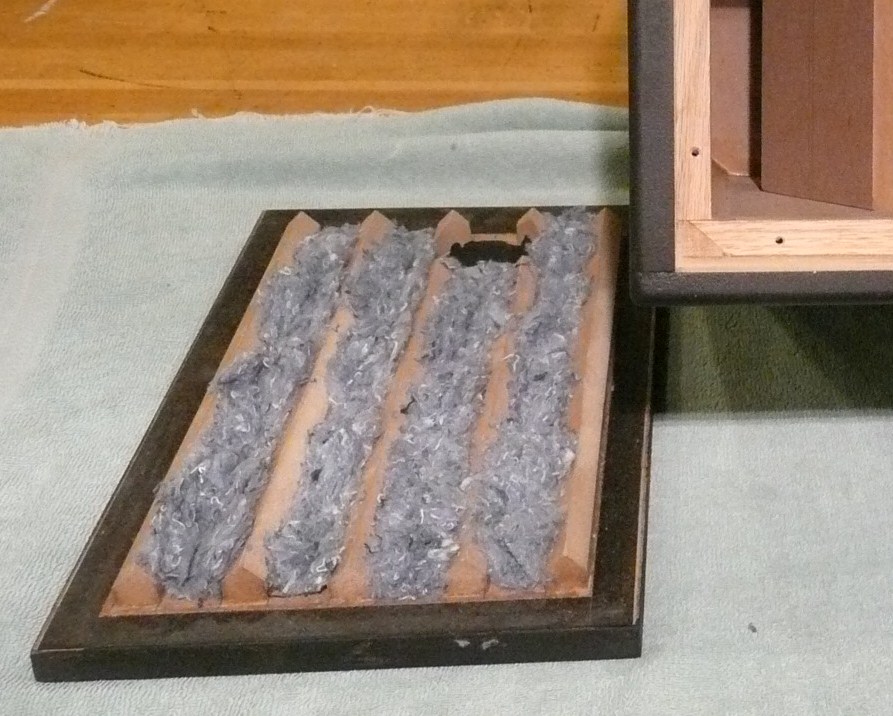

Gasketing - Splicing Tape
They sell a thick rubber tape at electrical supply stores, often called “bug tape”, it is used for field splices (then they wrap with standard tape). It doesn’t turn well, but it was fine for a 12” woofer.
I used the same tape (just over a 1mm thick) for a removable back the other day, it worked very well.
