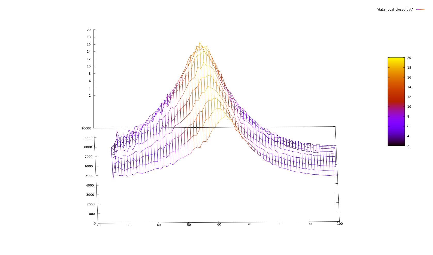

Two more view from the same graph, maybe it's more simple to see.

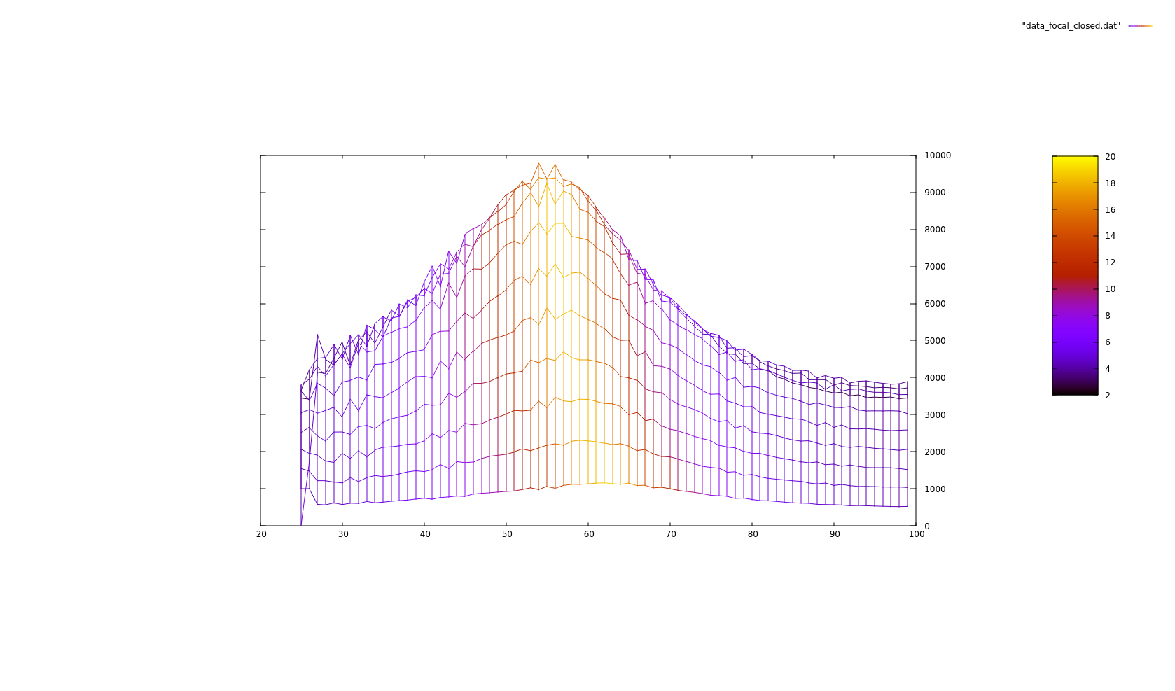

On the second one you can see how the amplifier was struggling to provide the current (it doesn't affect the measure though, I just measured the behaviour of the speaker).

What was the resistor value? Assuming the resistor was tiny from what you said and the roughness of the plots, these results don't surprise me:with 1000mV, fs is about 60Hz.
With 8000mV, fs is 55Hz (theoretical value is 51.6Hz)
- 8V across the speaker is no way small signal. It is out of the bounds of the theory. That's why LEAP developed large signal models for simulation, and why Klippel measures nonlinear parameters.
- Even 1V is maybe not "small signal"
- Fs will change with drive level. If I recall correctly, Dick Small's original thesis actually has a section about that. Offhand I might have expected it to go up and for instance the spider stretches harder, but there can be other electromechanical effects (air trapped under the dust cap...though seems that would make resonance increase as well...)
- And yes, Thiele/Small/Benson's equating of physical parameters into filter theory is just a 1st level approximation. A quite good one for normal listening levels, but goes awry at higher levels. Rather like Newton versus Einstein.

It was a 10 ohm resistor, but it doesn't affect anything as it is just used to measure the current.
If the speaker was diverging from theory more and more as I push the volume I wouldn't be surprised. What really trouble me here is that at small signal I am way off the T&S parameters given by the manufacturer. I need a significantly higher signal to find the theoretical values.
I see two possible explanation :
1) my speaker is faulty somehow
2) the manufacturer measured the T&S parameters at a rather high voltage, and the speaker isn't very linear with small extrusions.
