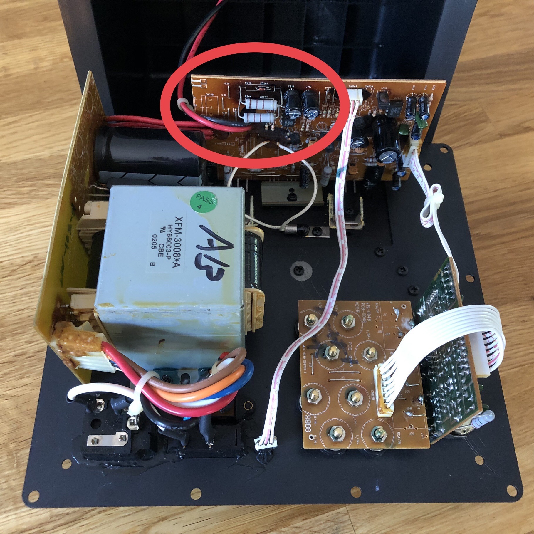

I need advice on a fried subwoofer that a friend gave me. It is a Cerwin Vega! HTS10A.
I noticed that the 2A fuse in the power plug was blown, so I bought 10. They immediately blow upon turning the sub on.
So I pulled out the plate amp to inspect the PCBs. The speaker pops, good.
I inspected the amp PCB and noticed an overheated area near where the speaker wires are soldered. There are to large resistances and two zener diodes at the heart of the toasted zone. Bingo!
So here are my questions:
  • The zeners or the large resistors?
  • if the zeners, how do I determine their type or voltage?
  • What wattage of resistors?
  • I really appreciate any feedback that can allow me to repair this. Thank you.

Unfortunately, that model appears to be quite different near the output. There is only one zener diode. On mine, there are two, with large (5W) resistors.
I will reach out to Cerwin Vega!, though I do not expect support on such an old model.

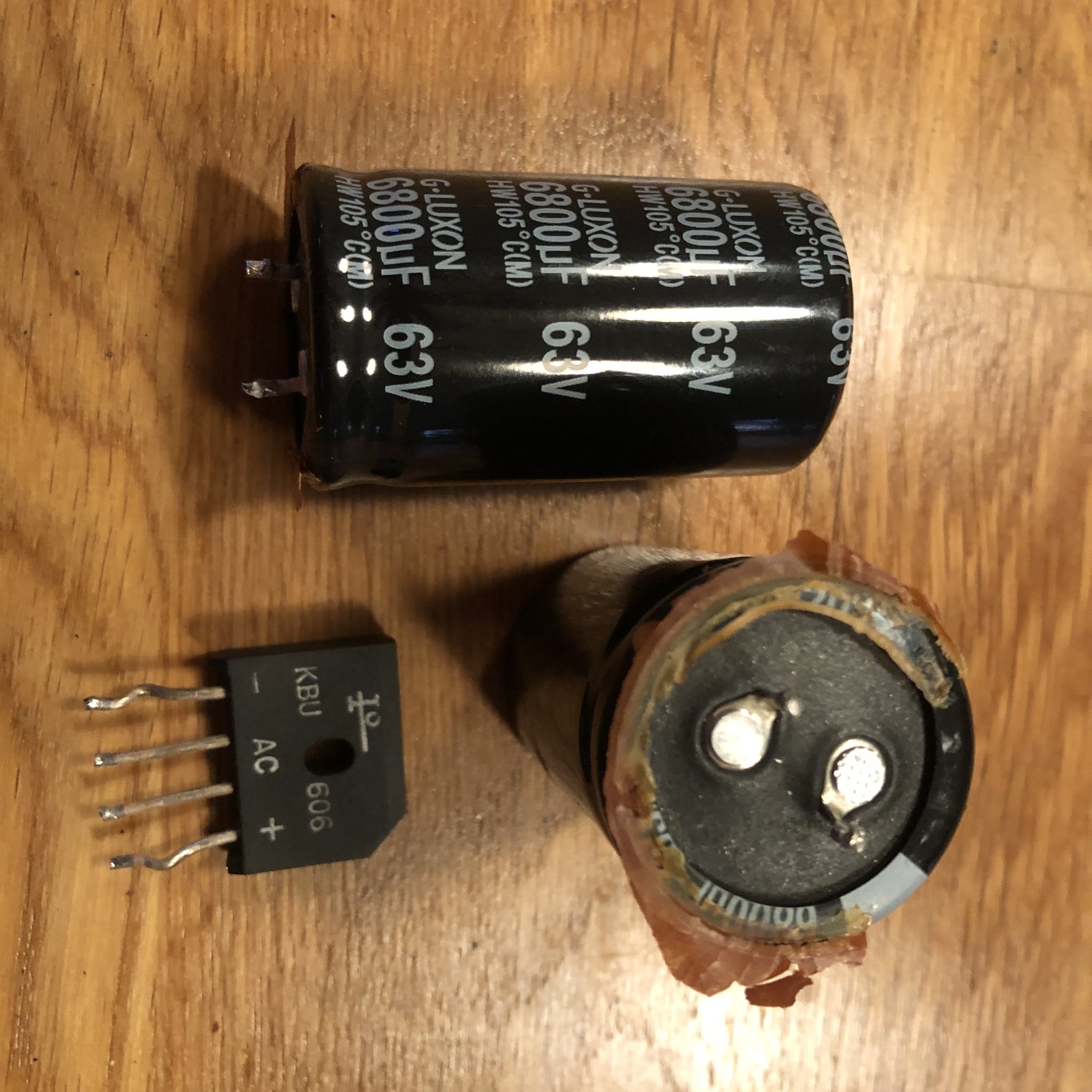

I unsoldered the 3 leads of the power supply and powered up with a new fuse. It blew. PSU problem.
The power supply board looks simple: a transformer (9 pin, most likely OEM), two 6800uF 63v caps, what looks like a bridge rectifier and a rectangular yellow component (a large 11K resistor?).
The problem may also be on the AC interface (110v socket, voltage selector, on/off).
The toasted area on the amp PCB indicates that the amp was driven too hard and the PCB browned from radiant heat from the resistors. Could have happened over time… Most likely OK, the PSU failing first.
What component in your opinion would be most suspect on a PSU? A shorted out bridge rectifier? The electrolytic caps? Hopefully not the transformer :-(
Please advise. Much appreciated.
RESOLVED !
(I think…)

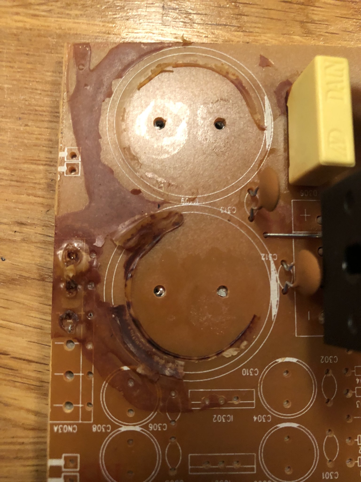

I desoldered the bridge rectifier first and tested it. PASS!
Next, I desoldered the caps to test them. They appear to have leaked! No need testing them, pretty obvious. The inside shakes around. Yup, toasted dry.
BINGO !
This is a great forum. Thanks for the advice. I think this baby is salvaged ;-)
