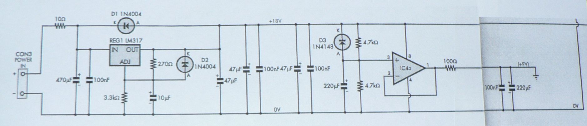

I did find another circuit which does away with split rails. It uses a 24VDC to power a Class D amp and an active filter circuit (supplies 18VDC, 0V to pins 8,4). For my use I would go 19VDC to 15VDC,0V to the op amps. Instead of the LM317 I'd just use a 7815 to keep it simple.

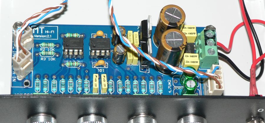

If you have a tone control board with on board regulators and rectifiers, then you can use a 12VAC wall wart for 12V regs (16VAC for 15V regs).
Only 2 wires (red + black) required for power in and gives a full wave voltage doubler type and the one in the pic uses 12VAC through recifier and 7812 + 7912 to give ±12VDC rails.
