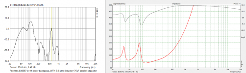

Hello,this thread because of my last buildin, which is the insertion of a little 4th order bandpass sub in an existing cabinet after changing old woofer with a semi-pro mid woofer.
Sub consists of a Peerless 830667, rear chamber is about 14 litres, front chamber about 16 tuned at 50 Hz through an about 7x18 cm port downward-firing against floor, 2 cm far to increase effective tube lenght.
I've choosen this loading type because of difficulty to filter any other system else through only electronic passive method.
So let's came to my problem: listening it something is wrong, a vague taste of metallic closed box, so I make some measurement. Well, the truth is staggering, the reflex of sub fires a first resonance peak at about 580 Hz, and another at about 950 Hz (which I can not explain as I know should be to double the frequency of the other ..) to do horrified! Here the measurements of only sub:

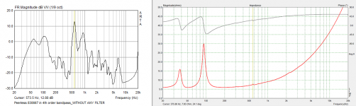

1) without any filter:

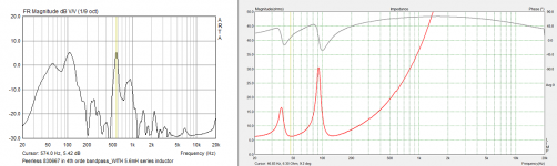

2) with inserted in series to an inductance 5.6 mH:
3) since even with inductor peaks are scary I tried before to put after it a parallel 75 uF, it goes better but the impedance module has dropped close to 3 ohms, and it inflates the lowpass corner around 100 Hz, already inflated by the inductance at critical level:
4) so I do a last attempt by inserting after the inductance a LC resonant cell tuned to the first resonant peak with a rather large Q (o.82mH + 108uF), so peaks has all disappeared, but impedance module went definitively away, even in the low part of the response, and this to me is incomprehensible:
What a disaster! Let's go to the conclusions, it remains only one way: may the reflex tube be replaced by a passive radiator? The latter should not be affected by the problem of the secondary resonance peaks, or not?
