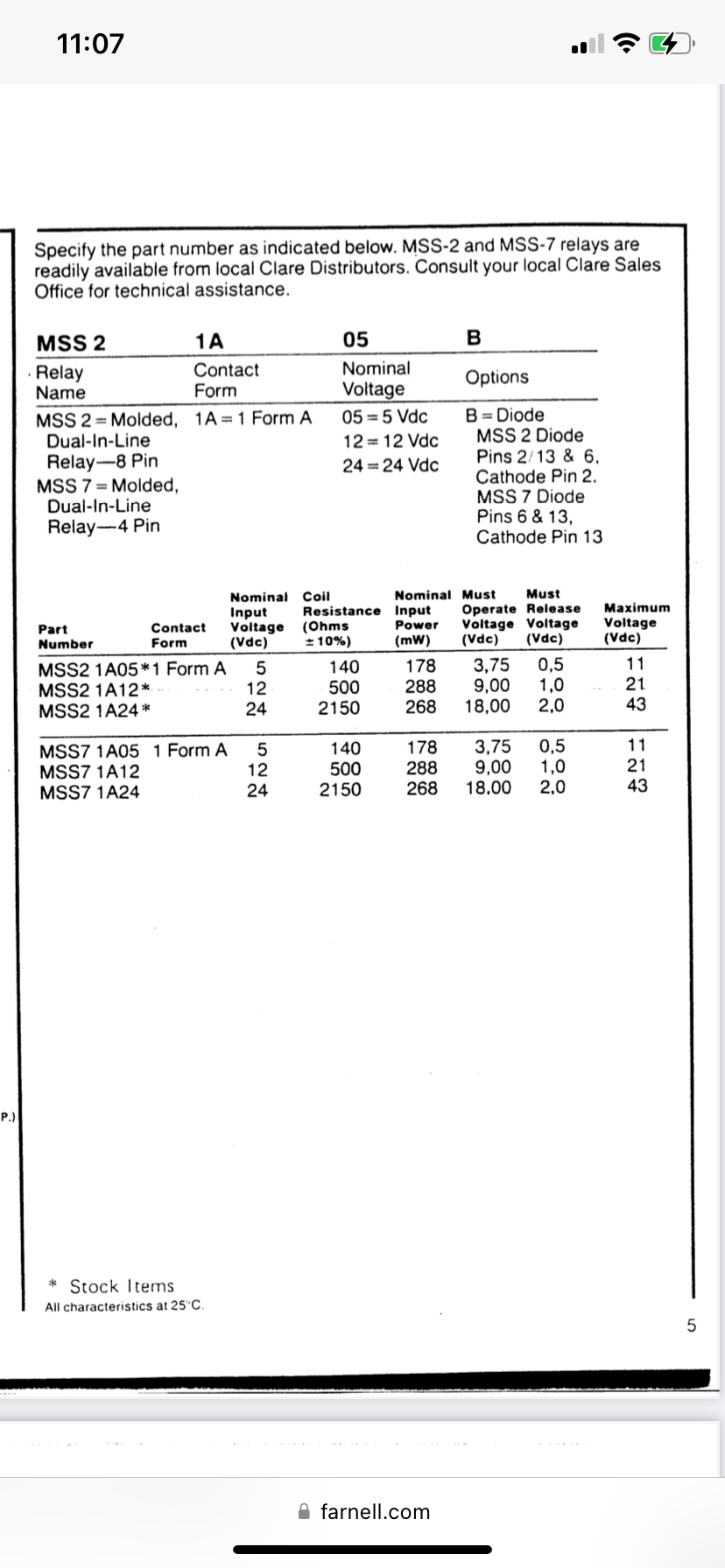

Substitute for an 8 pin reed relay MSS2-1A05

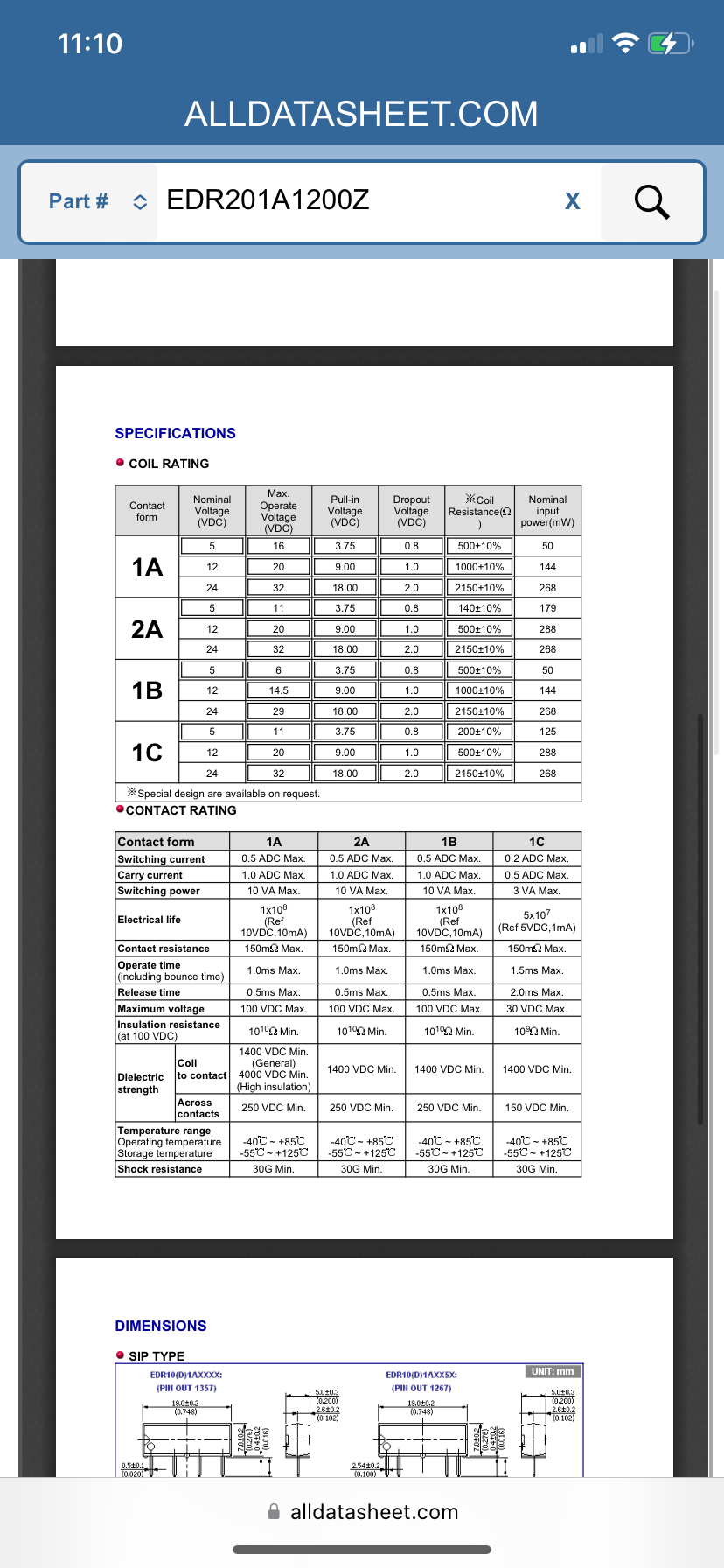

I need to replace a bunch of MSS2-1A05 reed relays in a pre amp. Would this relay be suitable EDR201A1 5V. The coil resistance is much higher 500ohm vs 140ohm and the input power is much lower 50mw vs 178mw

Coil should be ok, a higher resistance coil is likely not a problem, especially with the high 16V max coil voltage spec on the EDR. Did not see contact specs on the EDR or the pinout on either. Pinout & footprint will need to match. They do not spec the contact material, gold flash is nice for signal level relays and it may have it, just can't tell from info on the attachment. The 150mohm spec is also not great. 50 is pretty common on a relay, maybe reed's are higher don't know.
