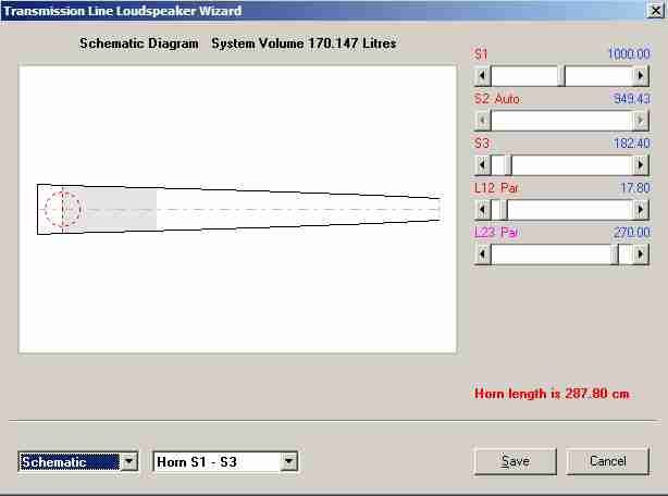

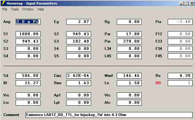

Hi lejockey,
Just sitting here on the side lines recuperating from an operation, and saw your thread, anyway, I still don't know what you really want to do, but:

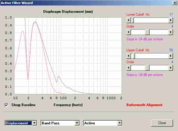

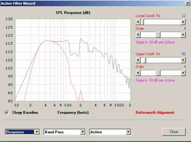

If you are wanting to fill in below the ATC SCM50's -6dB point of 38Hz (79dB?) maybe a transmission line might work for you. I have played around w/ the driver suggested by sreten in Post #8 in Hornresp quite a bit (obviously, sreten's solution would work).
Here is a tapered transmission line (TTL) that would provide you with below 38Hz extension. The mouth is set to the equivalent of a 6"Dia. duct, I pushed the fb down to the bottom of the usage range to reduce bottom end displacement (but this is just a suggested starting point). You can fiddle around w/ this in Hornresp to push the response to a higher frequency, and reduce the volume. A little damping material is added in Hornresp (it may simulate the internal losses). It's a very simple build if you go w/ the single fold method, and should still be portable.
One box should do it per SCM50, want more SPL use more boxes. 🙂 Inexpensive driver, easy build....

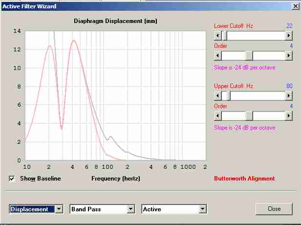

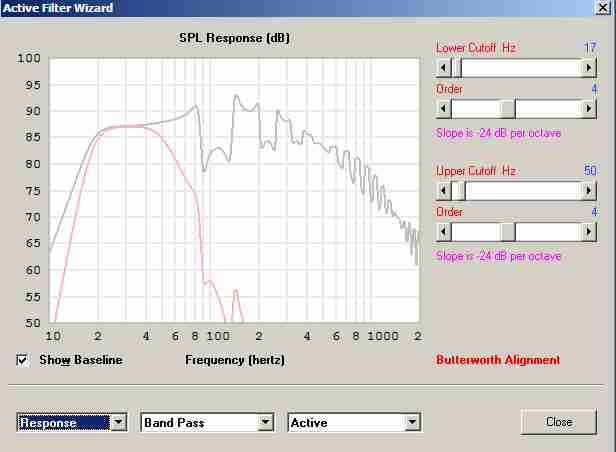

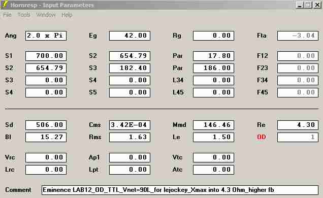

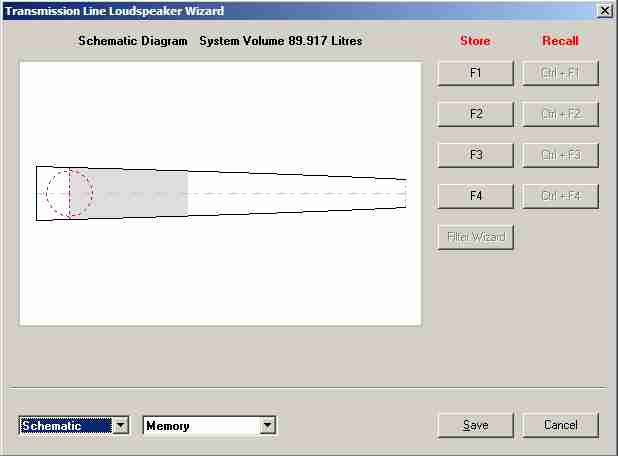

Hi again,
To add to Post #27, here is a much smaller version (Vnet=90L v. 170L), one of these should be able to keep up w/ 2 of your SCM50s:
