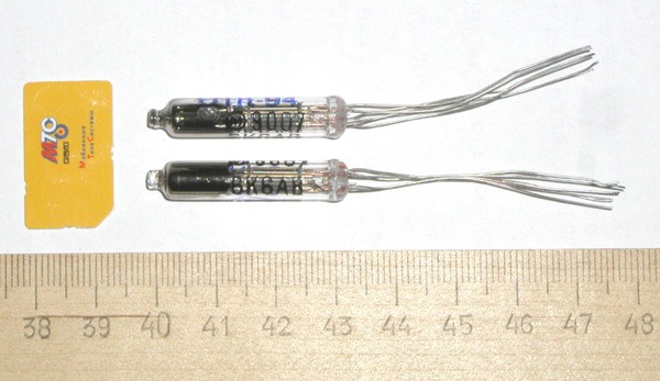

Subminiature tubes/valves for Hi-FI

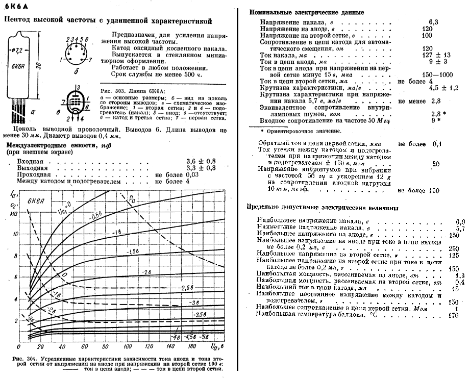

6K6AV (6КАВ Cyrillic)
Great sound in RIAA preamp.
Reactions: pcardoso73

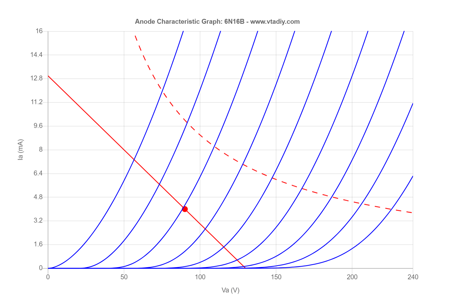

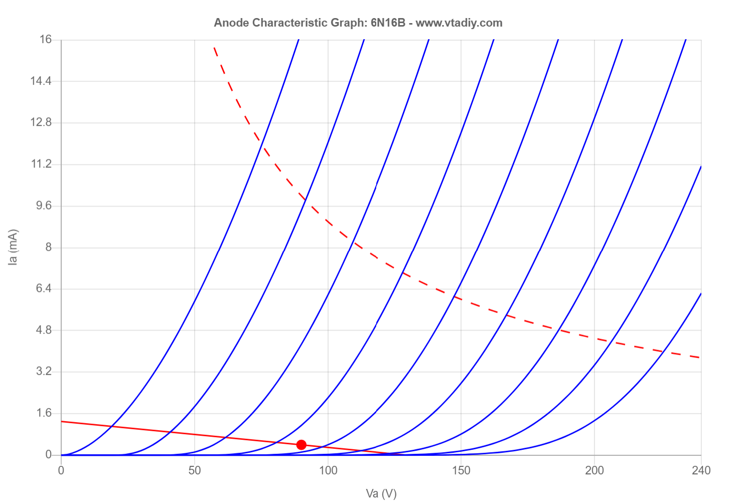

Let's take the 6N16B, for example. Which one would be best for hifi, loadline 1(top) or 2(bottom)? To me 1 should be better and 2, as it has more gain, would be more prone to distortion. Do you agree with this?
@pcardoso73
My personal answer is, whatever you like. 🙂
Some people like to go for the lowest distortion possible and bias accordingly.
For me personally, that doesn't make a lot of sense in tube amplifiers, because you want to hear the tube sound.
Also, it kinda depends on the use case as well. Sometimes you need that specific kind of gain or whatever.
But yes, bias can have a big effect on that. I don't know exactly Mullards use case, but I have also seen certain circuits that I have found peculiar.
When very low signals are being used, it's also less likely that you will hear that distortion, since you're far away from "clipping".
So it's hard to say what is "better".
In your example, the second curve will clip much quicker and more uneven.
Not a problem with a small signal input (like a record player). But you will get a bit more gain.
