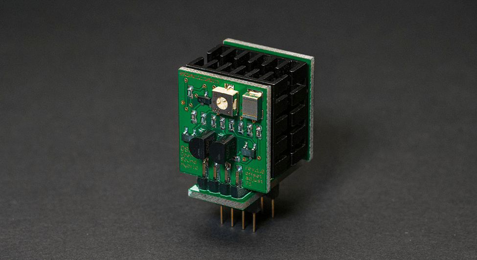

Staccato Audio has been building op-amps since 2017 and the current form is a hybrid Class A op-amp using the BC560 transistor. In the production process for their “Open Sound Hybrid” (OSH) op-amp, the company uses matching input 2SK209 JFETs transistors from the batch of 1000psc, and adjusts the output current to keep the same load for all three output pairs of 2SK2145. Staccato Audio's manufacturing of high-performance discrete op-amps in Poland is led by engineers Jakub Honkisz, who is the founder and project manager, and Morten Oksbierg, who designs the analog circuits. They also make class A amplifiers.

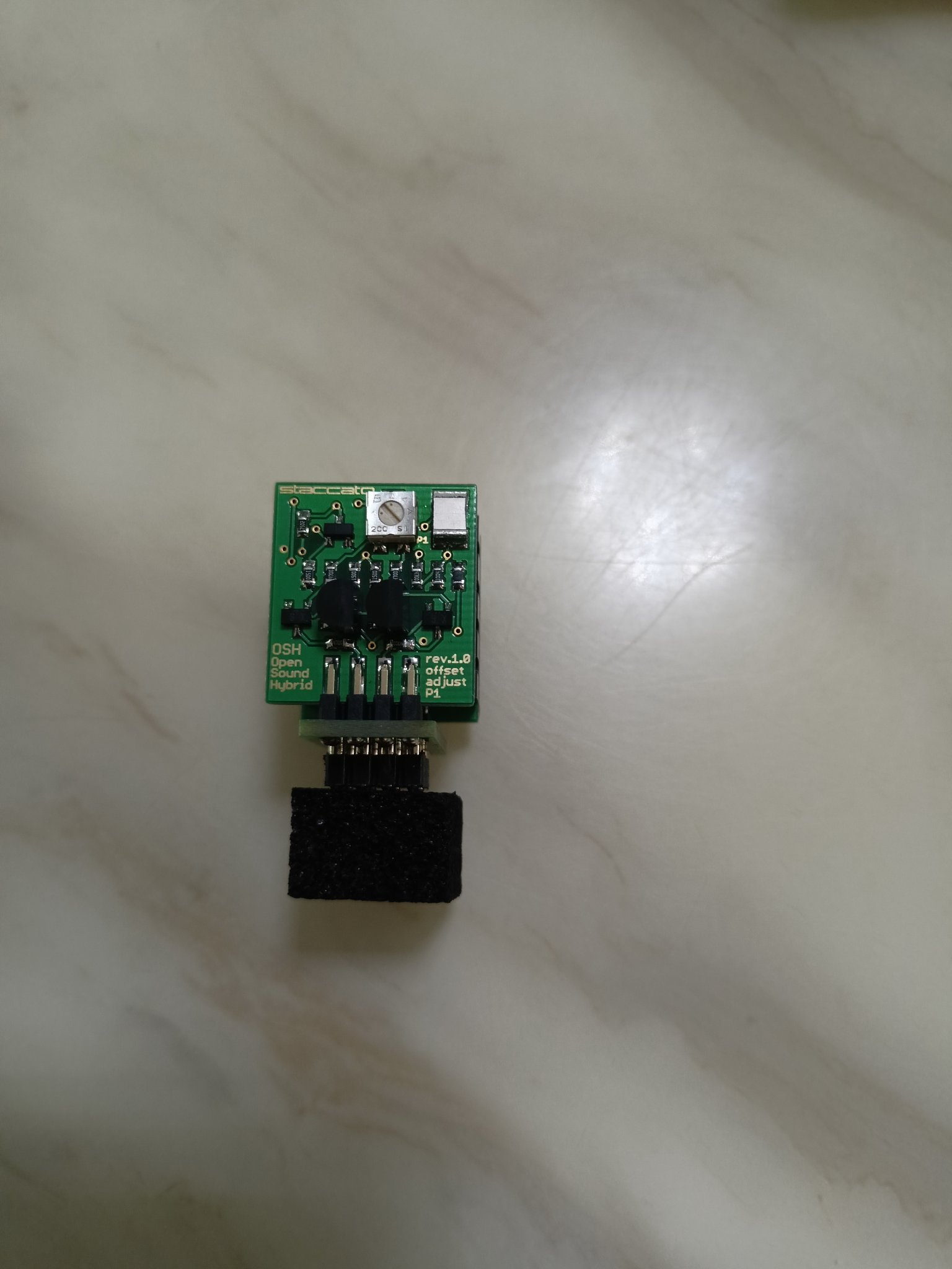

Jakub Honkisz sent 3 OSH-DHb Dual discrete horizontal op-amps for this review. Staccato Audio op-amps makes use of J-FET, in both the input and output stages in combination with a high bias current with low open loop distortion with domination of 2nd order harmonics. The source follower at the output uses an active current source which allows higher output current than the bias current. The highest output Current is ±30mA. Two voltage ranges are listed as the op-amps can be driven to 18V if cooling is sufficient but will need to be dropped back to a maximum of 15V in applications where tight fits and lack of air movement leads too much heat. With class A bias, crossover distortion is decreased in the staccato op-amps. Total Harmonic Distortion is listed in the data sheet as 0.0002.
In contrast, Burson V6 classic has Total Harmonic Distortion of .02 and is not class A. In a previous review, I found the Burson V6 classics to be superior in a subjective listening test to the Burson V5 and OPA627.

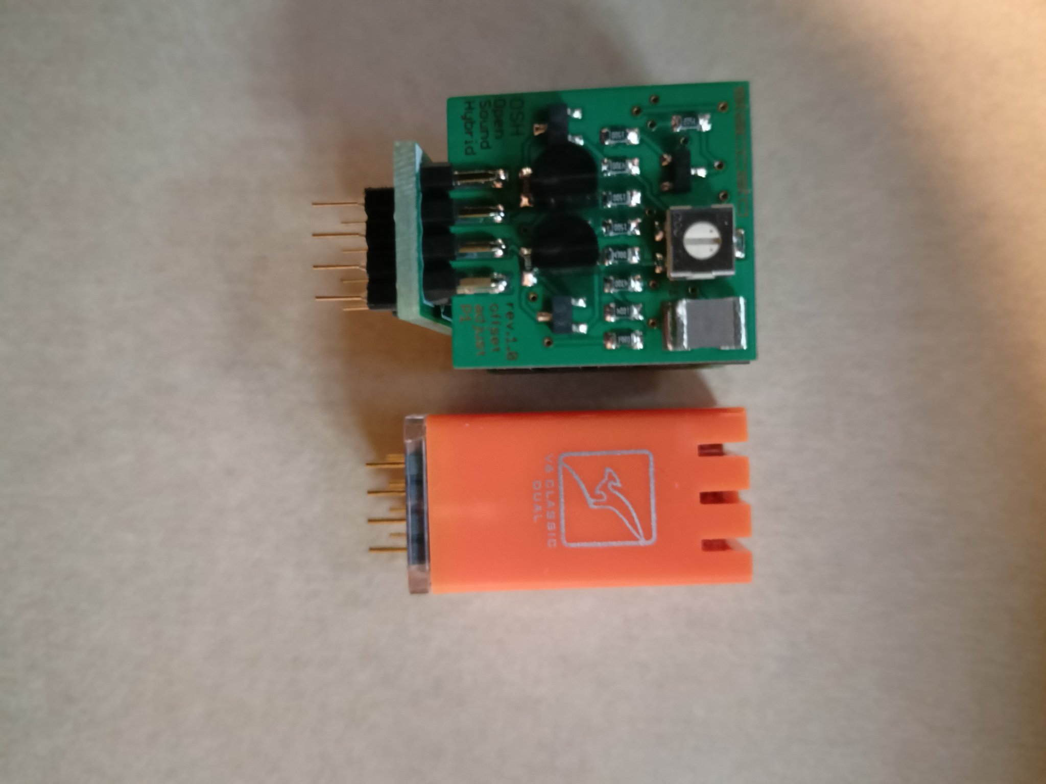

The Staccato Op-amps stand about 1.25 inches high (not counting pins) and are roughly 1 inch on the side and 3/8 inches thick. I was sent three OSH-DHb Dual discrete horizontal op-amps shown below:
The Staccato op-amp packaging was good with all 3 op-amps I received in a sturdy box with 3 small boxes in it containing a bag with the op-amp. The legs of the op-amps were secured with foam to prevent bending during shipment. The product arrived from Poland.
Packaging and comparison of Burson V6 Classic and Staccato Audio Op-amp size

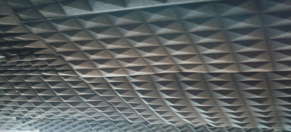

My dedicated room, specifically built for music, has highly acoustically treated ceiling, walls and corners and a straight equalization curve along the x axis, according to Room EQ Wizard, without any equalization required in the JRiver. To achieve this on axis equalization with only treatment took years of work installing the proper arrangement and rearrangement of bass traps and acoustic tiles.
Ceiling acoustic treatment

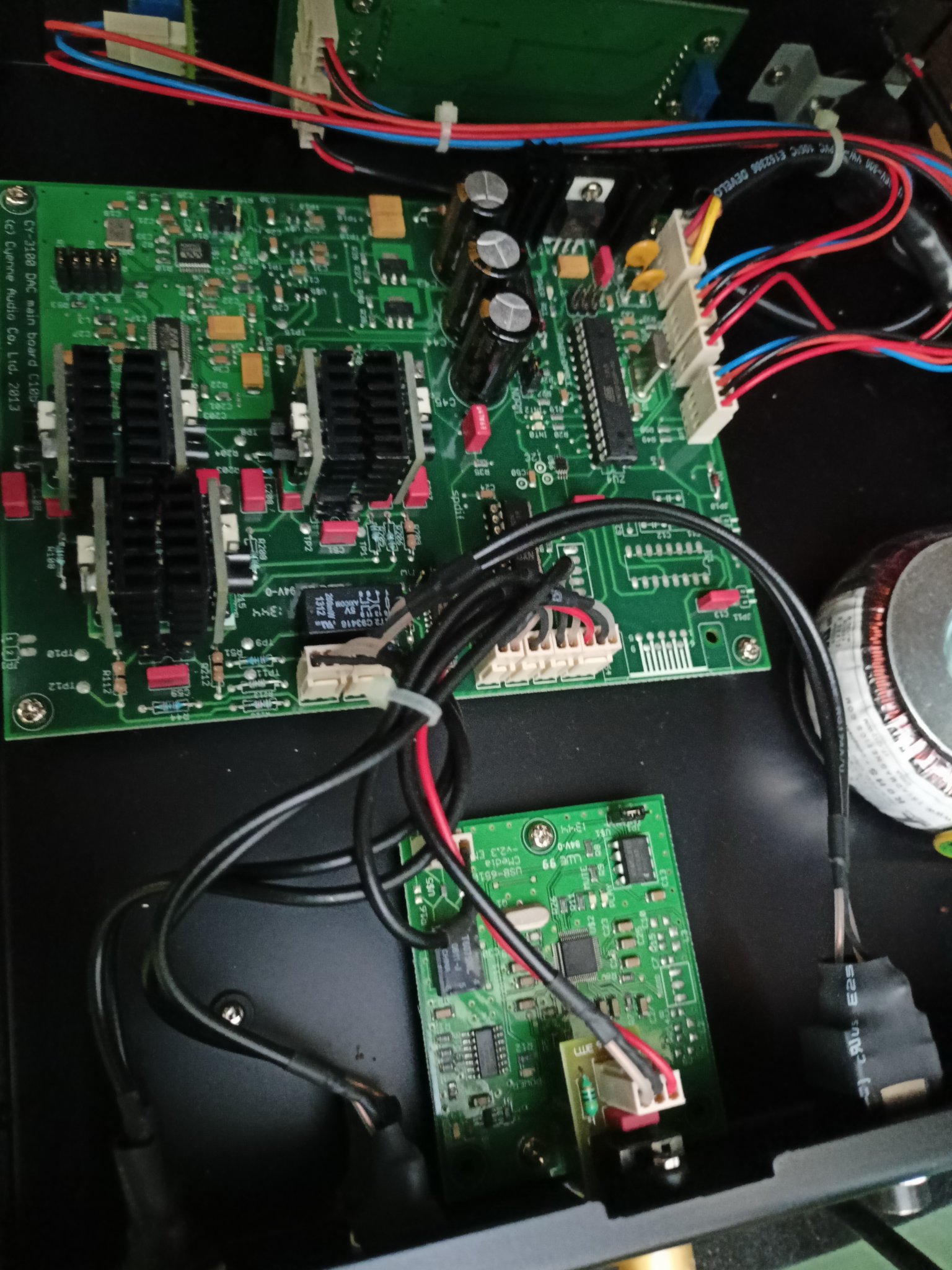

Cyenne 3100 Dac with 3 Staccato Audio dual op-amps
The Cyenne 3100 Dac has 3 removal socketed op-amps. One serves as a combiner op-amp for the DAC. The other two are gain op-amps. The sockets will vary from Staccato Audio discrete op-amps to Burson V6 Classic. Since I only have 2 Burson V6 Classics, they will be placed in the gain op-amp sockets and a Burson V5, similar to the Burson V6 Vivid, in the combiner op-amp socket. I will listen to a playlist of Flac files with a minimum 44.1 KHz and note any sound differences for each op-amp.
