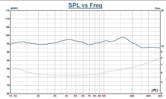

The Fountek NeoCd3.0 used in the "Statements" the OP use HF response is about -3 dB at 40,000 Hz.
What would you suggest for "extending" the top end, do you think going another octave above audibility (80,000 Hz) would be enough to remain balanced 😉 ?

Doesn't the Marketing Department make really swell frequency response charts! They are soooo creative.*

The tweeter response curve may have some smoothing applied, but I doubt Fountec would publish a curve that is not indicative of the general driver response, there are too many people with measurement equipment to fake curves and get away with it any more.
