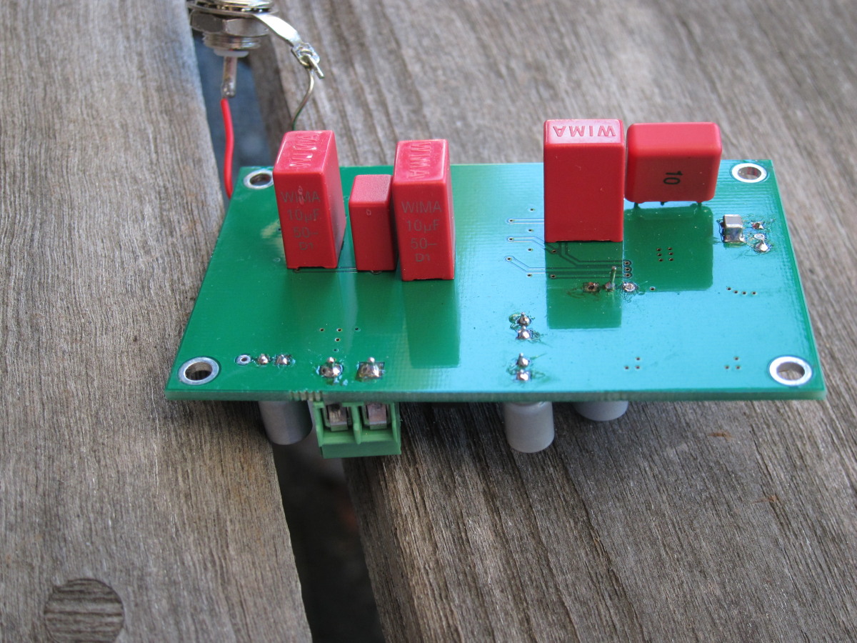

Regarding my tweaking of the V3 - mine was an early prototype of the V3 and I tried out a lot of things. I built this last May, so my description of the changes is about 6 months old but I think still pretty accurate. I was able to compare it to my V2.6 and also a V3 using the alternate SAL-RPM caps that you built. Having multiple versions to compare to made it possible to study the effect of different changes in a controlled manner, so I feel fairly confident in the results.
Tier 1 - most important change from the BOM
Upgrade C22 - the electrolytic cap for Avcc of the ES9023. I really like polymer caps and I find that the sound got better as I increased the size of this capacitor. I ended up using a 470uf 16v Nichicon capacitor. I think it was Nichicon part #493-3019-ND, Digikey 493-3019-ND. You can get away with lower voltage parts (6.3v or 10v). Panasonic and UCC also make good sounding polymer caps.
For best sound, I also recommend adding an output buffer such as the JG filter/buffer.
Tier 2 - next level of importance. C35 - the cap for the NEG terminal of the ES9023. I played around with different values of C35 and found that I got best sound with a value of 4.7uf. I like the Wima 4.7uf 50v polyester MKS2 caps. Mouser part # 505-MKS2-4.7/50/10.
I also found some benefit by increasing the size of C4 - the SPDIF input coupling cap. I used the BOM 0.1uf cap and put a 3.3uf 50uf Wima polyester in parallel. Mouser part # 505-MKS23.3/50/10. I mounted this from the bottom of the board since I was worried about fitting it on the top. In hindsight, it would have fit on the top of the board if I mounted the 0.1uf SMD cap first and then mounted the Wima on top of the 0.1uf cap.
Tier 3 - small benefit. Use better quality caps for the 10uf electrolytics for the WM8804 and ES9023 - C8, C13, and C21. Either use polymer electrolytics such as Nichicon PLF1E100MCL2 (Mouser # 647-PLF1E100MCL2) or Wima polyester. I used the Wima 10uf 50v caps (Mouser # 505-MKS210/50/20) but these take up more real estate and must be mounted from the bottom.
Tier 4 - changes I made that I don't think were worth the trouble. I tried a SAW oscillator for the 50Mhz clock and I liked the sound of it but I'm not sure it's really that much better. Since it's a different pad out than the current clock, it was very difficult to solder this one in. I used Kyocera KC5032A50.0000CM0E00 which is available from Digikey.
I've attached pictures of the top and bottom of my build so you can see how things went together. It's not that neat with parts on both sides but it's quite mechanically stable and sounds very good.
