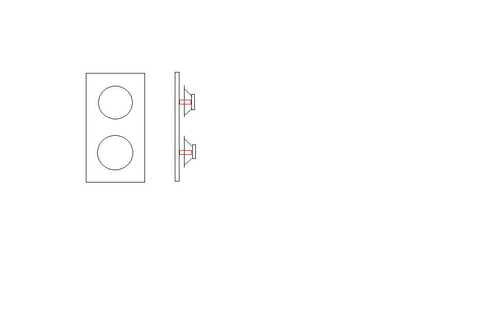

Just made a thread with this idea
A huge "membrane" coupled to any number of woofers
Membrane might even be simple polystyrene, hung in threads in a frame

Joined 2004
You don't know the physical width or height of the woofer box you need nor crossover frequency for starters. But once the ESL is completed, the bass unit is made to suit. And if you decide making the ESL is too difficult (It might happen even to you.), you didn't waste time making a woofer box.
i want to that looks a bit like this. It's esthetically pleasing and it's a dipool
