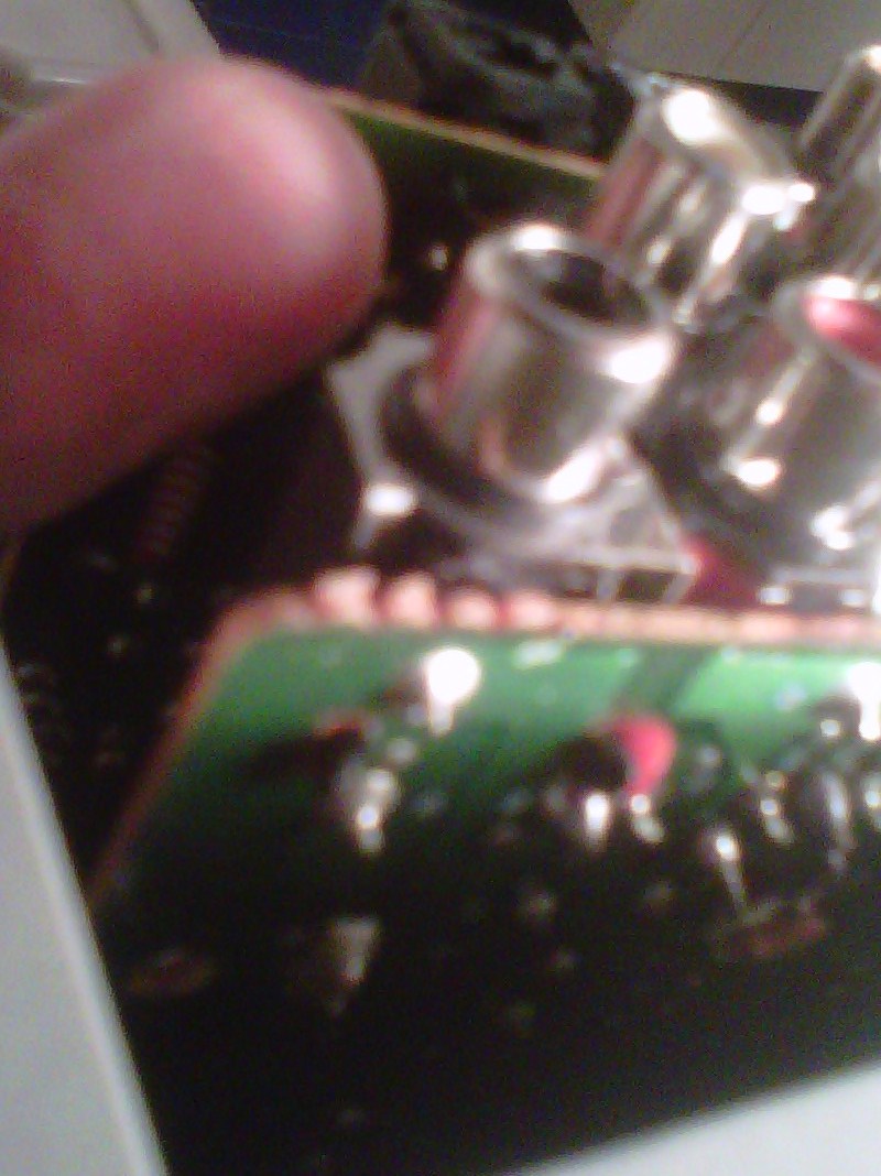

It's most probably the connector pins have cracked solder at the printed circuit board. This is really common problem in my experience. (thermal fatigue fractures) Re flow the connector joints with fresh solder with all the screws cinched tight.

It's not a grounding issue per se, it comes and goes. It could conceivably be that as the equipment heats up, a poor connection get better and introduces a ground loop, but this is unlikely. In order to get anywhere though, you have to fix the intermittent connection, WHICH IS DEFINITELY THERE.

Thanks for the advice, I'll open up the unit and see whats going on. I may have to post some pics for additional help. Thanks again!
Image of sub input
I know this isn't the clearesr of pictures. The first output is the sub pre out. The solder looks pretty good at least to my novice eyes. It looks as good as all of the other joints. What exactly am I looking for? As I stated earlier the HTS20 sub will hum as soon as I connect an rca cable, without hooking to the receiver. When I push in on the cables the humming stops. The smaller sub that I have, when hooked up works fine for a little while then the same loud hum reappears. When I shift the cables around the humming with stop for a little while.

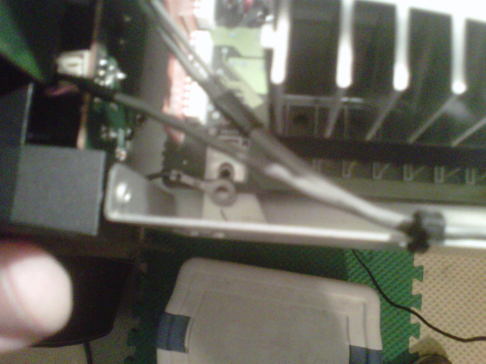

dunno if u tried yet ,but have you disconneted earth from the mains 1 or both sides?I know this isn't the clearesr of pictures. The first output is the sub pre out. The solder looks pretty good at least to my novice eyes. It looks as good as all of the other joints. What exactly am I looking for? As I stated earlier the HTS20 sub will hum as soon as I connect an rca cable, without hooking to the receiver. When I push in on the cables the humming stops. The smaller sub that I have, when hooked up works fine for a little while then the same loud hum reappears. When I shift the cables around the humming with stop for a little while.
ok, excuse my ignorace on electronics, but I may need a little more advice on locating the grounds on the mains. Is this the ground in the picture that I've attached? Also this is the only clip like this that I have found.
i mean the mains ,the wall socket ac 230/110
The plug from the receiver is a two prong plug as is the plug on the sub? should I get a 3 prong adapter?
