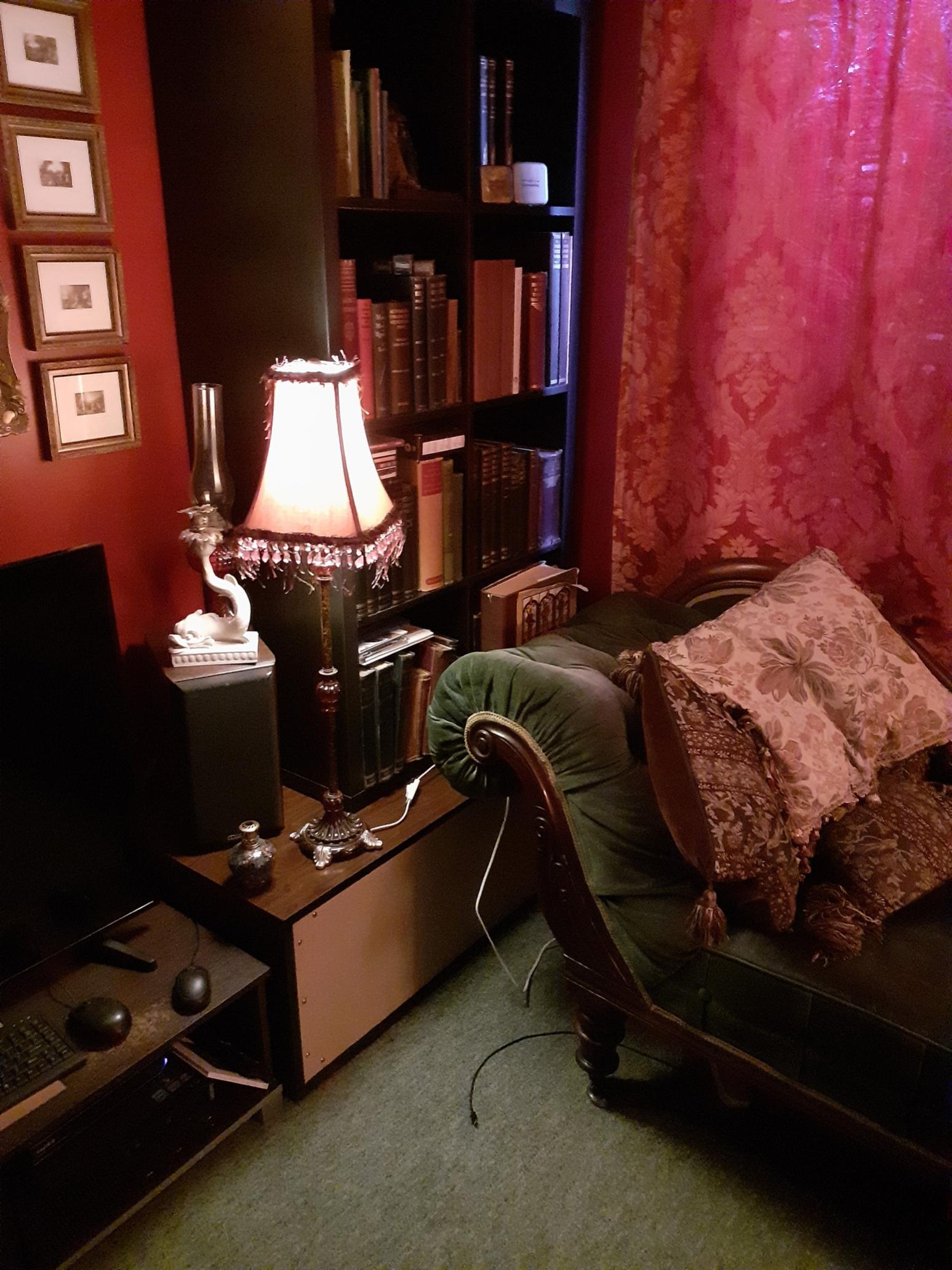

Despite all the equipment in my AV cabinet, I've put a bit of effort into getting the living room quiet and it is almost silent at the listening position when music etc is paused. Not anymore with this subwoofer turned on.

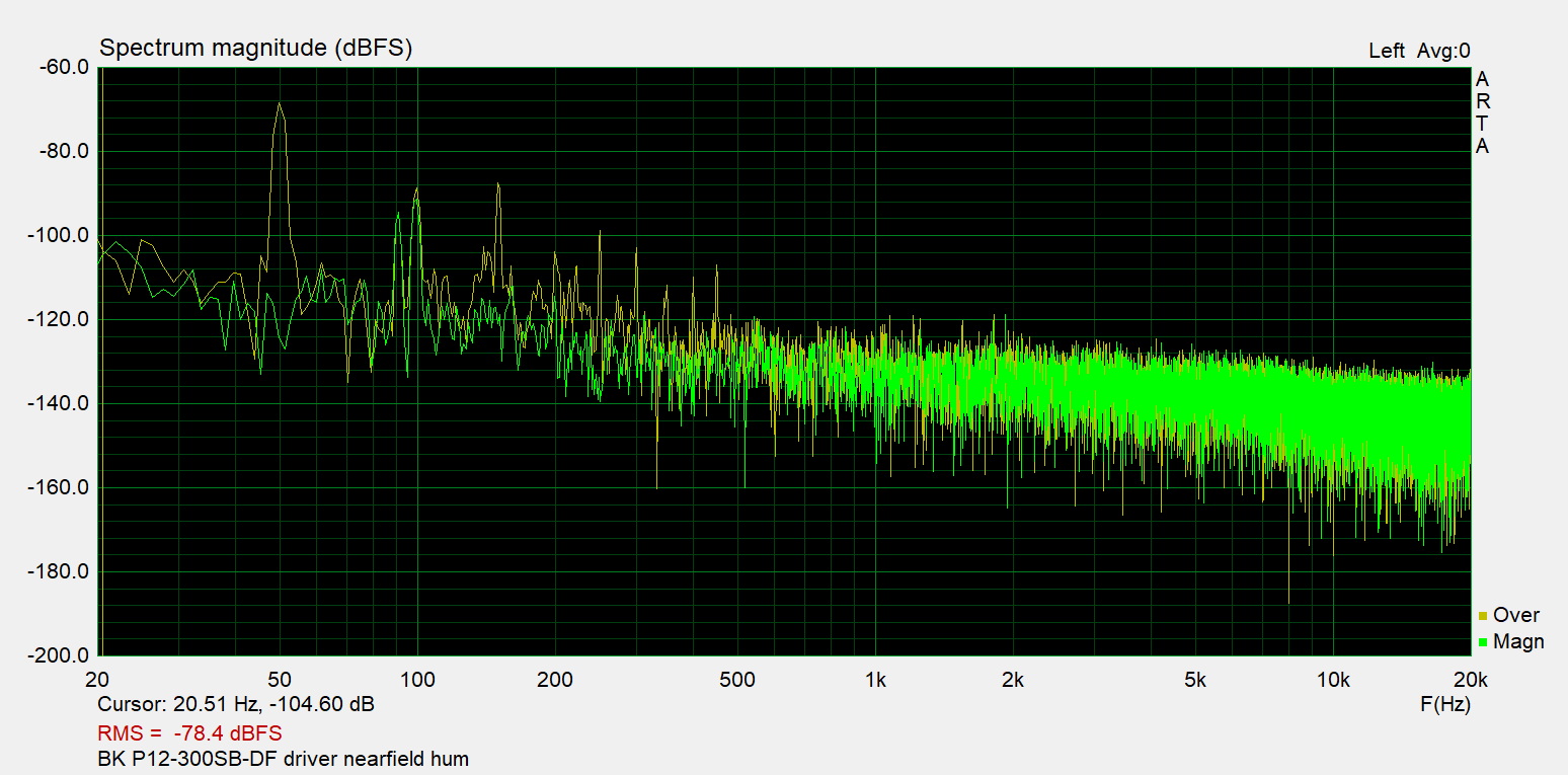

It's not 50Hz hum, it's some multiple, possibly 3rd harmonic. I'm also not actually sure the hum is being produced by the driver, as putting some fingers on the cone doesn't make any difference.
listening to the cabinet it sounds like it's vibration from the power supply components being radiated through the wooden cabinet, albeit I don't know what kind of power supply it uses without opening it up.

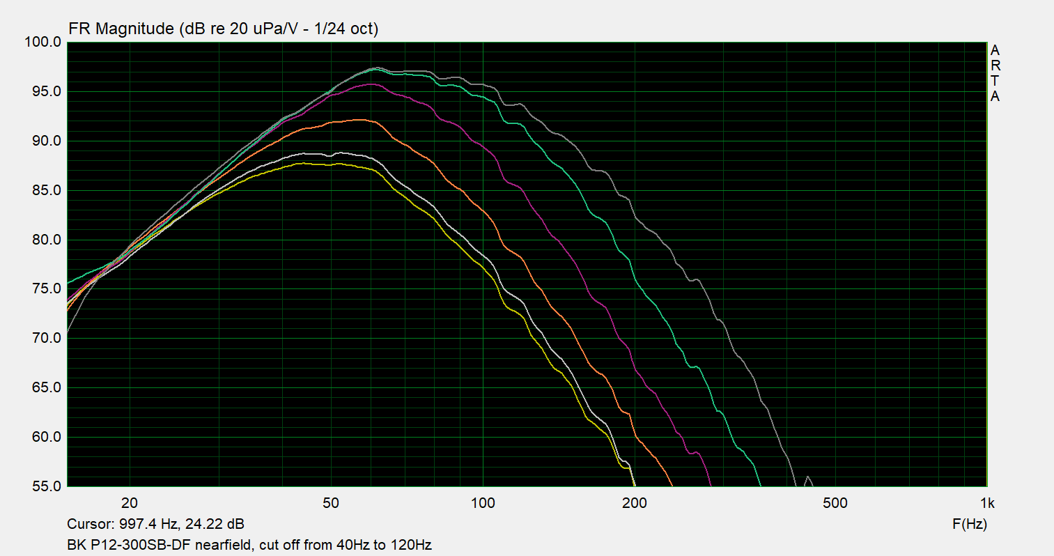

3) Claimed frequency response isn't even remotely accurate. "-3dB lower than 20Hz" is the vague claim, but it simply doesn't come anywhere near that.

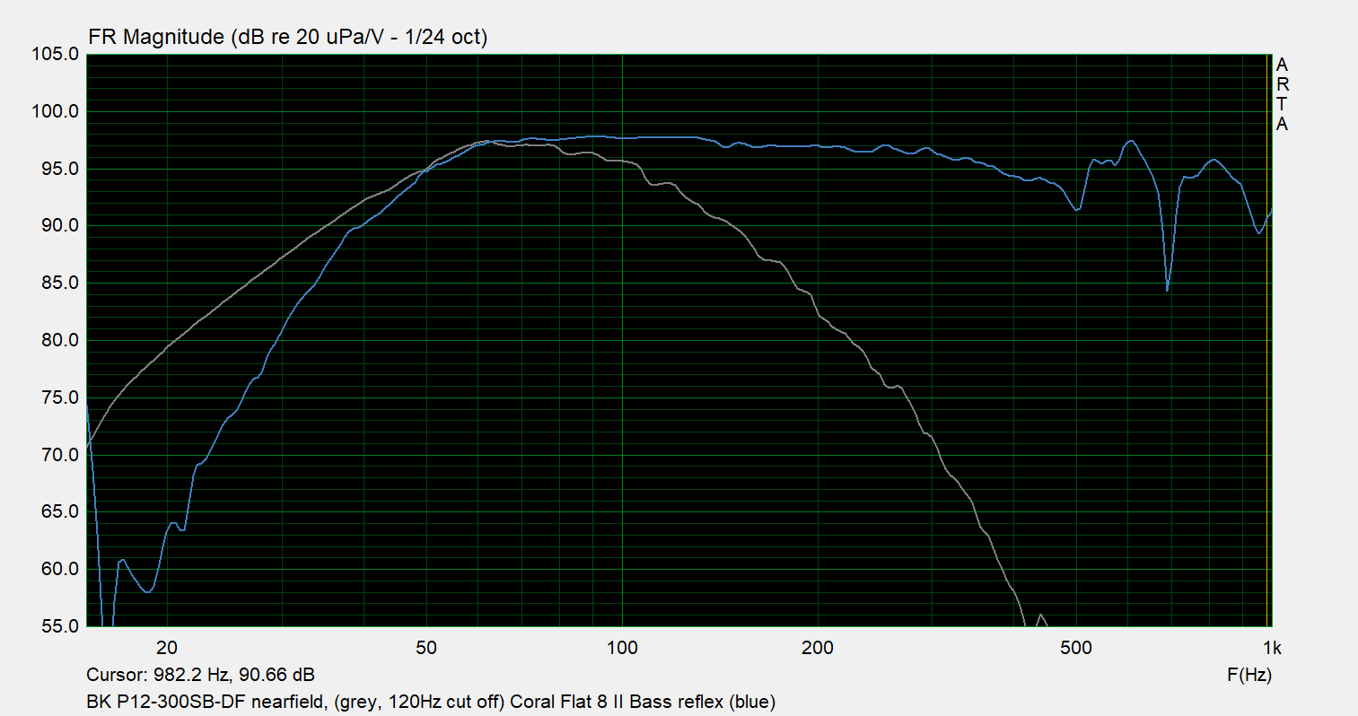

Currently my mains speakers as mentioned earlier are two 8" full range drivers as midwoofers up to 3Khz, (with a ribbon tweeter) they're in 43 litre bass reflex enclosures tuned to 41Hz.
Nearfield (summed driver/port) measurements show their anechoic response is about 6dB down at 40Hz and they have a sort of early gradual roll-off slope. (No B4 here...)
In room they are pretty solid and punchy down to 40Hz (I actually have to notch the 40Hz fundamental room mode down by about 6dB...) and still have useful output down to 35Hz then nothing below 30Hz.
I was kind of expecting the subwoofer to be able to extend the bottom end response down to at least 25Hz but no dice!
There is absolutely zero audible output in room at 25Hz from this subwoofer either by itself or with the mains still running. It's output goes down to about 35Hz well, is still audible at 30Hz then drops like a rock below 30Hz with nothing audible below 30Hz.
Songs that I'm familiar with with lowest bass note around 25Hz are still missing in action with the subwoofer.
In short, although I haven't measured it yet, the low end cut-off is pretty much identical to my 8" bass reflex main speakers and adding the subwoofer does not extend the low frequency cut off at all... That's pretty disappointing and inexplicable to me especially given the mains are high sensitivity, light cone (8 gram) full range drivers competing against a heavy 12" subwoofer driver in the same size enclosure! (Mind you they have always punched above their weight for bass)
Granted its a small room with its lowest mode at 40Hz but I thought I would have heard something below 30Hz from a sealed, 12dB/oct roll off woofer that claims to go below 20Hz. 🙁
I need to do some nearfield measurements of this subwoofer to identify the frequency of the hum, measure the true nearfield response to see if it comes anywhere remotely close to the claimed response, and also try to figure out what this phase control is doing (it only seems to bend the phase at low frequencies) and whether the phase of this thing is reversed when it says it's set to 0 on the high level and/or low level inputs.

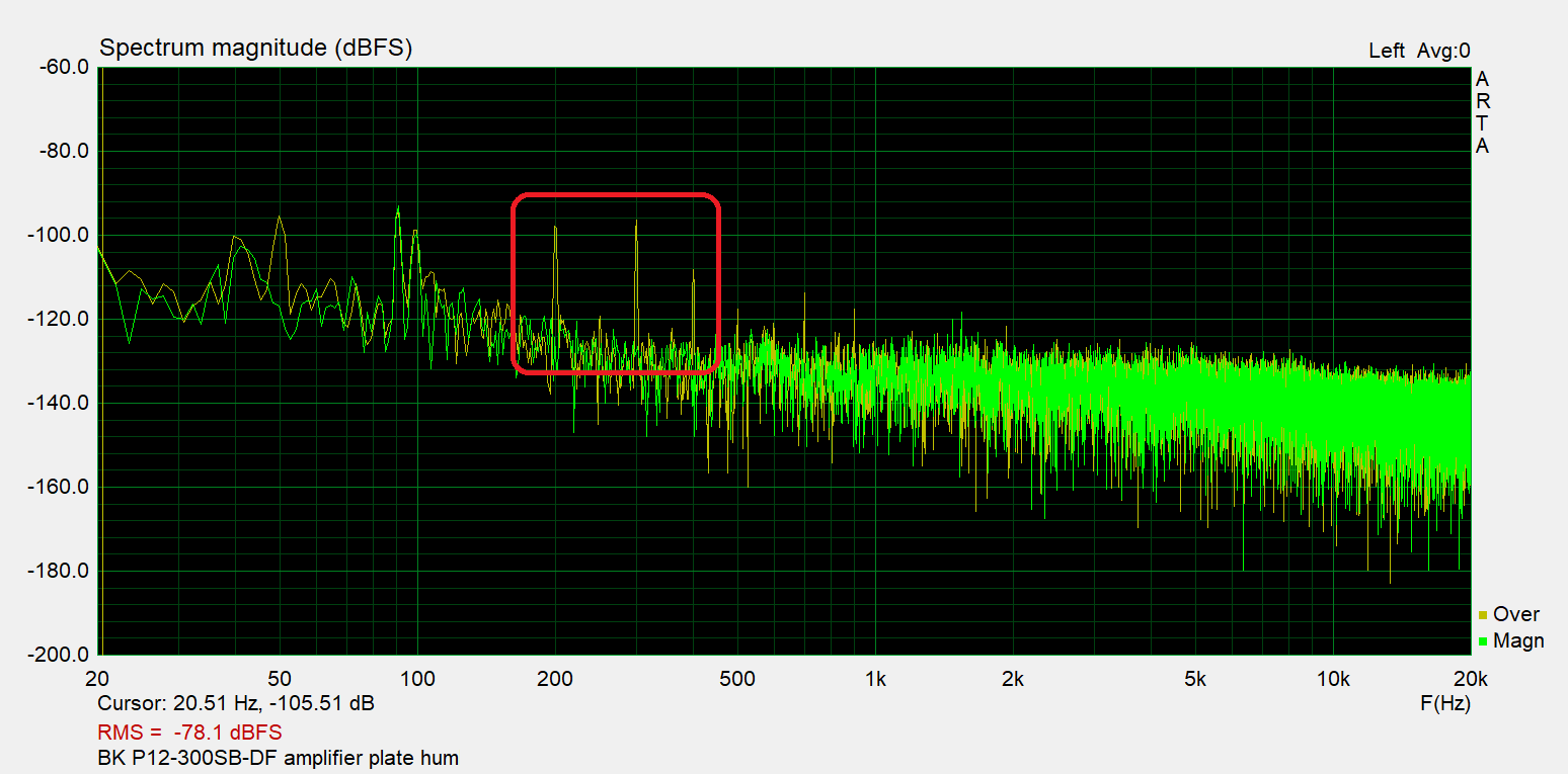

Unfortunately it's quite high frequencies. I did some measurements today and while there is a small amount of 50, 100, 150Hz hum directly from the woofer, it's very low in level and not audible at a normal seating distance.I feel your pain with the hum, returned a brand new amp recently that was so loud it might as well of had a fan in it...
Maybe try a heavy concrete / marble slab on top to damp the enclosure ?
However the noise I'm hearing is coming from the plate amplifier and measurements are showing it has peak spectra at 200, 300 and 400Hz.
This fits in with what I was hearing - it sounded like a 300Hz tone to me, (which will propogate very easily in the room especially with the subwoofer in a corner where it will reflect from the corners) and 300Hz is indeed the largest peak.
A little bit of research suggests that it might be DC bias on the AC mains affecting a toroidal power transformer, although I'm a little sceptical as I've never had this issue on any other equipment in the past.
Unfortunately no, because the high level input cable uses 3 wires with a shared earth connection for both channels. So no way to reverse the phase and still sample both left and right channels. (The same would apply to the low level inputs to be honest, as they would share an earth as well. You could only get away with this if you were connecting to one channel)Re: Phase, can you swap the + and - connections at your main speakers to cure it ?
I've done a whole host of measurements tonight - both the hum from the driver and plate amplifier, as well as a full set of nearfield frequency response measurements for every low pass filter setting.
Unfortunately the measurements confirm my fears and what I observed subjectively during my initial attempts to set it up. It's getting a bit late tonight so I'll post the measurements and some analysis tomorrow.
In short, it's probably going back after I give them a chance to respond and address (or not) the problems. As it stands it doesn't come anywhere near meeting its claimed low frequency response and the 200/300/400Hz tones coming from the power supply are far too intrusive in a quiet room especially when the tones remain even in auto-standby mode. I went to some trouble to make sure all the other myriad of equipment in the AV centre are whisper quiet so I don't want an always humming subwoofer to ruin that. 🙁

Ok now for some measurements. First the "hum" that I can hear clear across the room which sounds like low midrange frequencies.
It could either be reproduced by the woofer or by the transformer in the power supply, so I checked both.
Here is a nearfield measurement of the woofer with it switched on with no signal applied:
Green is ambient noise in the room before turning the subwoofer on, yellow is the additional noise added by the subwoofer.
Quite a bit of 50Hz fundamental and 150Hz 3rd harmonic is visible but the level is lower than this makes it appear as I'm doing a nearfield measurement, and this 50/150Hz hum is not audible at a normal listening distance.
Now a measurement taken a couple of inches away from the back of the plate amplifier:
Like before, green was ambient room noise as a reference with yellow being after the subwoofer is switched on.
The spectral balance is completely different here. A small amount of 50Hz but the largest peaks are 200, 300, 400Hz, and its those that I'm hearing from right across the room in a quiet room.
300Hz propagates very well into the room especially when the subwoofer is in the corner.
My ears are still not too bad - when I first heard the "hum" I though it sounded like lower midrange "somewhere around 300Hz" rather than 50hz and I was spot on.
Small comfort from being right about something that annoys me though. 🙁 To me this low midrange tone is unacceptably loud given the noise is there all the time unless you manually switch it off. I'm sitting 3.5 metres away from it and it's very obvious when the room is quiet.

The other main problem I noted is that it simply doesn't live up to the stated low frequency response. Not even remotely. 🙁
The stated response is a somewhat vague "-3dB lower than 20Hz". Is this an in room response (room gain included) or a true (nearfield) response ? Either way it doesn't meet either possibility.
In room it only works well down to about 35Hz and is completely inaudible below 30Hz. So basically it only goes a few Hz lower than my 8" bass reflex main speakers.
I haven't been able to find any measurements for this subwoofer online, so here are my own measurements.
These were taken using ARTA and a calibrated microphone that should be accurate to <20Hz. I took a measurement for each increment on the low pass filter setting although I've only shown some of them here otherwise the graph gets too cluttered:
-3dB at 20Hz ? I think not.
Due to the overlap of the low pass filter, depending on where you set the low pass filter the -3dB and -6dB points do move a bit but here are a couple of examples:
With the low pass filter set to the maximum 120Hz setting the speaker is -3dB at 46Hz, -6dB at 38Hz and -17dB at 20Hz.
With a more typical low pass filter setting of 80Hz (orange line) the speaker is -3dB at 38Hz, -6dB at 30Hz and -13dB at 20Hz.
So, yeah... not good. Looking at the response it's clearly just the response of a large 12" woofer in a small (40 litre) sealed box without any active equalisation such as a Linkwitz transform to improve the F3.

For fun I decided to overlay the nearfield low frequency roll off with nearfield measurements of my existing main speakers, which are only 8" full range drivers in a bass reflex cabinet of about 40 litres.
Of course they ultimately roll off at a steeper rate due to being bass reflex, but they're within 3dB of this "subwoofer" right down to 35Hz, and below 30Hz neither set of speakers is audible anyway so the difference becomes academic.
Subjectively, down to 35Hz there really isn't much between them when an actively powered 12" subwoofer (with a proper Linkwitz transform) should be able to trounce them on low frequency extension.
So cavet emptor. 🙁 This will be going back and I can't recommend this model knowing what I know now.
