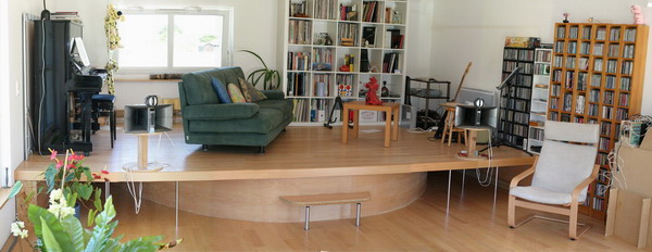

I recently accidentally found the best bass in my room when I was standing on a chair :clown: 😀
which now reminds of the photo with a bass horn built under a lifted floor ... maybe there is more to it than that :scratch2:
