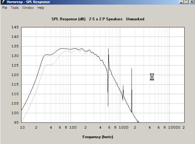

Hi Lee in Montreal,

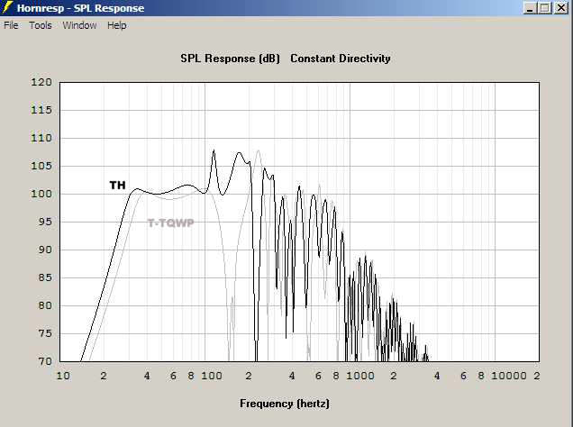

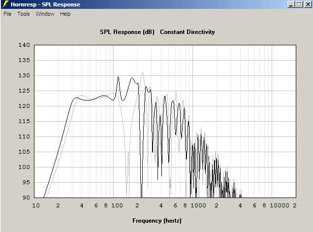

Here is a rough stab at your horn (using your numbers). V_net is 813.6 Litres, that's one big box. One of bjorno's TQWPs would be 309.1 L, and a TH 569.8 L. All of those 2pi/2.83V.
Oliver,Here is a rough stab at your horn (using your numbers). V_net is 813.6 Litres, that's one big box. One of bjorno's TQWPs would be 309.1 L, and a TH 569.8 L. All of those 2pi/2.83V.
Big box is great at 60 -300 Hz ;^).
Are all three using the same driver?
What do they look like at Xmax?

Hi Art,
All with the JBL 2242H, and close to factory T/S (recalculated somewhat using Hornresp).
I'll attach the Hornresp Export files (for what it's worth), that way you can do some fine tuning, and get the low cutoffs similar, etc. None of this is optimized.

Box is too big for my taste, and the low Xmax driver limits output by about 6 dB.
Thanks, Oliver.

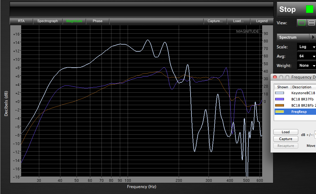

Hi Art. Thanks for the constructive comments. Heavier cone may be stronger, but also usually also means reduced frequency range. Being able to play 30Hz to 200Hz can be very practical when getting the 2242. In term of driver price, I have acces to close to a hundred 2242, with moderate use at under $400 each. Buying a JBL woofer also means that in 10 years, I will be able to source original replacement cones. The higher efficiency of the 2242 over the BC (3+db) means I need half as much amp power. Everything is a compromise obviously. I did hear good thing about BC products and i am not being snobby... ;-) In regard of the BC18's specs,a hight Qts of 0.39 doesn't look too good to me in a horn. Looks better suited for bass reflex.
I find the sound of vocals coming through a ground located speaker to be odd, so don't ever cross subs much higher than 100 Hz.Hi Art. Thanks for the constructive comments. Heavier cone may be stronger, but also usually also means reduced frequency range. Being able to play 30Hz to 200Hz can be very practical when getting the 2242. In term of driver price, I have acces to close to a hundred 2242, with moderate use at under $400 each. Buying a JBL woofer also means that in 10 years, I will be able to source original replacement cones. The higher efficiency of the 2242 over the BC (3+db) means I need half as much amp power. Everything is a compromise obviously. I did hear good thing about BC products and i am not being snobby... ;-) In regard of the BC18's specs,a hight Qts of 0.39 doesn't look too good to me in a horn. Looks better suited for bass reflex.
The B&C drivers work great in BR, TH or FLH, 30-300 Hz would be achievable in a FLH. The cone strength is almost overkill for BR.
As far as efficiency, they have less power compression due to better cooling, which will easily offset the difference.
It really comes down to displacement, you will need almost two of the 2242 to match a B&CTBW100.
For that cost, you could almost afford to get a B&C21SW152, which would be in another class entirely.
Below you can see the response of a BC18SW115-4 in BR and the Keystone TH, which sims (and measures ) around 131 dB at 40 Hz within it's rated power and excursion. The Keystone is way less than half the size of your design, yet has similar output to 35 Hz of four of the Berthoids..
For a fixed installation with the potential to build huge cabinets, I'd be torn between TH and FLH. Without a lot of experimentation, I'd probably opt for Josh Ricci's Othorn, which in actual measurements blows away the big Bertha or the JBL cabinets mentioned earlier in the thread.

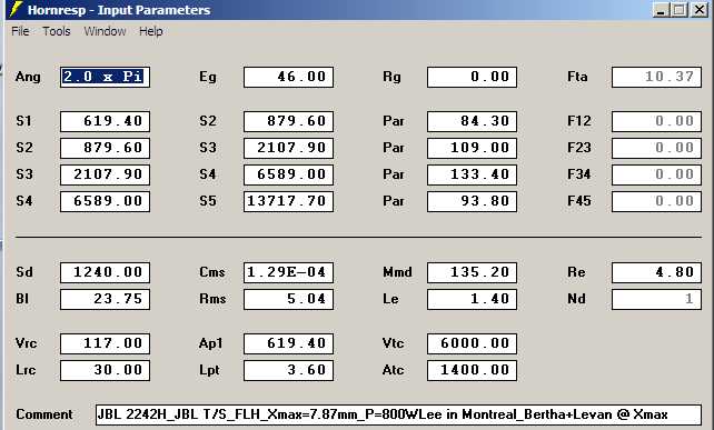

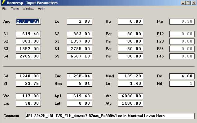

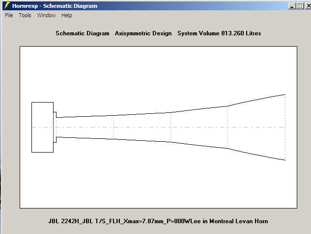

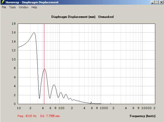

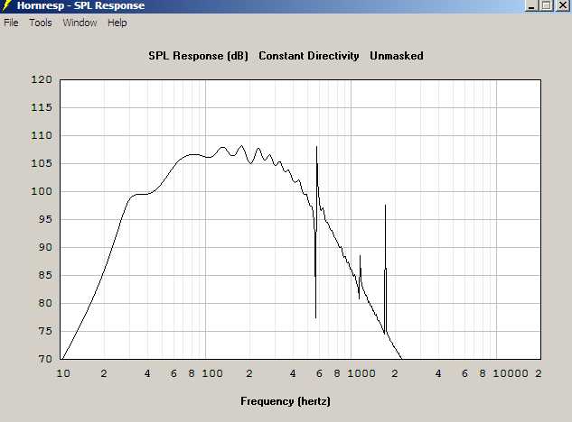

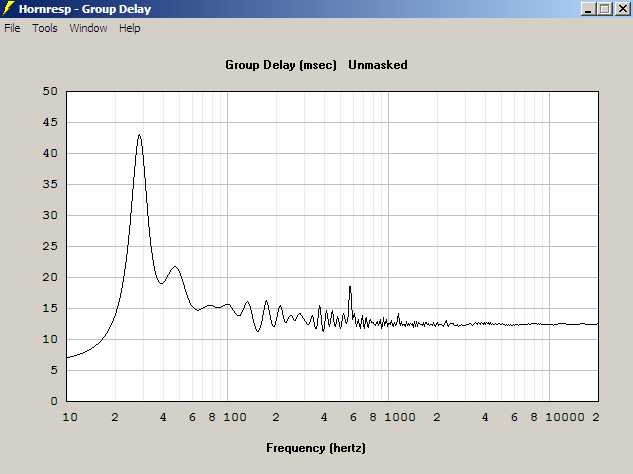

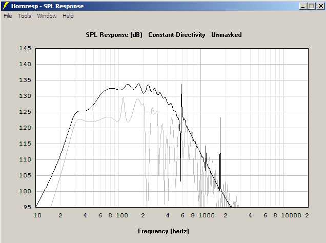

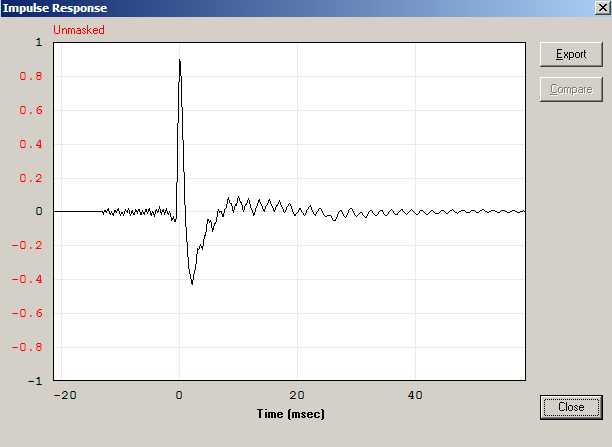

Hi Y'all,
Here is the Hornresp for the combination of Bertha horn with Levan extension. The horn path could possibly benefit from a little more detail work, but I don't think it would make a difference in the output. This is for a single JBL 2242H @ ~ Xmax. It's definitely a manly sub.
Oliver,This is for a single JBL 2242H @ ~ Xmax. It's definitely a manly sub.
Manly in size, not so manly in output. Can't win 'em all😉.
BTY, Short Fuse Lee has left the post to the ones willing to do some comparative work.
Art
