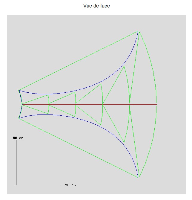

I am asking for help simulating this bass bin as I am running on Mac and could never find any simulation software. Basically I have redesigned a sub, based on work done by Electro Voice (TL4050 using 15" woofer) and EAW (BH882 using 18" woofer), and were later modified by Richard Long as the famous Bertha. The Bertha had a 7.5 foot horn path, plus 3 foot Levan extension. I redesigned it with 10.5ft internal path, and the optional 3 feet deep extension. I intend to use JBL's 2242. What can be altered for best result is the throat area and back chamber volume. Current throat works on a 2:1 compression ratio with that 18" driver. Can anyone sim this bin and tell me how rear chamber volume and throat area can be improved?

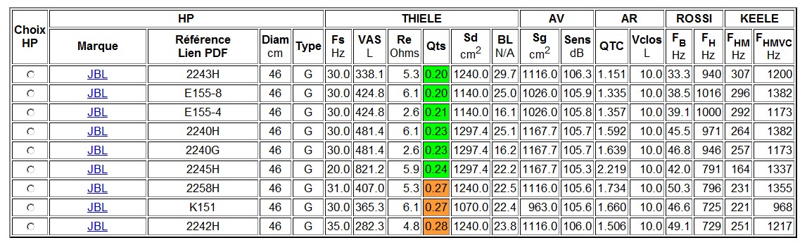

Strange, how do you know this woofer is good for your application?!I intend to use JBL's 2242

Why do you think it is not suitable? I'd be interested to hear it as so far, it is what is inside most Berthas being used in clubs. You should check the T/S parameters. They are quite good for a horn loaded cabinet.Strange, how do you know this woofer is good for your application?!

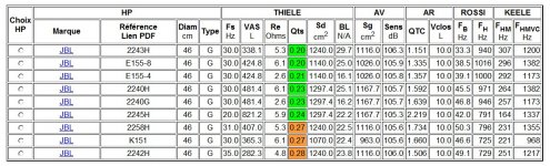

2. It just shows in my sim an orange tag for this driver (not the best).I even searched for Excel spreadsheets and found none.
BTW When you mention that the 2242 is "not the best", are you refering as "not he best for home duty" or "not the best for PA". Those would be two very different requirements. The 2242 has a relatively low Qts (0.28) and a strong motor. The venting allows for great cooling. This is perhaps the best sound reinforcement woofer JBL has made in decades. And that's why it is widely used on dance floors. Both on bass reflex cabinets and horn loaded ones.

I only meant the JBL 2242H not good for horns. Take it at face value (simulation program, not my experience). I only see it being used as (front) bass reflex enclosures.

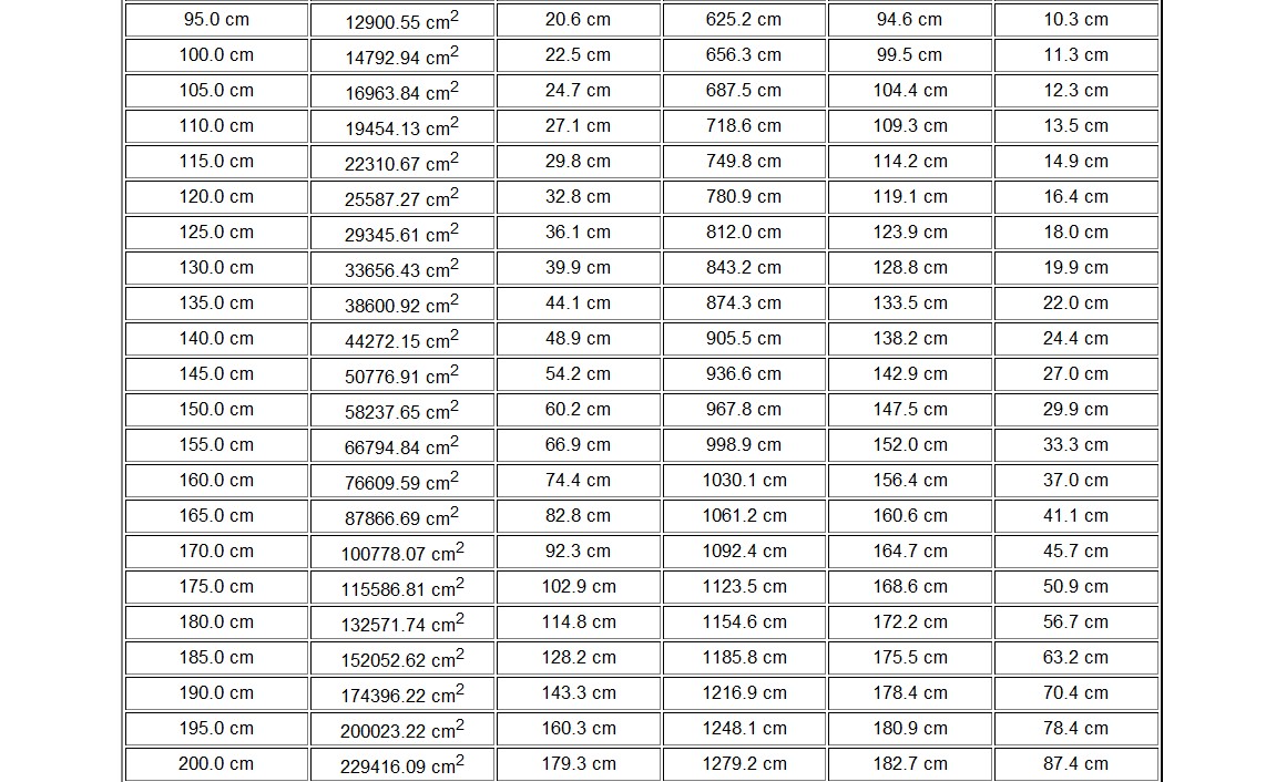

Can you give the cross section areas and lengths in centimeters? Ill do the simulation for you

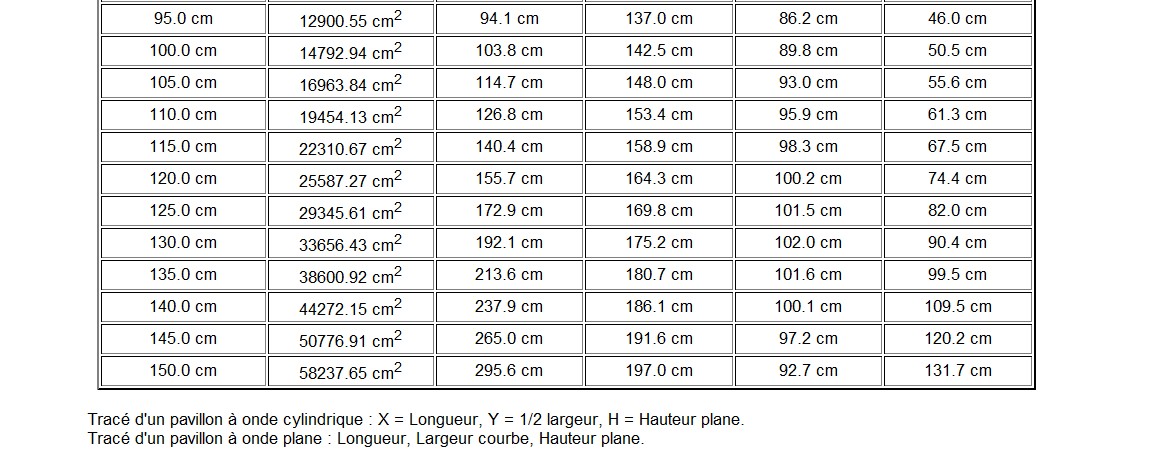

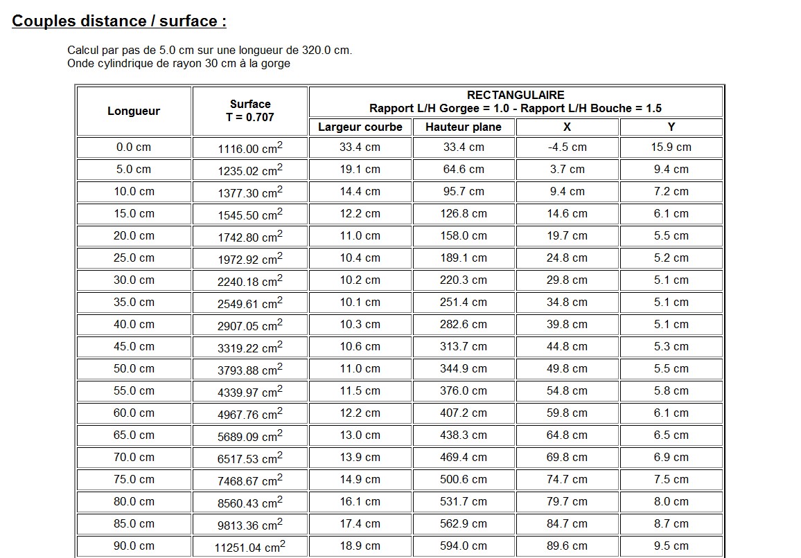

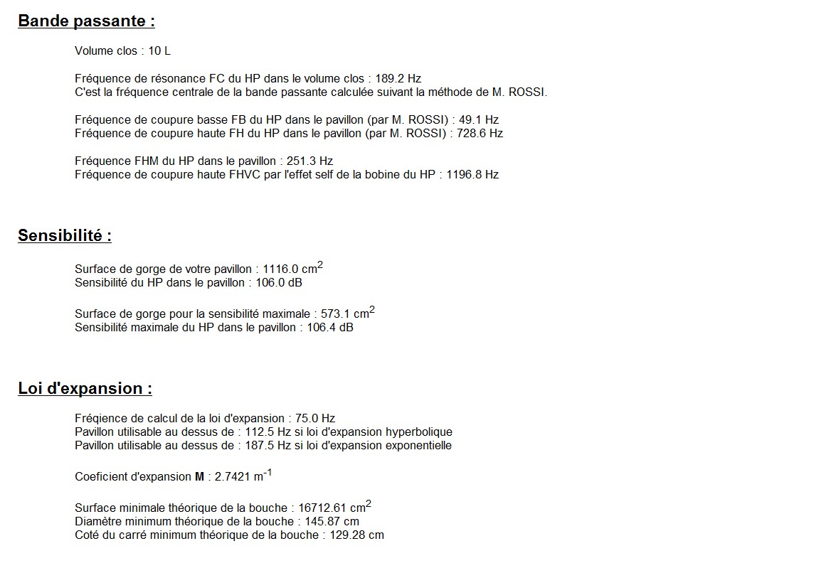

I'm not sure if this is of any help (in metric/cm), 10.5 ft horn simulation for JBL 2242H.
So, according to the sim, is the F3/Fb of that monster only 49 Hz?I'm not sure if this is of any help (in metric/cm), 10.5 ft horn simulation for JBL 2242H.

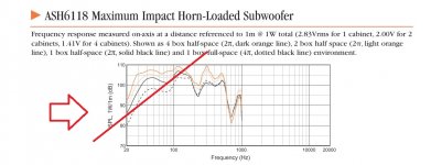

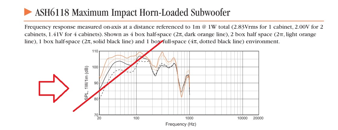

Do you see that expressed in the graphics pic of the pdf (or is it me??).JBL 2242, as used in the ASH-6118WH horn loaded sub is flat to 30Hz with high efficiency.
JBL ASH-6118WH Specifications:
Frequency Response (±3 dB):1cabinet: 30 Hz – 200 Hz,
JBL written "Specifications" seldom seem to match the graphs.Thanks for posting the reference JBL ASH6118 Horn-Loaded Subwoofer for the JBL 2242H.
Looks like 4 of ASH6118 do a good job getting to 30 Hz, but a single rolls off below 40 Hz.
It's not very "flat" whatever that means 😀 😀, it's only half-infrasound to shake half of the crowd (make it double 2x20Hz=40Hz an octave above).So, according to the sim, is the F3/Fb of that monster only 49 Hz?
