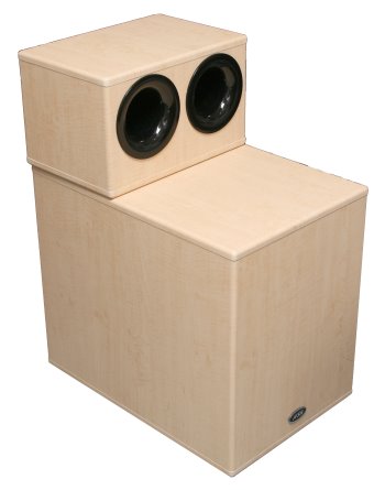

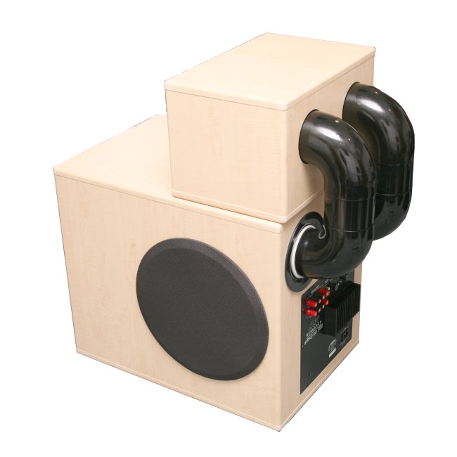

Use a 4" port and extend it outside the enclosure as needed. Something like this, but without the box on a top:
It's not suitable for me since i have a small room.

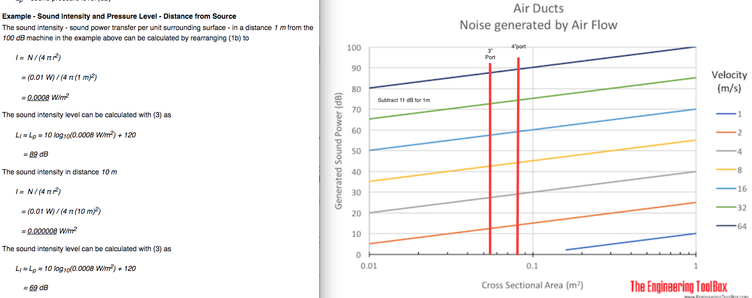

Whether the port noise will be objectionable is a matter of signal to noise ratio.
Using graphs from
Noise Generated in Air Ducts
Sound Power
we see worst case (no rounding) at 40 m/s a 3" duct may generate roughly 70dB SPL noise at 1m, dropping to perhaps 60 dB at the listening position.
Although that level of noise may be audible if you are playing only low frequency sine wave tones, the SPL of music peaks when the sub is running at levels high enough to generate high port velocities will be so much higher that it will mask that noise.
If not, you know what to do 😉.
Using graphs from
Sound Power
Wow, what a useful graphs!
I was running some live tests here, with a 33 L prototype and 3" port and I saw that is no port audible noise with all acceptable listening levels.
