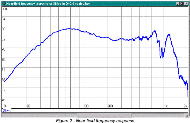

This explains the weird Shiva response shown in the Shiva white paper itself. I always used to wonder...

I suspect that graph was made with a crossover in the circuit, since the Shiva wouldn't normally (lowpass) rolloff anywhere near the 100Hz region; probably more like 1kHz. However, the slope from there on down is exactly what I was trying to describe.
Note that it's a simple 6 dB/oct rise, i.e. 40Hz looks to be pretty close to 6 dB higher than 20Hz, etc. And since the graph shows three different Qs, you can see that you can't fix it by varying the cabinet volume.
Now, if you were to use a 6 dB/oct <i>lowpass</i> starting around 20Hz, the falling crossover slope would combine with the rising driver response to give you flat response. But you'd have nothing remotely resembling a crossover point at any frequency that you'd regard as normal for a subwoofer. Once you've got that rise tamed, you can do pretty much anything you want with it.

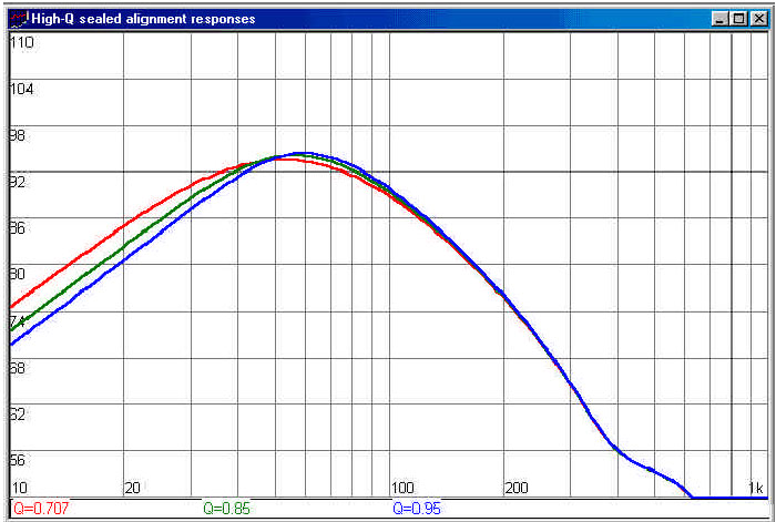

Adire's shiva whitepaper lower Q graphs have a much smoother response - yet still a noticeable hump. I've gone for about Q=0.56 - dual vented / sealed enclosure.

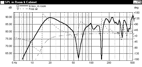

I wish modelling programs were better a simulating in room response. Here's what I'm expecting - based on Adires lspCAD:
(see graph below)
I realise the cabinet won't make up for the Shiva's "hump". I will research pc card attached mics for some near field and in room response measurements. If I can manage a mic (electronically challenged am I) - then I'll graph and post the actual response.
