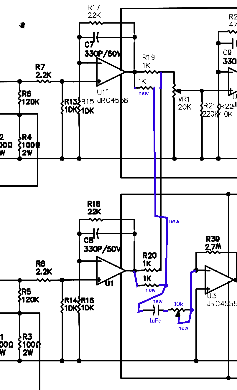

I have studied the circuit and have achieved to modify it to get triggering at 150 mV, but it's not where I want yet. What I have done is modify R38 value (with a parallel R until I'm happy). This way I rise the U3 amplification factor from 100 to about 280. R28 is now about 9'600 ohms.
I would like to get its sensitivity higher, so the triggering happens at about 80-100 mV. It would need a R28 around 5K or so. What I'm not sure about :

- is this the correct approach ?
- do I charge the output of U1 and U1' too much by reducing R38 ? Not sure how to evaluate how much the U3 amp circuit loads its input...
- or is there another approach I have overseen around D3, Q1, etc ?

Yes, the no added parts path is smaller R38. Since the '4558 can drive 2K easily, and there is 1k already, R38 "could" be 1k. That makes U3 gain about 2,700. Sensitivity about 0.2mV. '4558 is a 1MHz part so the bandwidth is 0Hz-370Hz.
Some problems:
With phono source, subsonics could keep the amp ON, even if the tonarm lifts (some phono preamps have large subsonic "hiss"). I'd want some bass cut.
A flute solo intro may not put enough signal into the lowpass to trigger the woofer. OK, you don't need it; then the band comes in and the subwoofer thumps into life.
Taken too far, system noise will keep the woofer ON when music is "silent".
But your path may work OK. Make R38 a 10k pot plus maybe a 1uFd cap. Keep turning until it works as desired, or doesn't.
Ah... if R38 is very low it shorts-out the R19 R20 mixer. You need a second mixer. Couple of 1k resistors, jumper, then on to a cap and a 10k pot.

Thank you PRR, I will conduct some more experiments based on your detailed feedback.

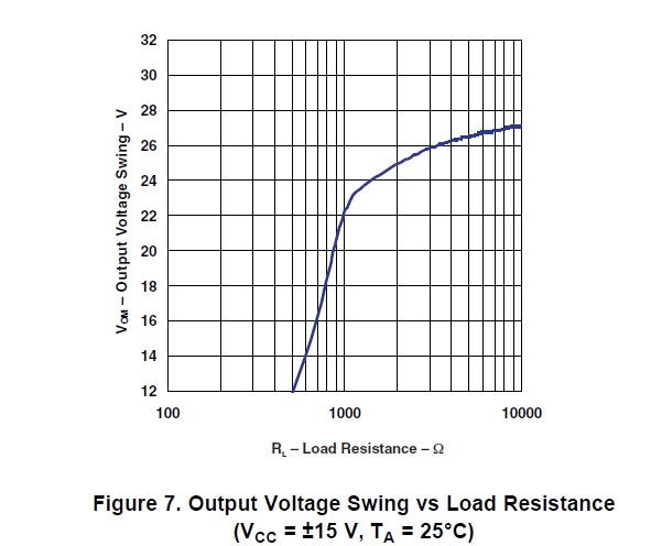

I have tried to understand what defines the current that my op-amp can drive and can't find anything on the data-sheet. Is this to be calculated by a max dissipation, swing voltage and R-load ?...Since the '4558 can drive 2K easily, ...
I ended up with replacing R38 with a value of 3,3KΩ, without any other change. Never turns it on when I don't want to, but does when playing music at low levels.
....what defines the current that my op-amp can drive and can't find anything on the data-sheet.....?
There used to be a current spec on the '4558 sheet, but I don't see it on the 2014 re-print?
The "minimum load" is ambiguous. For "perfect" response? For "acceptable" response? Transistor opamps were traditionally rated for 10k load (opposed to 100k for tube opamps) but most will go lower. I have seen chip opamps driving under 100 Ohms, but at low levels.
https://www.ti.com/lit/ds/symlink/rc4558.pdf
Page 7 Fig 7.
It does OK for 2k and up, is falling off fast below 1k. This may not be the THD curve; but it may be close, anyway you don't care here.
