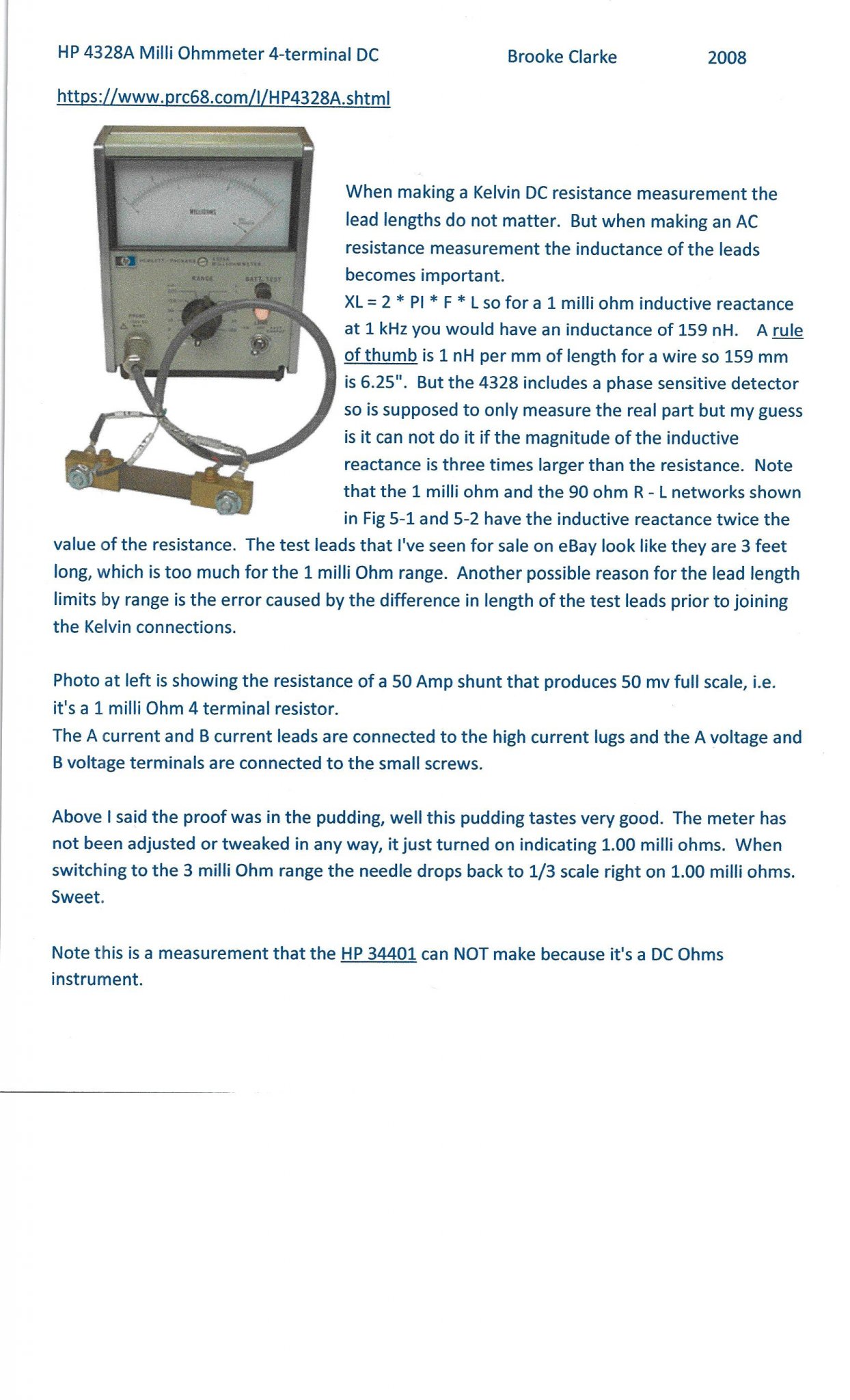

I could not find your reference but I did find this guide which is pretty comprehensive: https://www.seaward.com/gb/downloads/Guide to Low Resistance Booklet.pdf It shows pretty much all the alternatives and describes the limitations.
I'm also attaching the description of the 4328A from the manual that also describes the issues in measuring low value resistances.
It is a compromise between high current techniques that heat the DUT along with pulsed measurement complexity and possible damage to DUT, to measuring low signal levels along with noise suppression. Both ways have been used with high tech methods - the ESR method I use is based on a synchronous detection technique that has been around for decades with sub-milliohm accuracy and rejection of noise/frequencies other than the excitation frequency used, and work in very noisy energised environments where noise dominates the test signal. In contrast, some tests for continuity aim to validate the ability of the DUT to actually pass a suitably high current like 10A for electrical safety/earthing reasons. For some applications I'd frown even on pulsed currents where the test current level was quite large, as that is getting in to a whole new area of DUT safe operating area capability and repetitions.This is how it is done in industry, complying with agreed standards of measurement.
