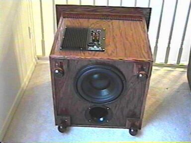

Thanks for the response guys... I had completed the sub before your posts. :(
I hope I don't have any problems with the downfiring position.

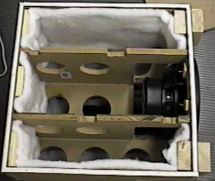

I do have another question... How much stuffing (if any) should I fill the enclosure with?????
I lined the inside surfaces with 1" poly .
I had closed the box with no insulation on the inside surfaces and fired it up. Sounded pretty bad. After adding the layer of poly , it sounded much better.
Should I add additional polyfill stuffing to the box?

No photos????
I tried but can't seem to get the photos to post?

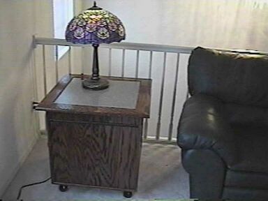

OK, cool! COOL! COOL! Right now for my cheap, just get it to work HT in the basement I have: Two Technics SB-2822s with the mid and tweet disabled so the sub is working the bass, however, crossing over at 1600Hz. What the hell? Oh yeah, the weak mid-range needs help up there anyway. So....those cabinets are hiding under some glass-top tables with lamps on them...hmmm?? Hows about making the sub like yours?? Yes!
Thank you for your kind words Mr. Kelticwizard.

Your sub is in a rather odd position, next to a stairwell. For measurement puposes, maybe you can move it to a larger room with a floor all around it. Keep the sub where you want of course, (it's your house, LOL), but whatever measurements you might make with the sub in that position are likely to be somewhat off.

Again, great job!! It is one snazzy sub/endtable!!
Stuffing is 1" polyfill sheets on the walls and about 1lb. of polyfill
pillow type stuffing to fill the enclosure.

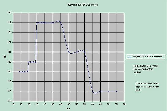

Also , if I apply the Radio Shack SPL meter correction factor from Eric Bush and Dave Clark and others (ref. PSACS Sound Bytes articles) then the graph looks pretty flat from 40 hz. down to 25 hz. then drops to 2 db at 20 and 2.5 db at 16hz.
Correction numbers used are as follows:
" These are corrections, they are to be added to the meter readout for the correct response in dB SPL."
10Hz +20.5

As you can see, the correction #''s are pretty large at the lower freq's.
I measured the levels at about 2" from the port . Actual DB's read by meter were from 108 to 120.
Am I way off track here??
Chris

The best way to measure the output from the port is to put the mic/SPL meter directly in front of it, flush with the front of the box. The power does not have to be anywhere near full-in fact, less than a watt will be fine. The curve does not change with additional power. Only the volume goes up with additional power. The curve-the relative volume between different frequencies-will remain the same. So a nice small tone is all you need.
A ported box should not be filled with loose stuffing. That is for closed boxes only. A ported box depends on the free flow interchange between the air in the enclosure and the port-no obstructions. You could line the walls of the enclosure with some more polyfill if you want, though. In a large enclosure, one inch or two inches doesn't much matter-as long as the main interior area of the enclosure is free and clear.
This does not apply to a transmission line enclosure, which is an enclosure type that also has significant output from an opening in the box. Those are stuffed. However, the transmission line works on very different principles from a ported, or bass reflex, box, which is what you have.
PS: Nice bracing job!
Bracing...Whew!
I think there were 18 of those 4" holes to cut out in the braces. Thank goodness for "RotoZip" , only broke 1 bit and it was my fault.

These are the graphs I made from the test....
