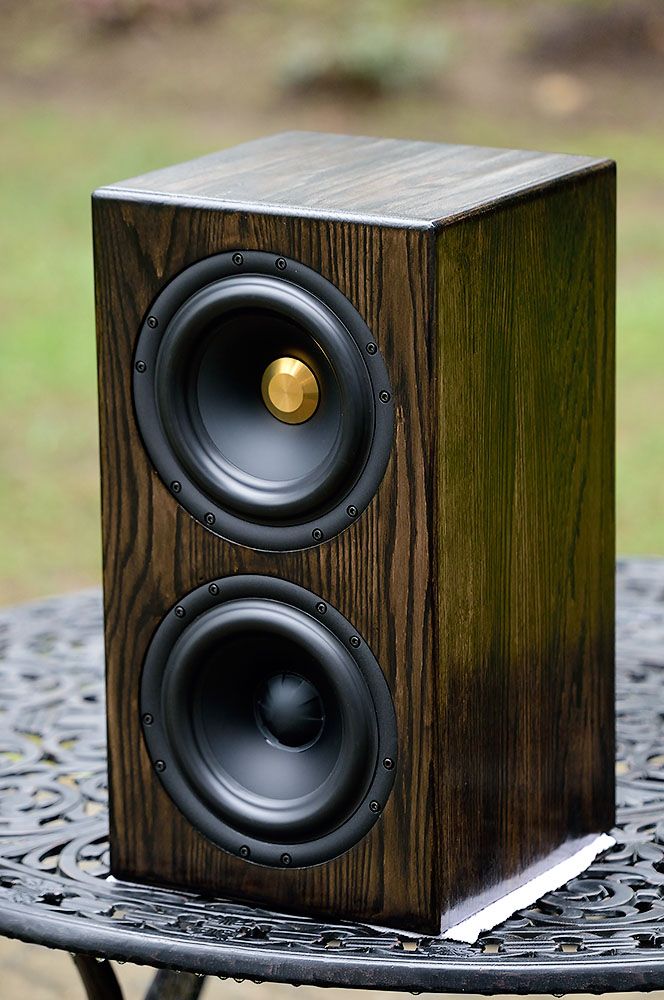

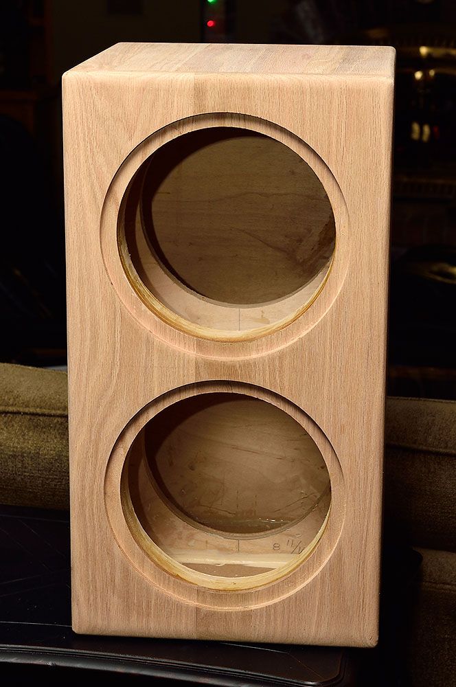

I thought of the Scan-Speak 23W since I'm building a pair of 32W's. It also pushes your budget of a few, up 25%.
I used it in a 1 cubic foot enclosure along with its' matching passive radiator for a small music system and love it. It is more than fine without the passive and that adds a bit of cost, I just wanted to try it.
ScanSpeak Revelator 23W/4557T-02, 9" Aluminum Cone Subwoofer
One cubic foot sealed has an F3 of 33Hz.
