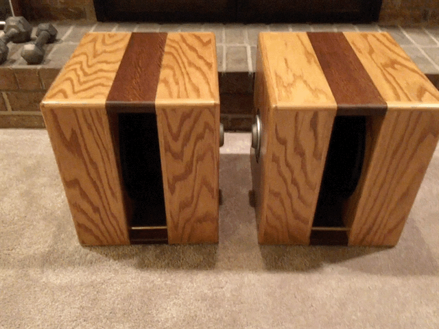

Thanks... it's my special stain mix for oak: Natural oil stain tinted with powdered turmeric root 🙂

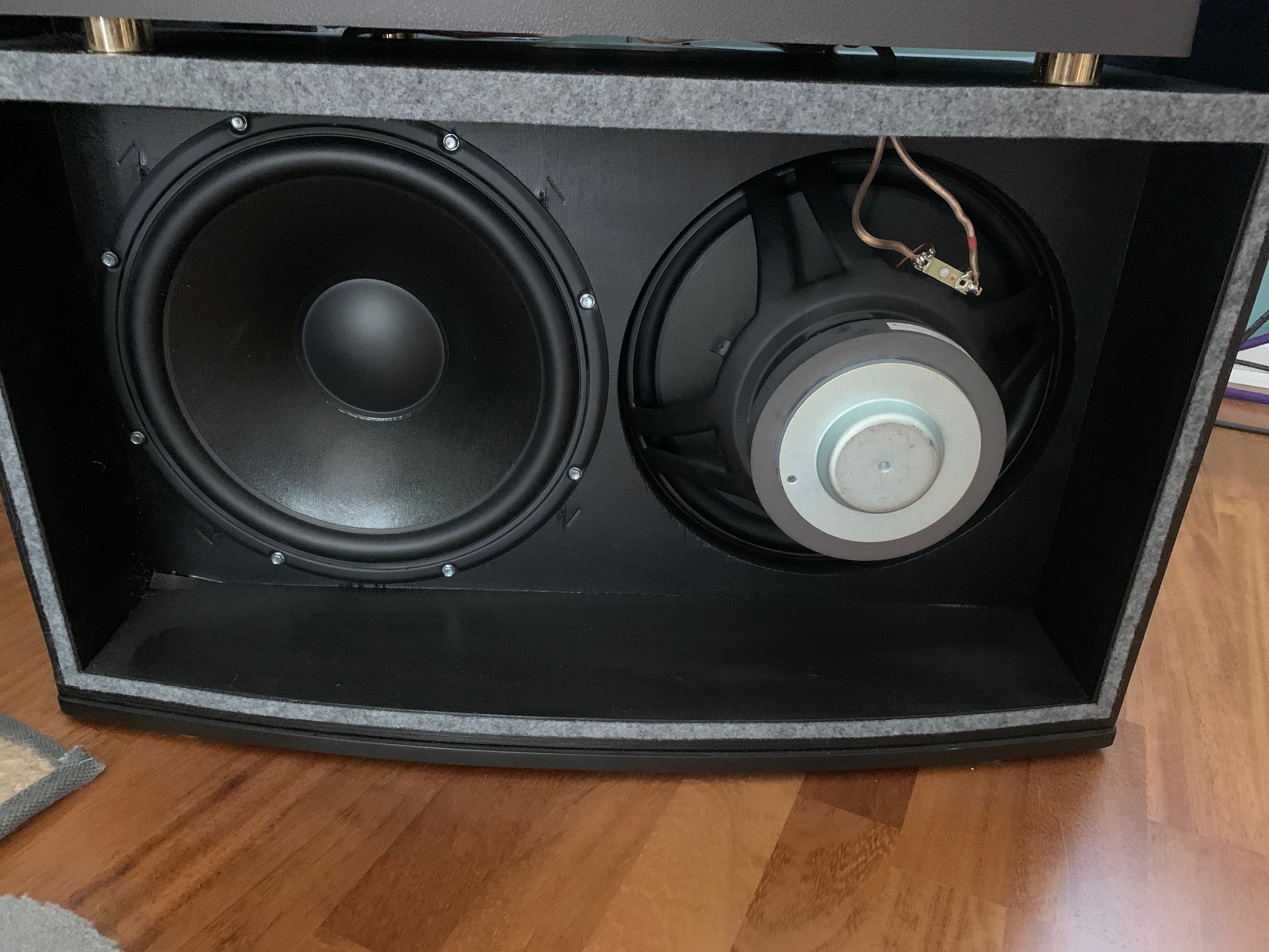

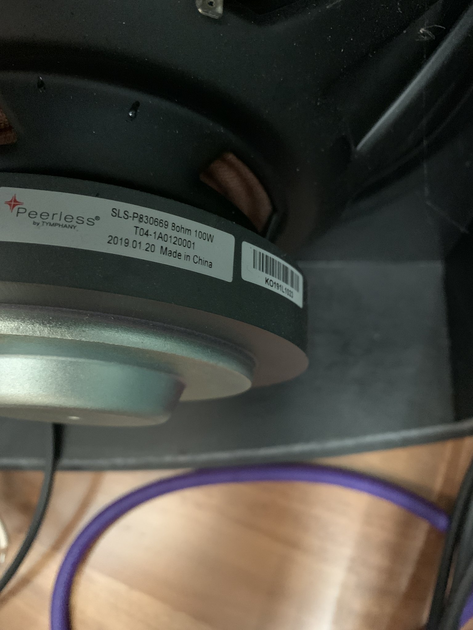

FWIW, I changed all the drivers in my Gradients for Peerless SLS - 830669, as these were cost effective and I couldn't find anyone to re foam the originals. Their mounting hole footprint was different. There were also slightly deeper than the originals and fouled the grilles, so I removed these - see photo. Official replacements for the originals are also obsolete, The Contrapunt (?) Dipole site has some other replacements listed. There was also a guy (on here, I think) who did quite a bit of work sourcing suitable replacements - I got these from his suggestions.I am currently using the Gradient SW63 with the Quad ESL. The woofers are tired and the XO unit is getting noisy. I began looking at re-driver'ing the Gradient but then started considering other possibilities. Surely in the past 30 years there are better approaches that I can put four new drivers into.

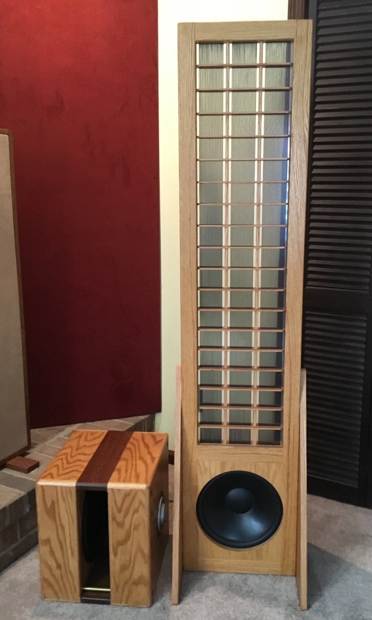

The Gradient kept up well with the Quad. I have another set of subs, the Dayton RSS315, which put out plenty, but just don't sync with the speed of the Quad. And they start to drop fast after 40HzView attachment 1099889View attachment 1099890.
I like the concept of the dipole and have been looking at a number of H, W, Z, V etc. configurations. The Linkwitz design for his LX521 seems to have some interesting advantages but I'd really prefer to avoid the active equalization.
In the end, I'm open to whatever the best solution is- I'm not married to any particular approach.

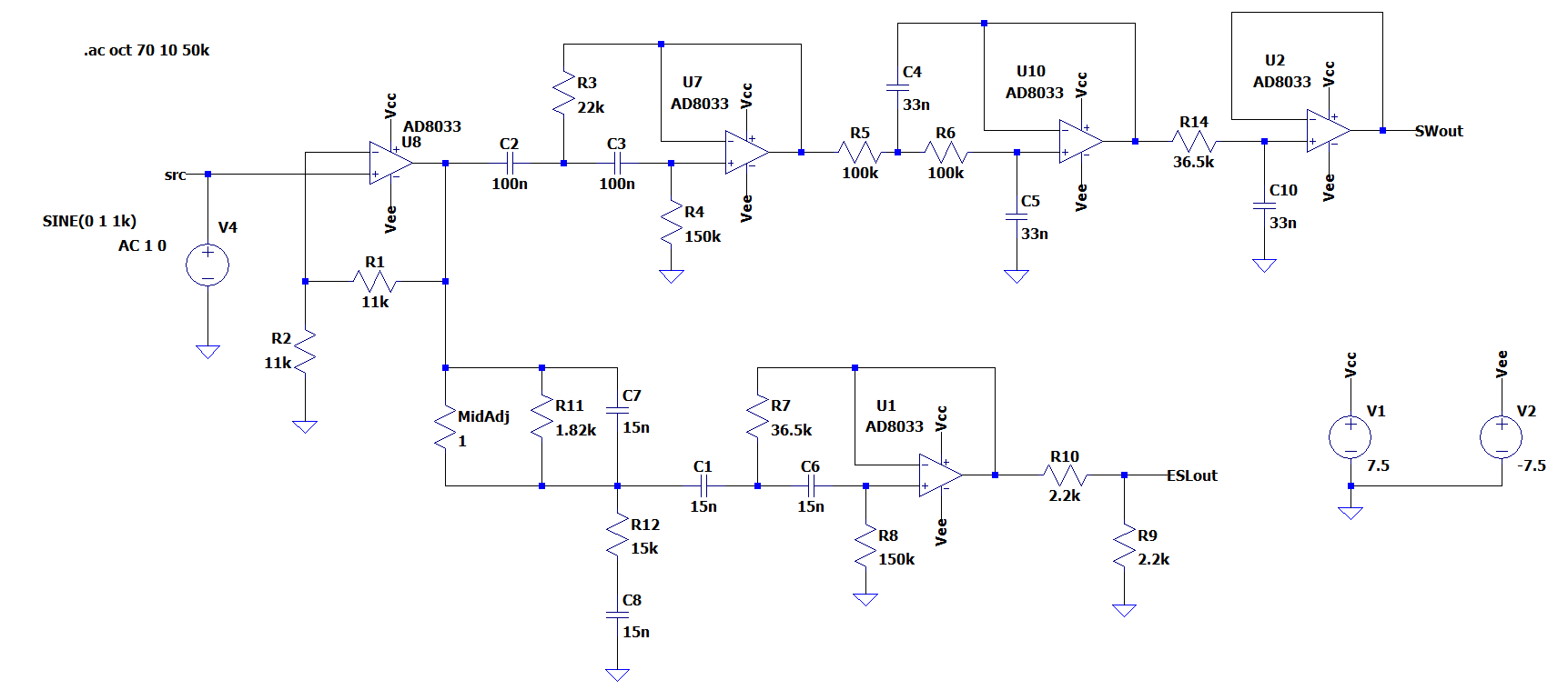

Hi Jan,
I have made this. It's not complete. Let me know if you need more. I have pictures of the PCB which I reversed.

Excellent - thank you Mogens! Is there a more readable version of the graphs?
I plan to implement it in DSP.
Which part is not complete?

Hi Jan,
I only drew one channel and so on. I have the Kicad project if you can read that. I made the curves using LTSpice so I should have that asc-file somewhere. Let me have a look and I will get back to you.

I'm not using KiCad, but that's OK, I can read the schematic.
The LTspice .asc would be very welcome.
I can then match those curves with the DSP curves.

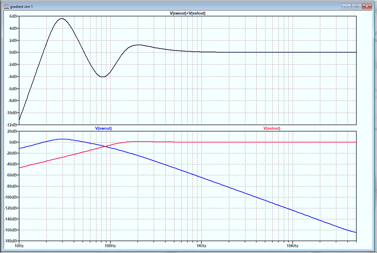

Mogens, if I can bother you one more time, I entered the circuit in LTspice but I get a weird response.
Unfortunately I cannot read the graphs on your schematic.
Could you please take a look, did I f*ck up?

Well, it could just as well be me who has made an error in the LTspice sim or even the schematic. So please be aware.

Hi Jan,
It seems I have made an mistake in my schematic. C11 in my schematic, C5 in your LTspice file should be 15n.
