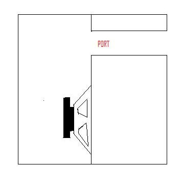

I want some help regarding subwoofer enclosure design. I have listened many type of subwoofers with different enclosures but with the following type,(image attached, perhaps fourth order) of enclosure, I felt the best bass response(according to my taste).I have this subwoofer but with very little power & little subwoofer (i.e. 18 watts rms with 100mm sub ),now I want to make it in a big configuration, like with 12 ,15 or even 18 inch sub with 200-500watt rms power.I know that there are many software’s available on net for speaker designing but my problem is that in my place I cannot buy any specific brand sub speaker with specific parameter(due to absolute non availability of branded speakers). I am totally dependent upon local made speakers. Here a lot of shops/manufacturers make sub speakers but for them parameters means size of cone, size of magnet, type of cone(fibre or paper) and handling power(that too approx 😱😱) and with these data I cannot design a enclosure.
Friends , I want to know that is it possible to make a sub enclosures mentioned above with available data ? of course the most true data from my manufacturer is its size and nothing😱😱😱😱😱.
Kindly give your valuable comments since I want to make a really big & powerful sub. Friends from India are kindly invited because they are familiar with these conditions.

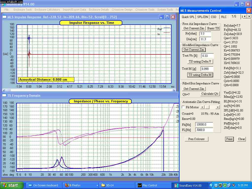

hi sudhir,
first select a driver and buy it.measure its ts parameters.most of the drivers
have very high qts, qes vas and very low ebp .i have tested many of them locally available in lajpat rai market delhi.most of them acquire qt,qe of ranging
from 0.90 to 1.2.i made my own drivers from locally available parts
but story remains the same.
but you will be astonished when you measure ts parameters of drivers
coming out of those sony,philip,screative and so.......
they have similar ts parameter high qt,qe,fs low ebp still they manage to produce so called bass.
it would be better first you measure frequency response of of your
4th order bandpass.then buy a driver measure ts parameter
put them in winisd better in bass box pro.and tune it closely to measured
response.
i managed to make a 18inchi driver for horn with low qt,qe high bl low fs and vas withhelp of a software .but now i ran out of money to further experiment.so everything is stopped.only the raw material costed me around3500 rs.
one of 4th order band pass drivers ts parameter attached .
regards
ravs

I already have two 12inch driver & i will start learning from these.I will try to mesure its parameters.It seems that making a good sub enlclosure is not a easy task.Is it not possbile to get a universal mesaurement for a specific type of enclosure with a known size of sub driver /🙁

dear sudhir,
what drivers are they.are they car subs.please measure their ts parameters.
after that we can discuss the design if not what is their coil size and magnet size
there's no universal box.size of box mostly depends on vas.
