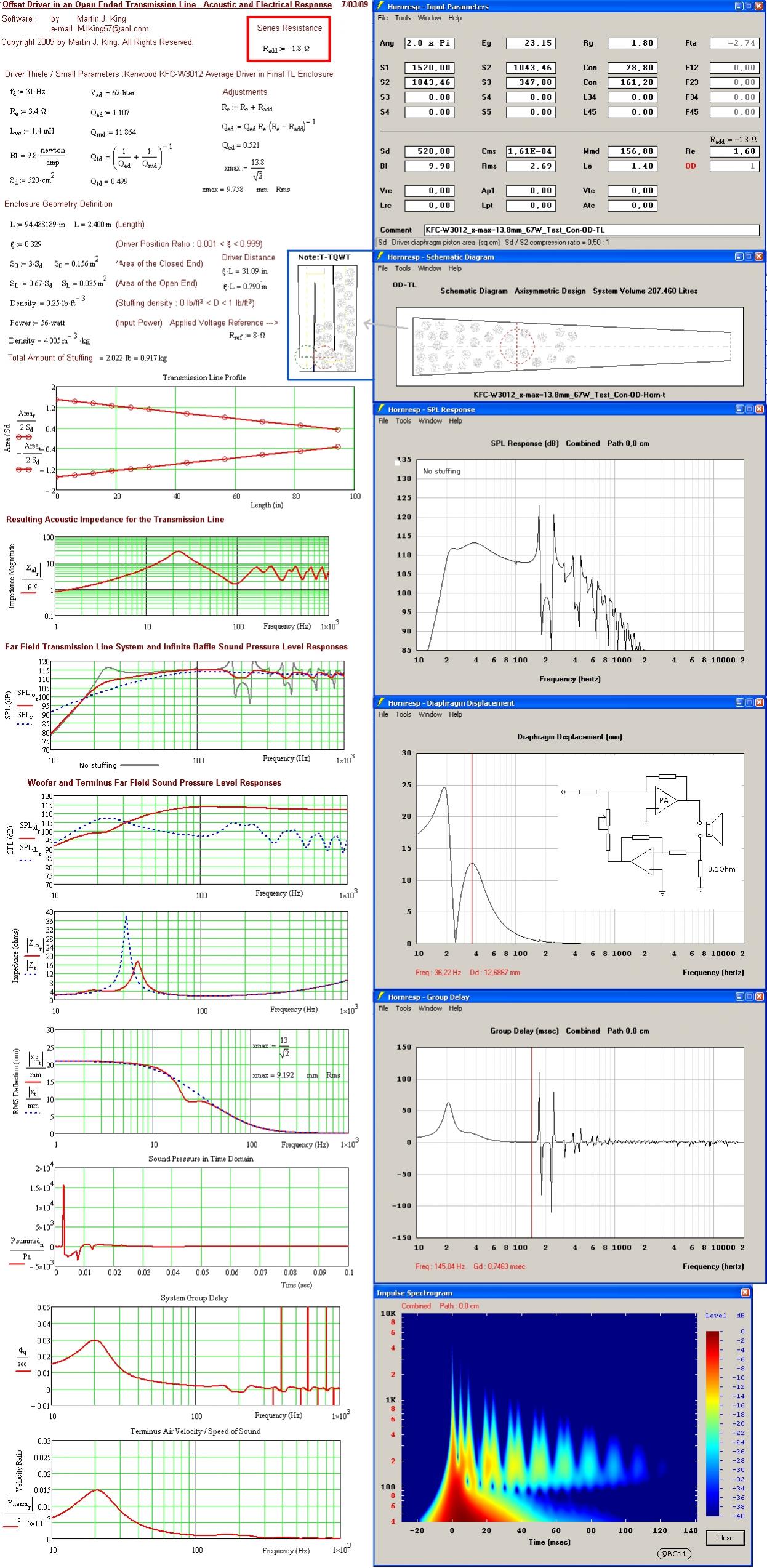

If you convert your amp to include negative resistance : See the picture where the Qts is set to ~0.5 by adding a negative resistance of -1.8 Ohm and when the box is either a OD-TL or a T-TQWT(extended BW type).
b
Not sure I follow the previous post (and can't read anything on those tiny thumbnails), but motional feedback (amp output the negative of driver impedance) sure is a great method for making sealed boxes play properly. Particularly appropriate to this speaker because it can suppress the rather high resonance but push the cone at frequencies below that resonance inherently by the design of MF.

Hi Ben,
To magnify the thumbnail: Click on the X-cross at the lower left corner.
