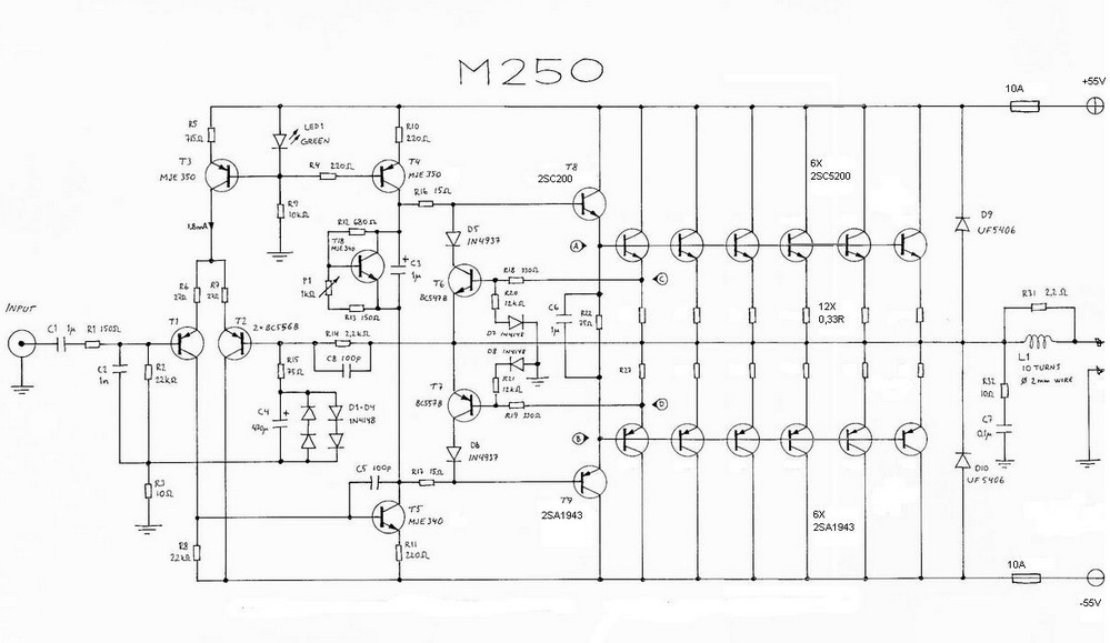

I had built some amps like this (with other output transistors).
I have idea to build amp based on Marcus schematic, what would be able to drive 2 Ohm load. Can i do it like this? I expect to get 250w into 4 ohms and 500w into 2 ohms.
Suggestions?

Those transistors are much faster than the originally specced transistors. The circuit might not be stable with them.
Using high power devices as drivers generally isn't a good idea unless you have pre-drivers to drive them. The original driver transistors specified are up to the task of driving that many pairs, so why replace them?
If you really want to use flat pack devices, use the MJL21193/4 pairs. They are similar spec to the original MJ15024/5 devices.
Maby one simple question for you: ho to calculate that mje15030/31 is enouth to drive 6 pairs? is it possible to drive 8 pairs?
MJL21193/4 pairs are 2.5 times expensiver, that 2sc5200/2sa1943 are in my country.
Change emitter resistors of power transistors to lower value, so that short circuit protection allow higher current. 0.15 Ohm should be better. 2sa1943/2sc5200 should be ok for drivers in my opinion.

P.S. 6 pairs of these output transistors is much more than enough with this power. Heatsinking is crucial.
As jaycee said, it's risky to use that much faster output devices, also if you really intend to drive 2ohms you might want the toughest devices available. These are for example the MJ15024/25.
The sc5200 has only 3A at 50v, the mj15024 has 5A.
Adams hint to change output protection is mandatory, otherwise you will never reach 500watts into 2ohm.
The mje15030/31 should do the job to drive the 6 pairs, if they are genuine. But it will be necessary to increase vas current, 6ma is too low to drive that high currents.
