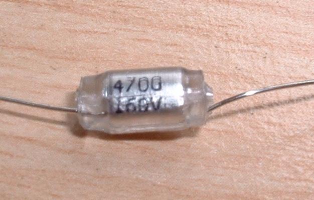

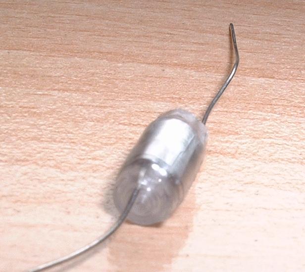

Here are mine, I just bought them
Are they genuine styroflex?

I believe these are genuine polystyrene film and foil caps, as available in GB through RS and Maplin, or in the States under the brand name of Xicon at Mouser. But I don't think there're manufactered by the holder of the Styroflex(tm) copyright.... nor is the actual construction necessarily the same.
