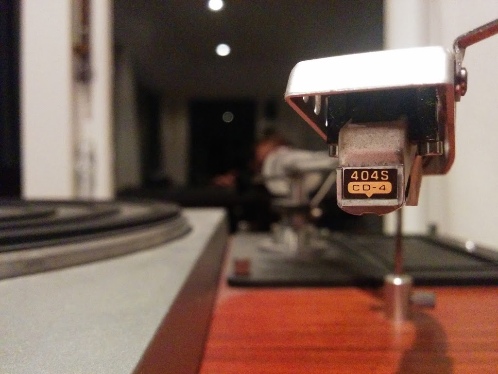

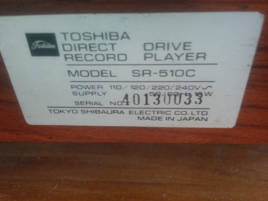

Does anyone know where I could find a replacement stylus for this cartridge (Toshiba 404s cd4) which is a quad compatible electret condenser cartridge from a Toshiba SR-510c? If you don't know but have suggestions for places to try in Tokyo, that would be appreciated as well.

No current quadrophonic use (but thinking about it). However, The electret condenser is pretty special and uses an internal step-up/eq. A MM is definitely not plug-and-play with the condenser eq. The table also has an RIAA circuit, but this doesn't seem to be working perfectly.

You sure, That looks like a P-mount quadrophonic cartridge. Nothing to do with QUAD the company in huntingdon.
To the OP: That's a P-mount, so you could go with any P-mount cart and a std phono stage IF you wanted to.
CD-4 is a discrete 4 channel quadraphonic system and uses a separate FM carrier for the rear channel modulation, playing a CD-4 recording with a conventional cartridge will wipe the carrier off the disk in short order. The other two SQ and QS are matrix based quad and used the instantaneous phase relationships between the two channels to determine what channel was being played at any given moment. The better decoders used a combination of amplitude and phase information to steer the signal to the appropriate channel. Separation was not very good.
I find it extremely difficult to believe that Acoustical Manufacturing Corp (Aka Quad) in that time frame had anything to do at all with the design and manufacture of phono cartridges sold on japanese turntables. Panasonic (Matushita) for example made a whole bunch of strain gauge based CD-4 cartridges in Japan. It would be like bringing coals to Newcastle imho.
In the 1970s in the U.S. anyway, "QUAD" was understood to refer primarily to quadraphonic sound, most non-audiophiles in here had never heard of QUAD (the company), although it is very well known and respected in audiophile circles. The cartridge in question is a CD-4 Quadraphonic cartridge, which I doubt was made by Toshiba, more likely Panasonic, AT or Denon, or perhaps one of the many more obscure makers that have existed and continue to exist in Japan to this day.

This doesn't appear to be a P-Mount cartridge and can be replaced with any standard cartridge.

I realize I can plop a standard cartridge in. It even has a standard screw-type headshell coupling. I've tried this with a Shure m97xe and a Hagerman phono stage and the sound wasn't as good as with the condenser cartridge before the stylus broke. This is my rationale for trying to replace the 404s. I want to relegate replacing the whole signal chain to last resort.
