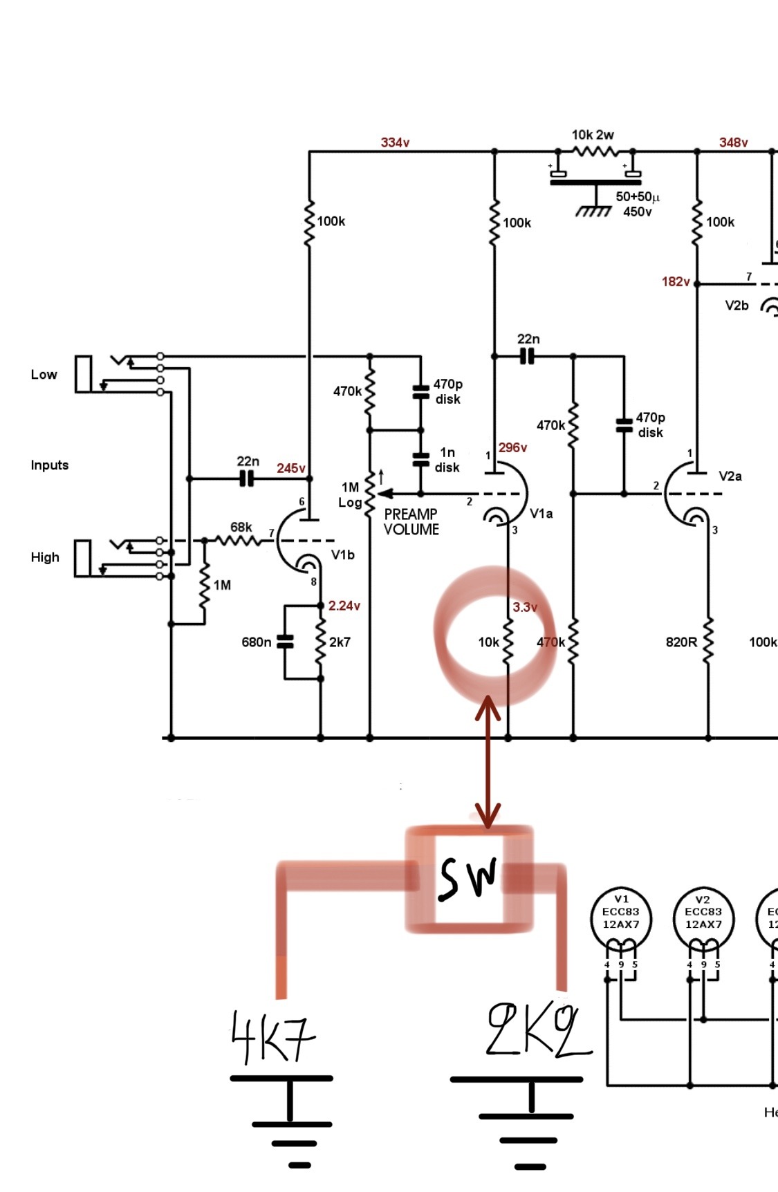

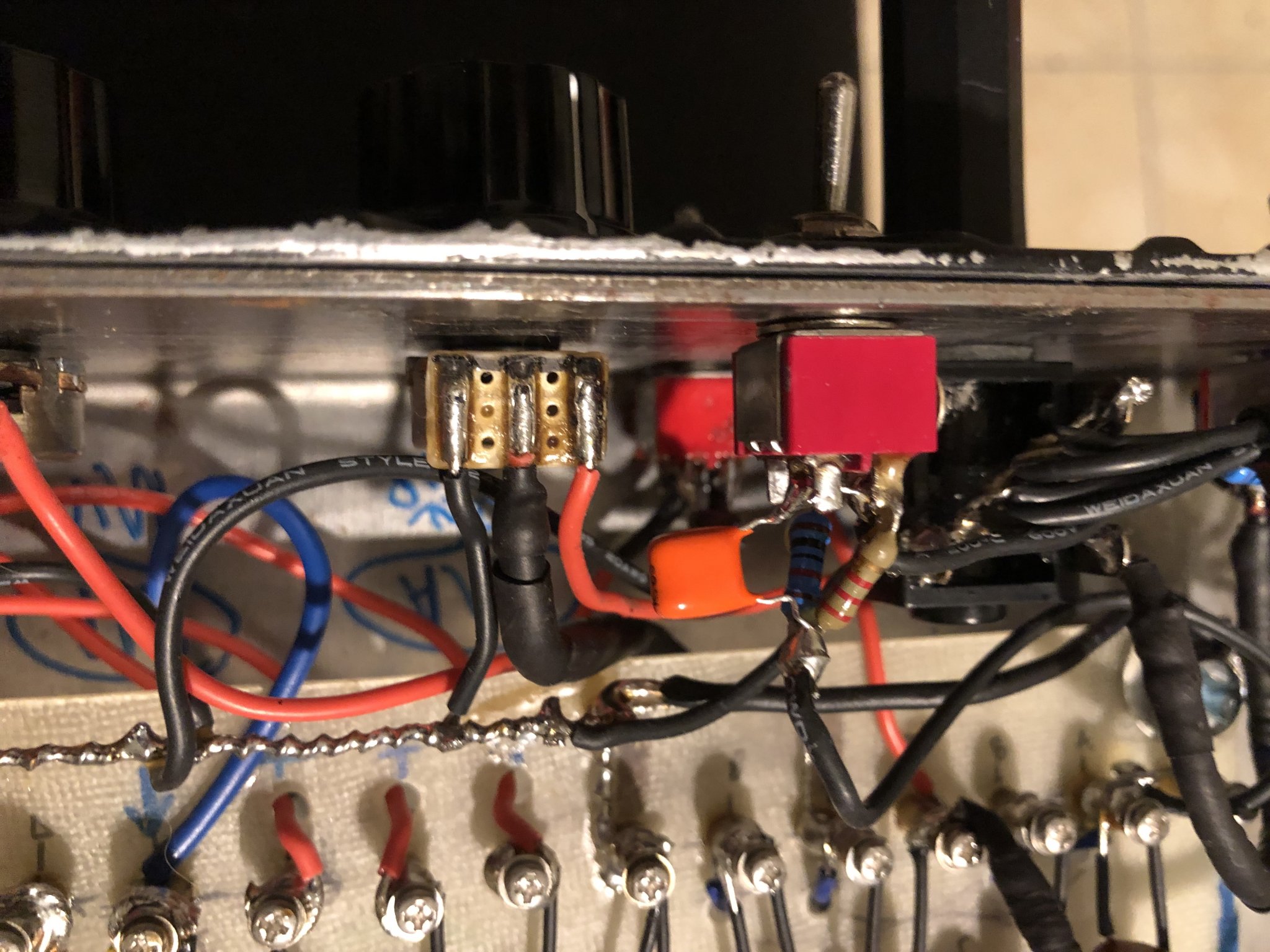

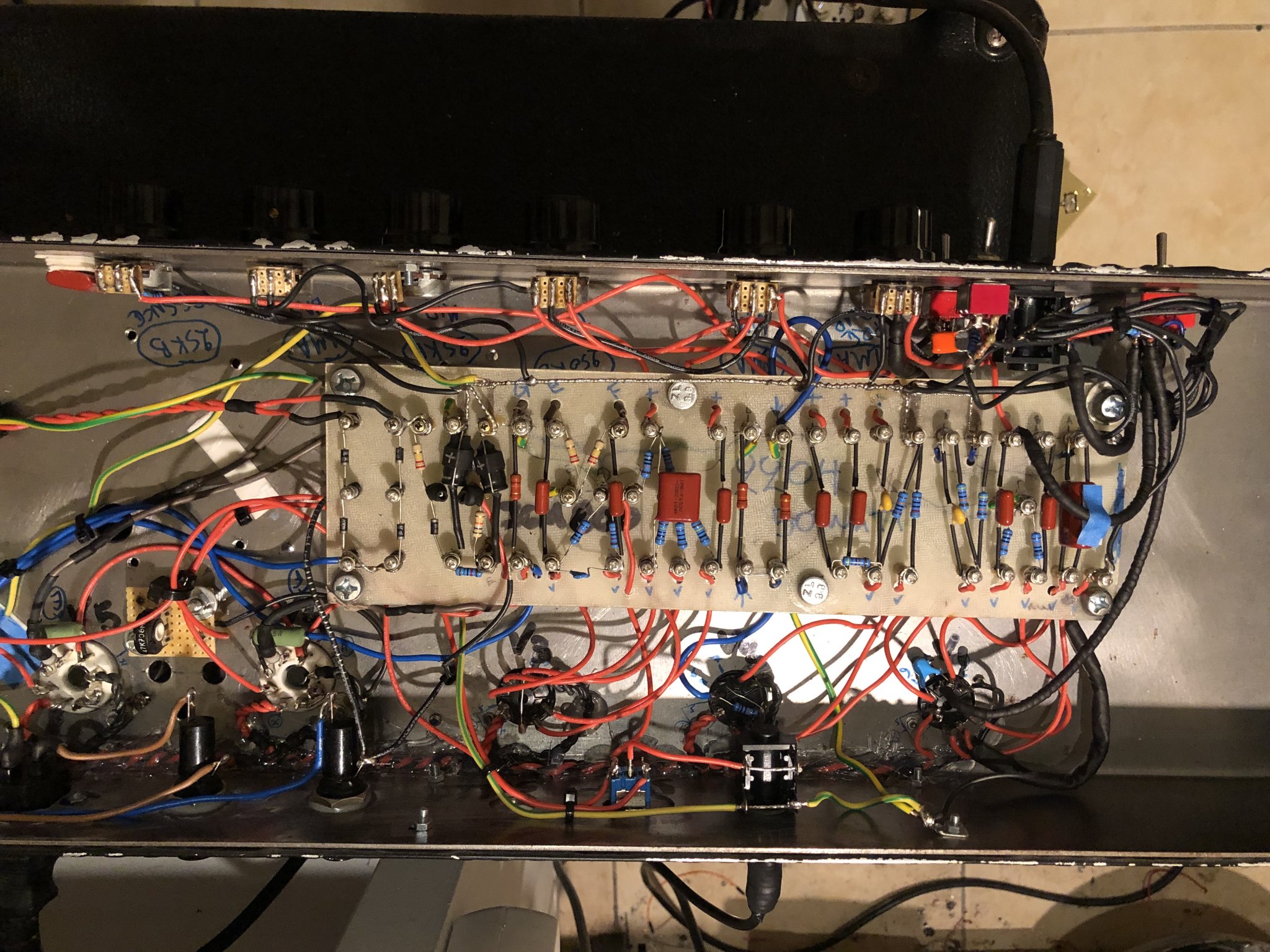

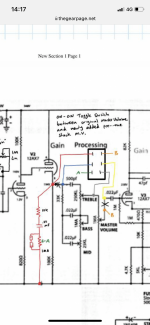

A new and I think the last update … first of all I’ll try the 39k cold clipper cathode and it really horrible for me .. so I put on the cold clipper switch the 10k ( as the same of Marshall ) and 2k2 for “extreme”gain … + I place and 470NF bypass cap to cold clipper and the amp pumps crazy gain ..also I have the saturate switch where it is very useful … I testing tomorrow with master volume on 5-6 to see final results … thanx everybody again
