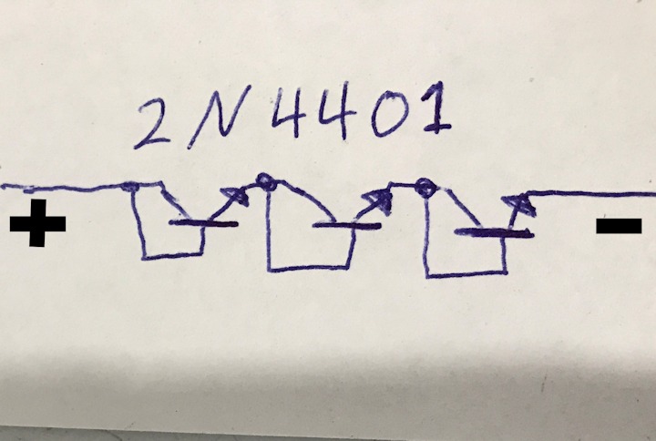

3x2N4401 - yes, it certainly is a interesting solution.

I am not sure if i’d be using internal tooth lock washer type solder lug vs a regular flat tinned copper solder lug which has more contact area
But as long as the mmbt4401 Vbe is similar to a stv that’s all that really matter.
The bias generators using stv usually have a small adjustment range.
Many time folks change the silicon in the output stage which changes the required bias generators min,max, even using the original stv do not provide the proper adjustment range.

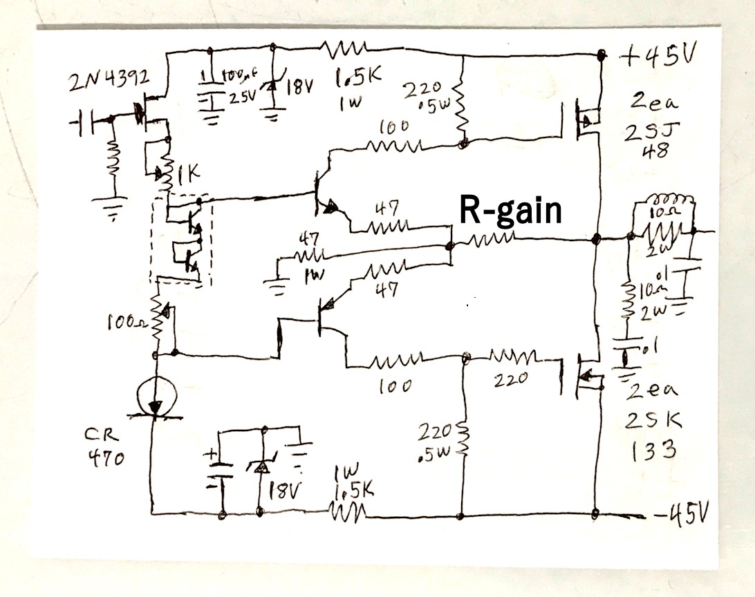

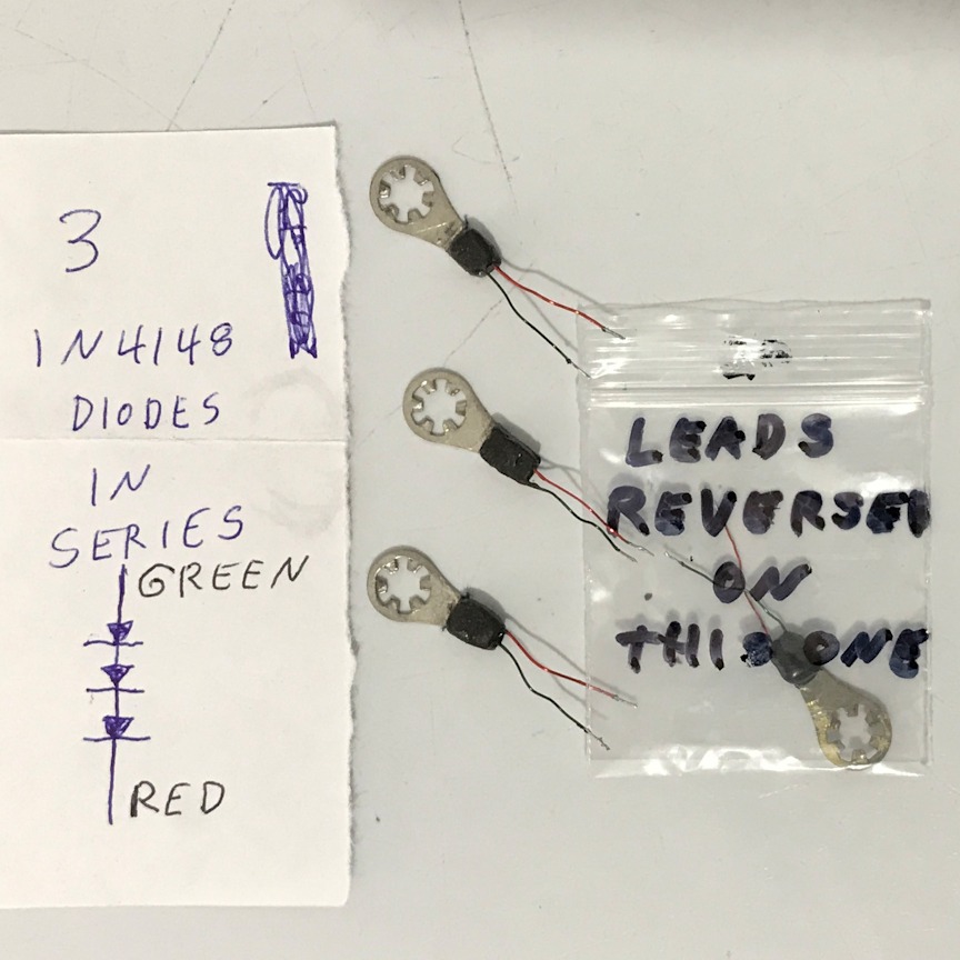

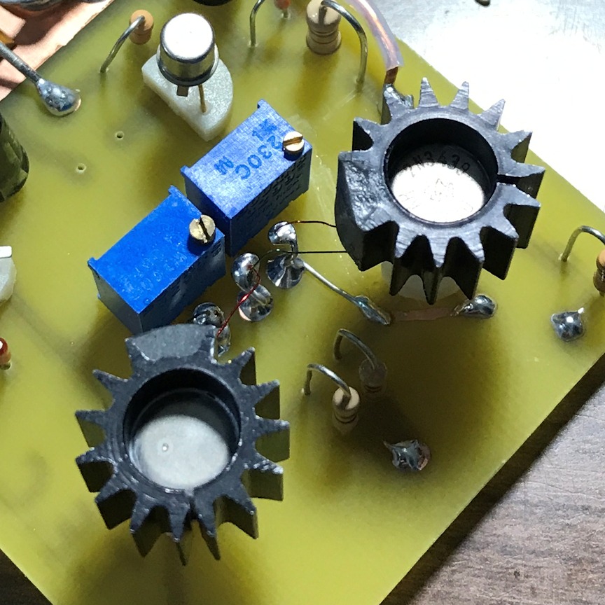

I already went to that thread and got bad response, basically run off, so thought I would try this. Yes, the flat lugs would be better. I didn't have any so just flatened the toothed ones and put some Silicon grease on the end. The thing is that the change in temperature is slow, so just about anything would work as long as connecting wires are quite small, and a good flat head screw. Here is photo of the latest amp part I used the idea, and they track perfectly, and it is a very common cheap transistor. I epoxied them to the heat sinks making sure insulated from them. one on each of them. Outputs are Lateral FETs which don't seem to need any compensation.
