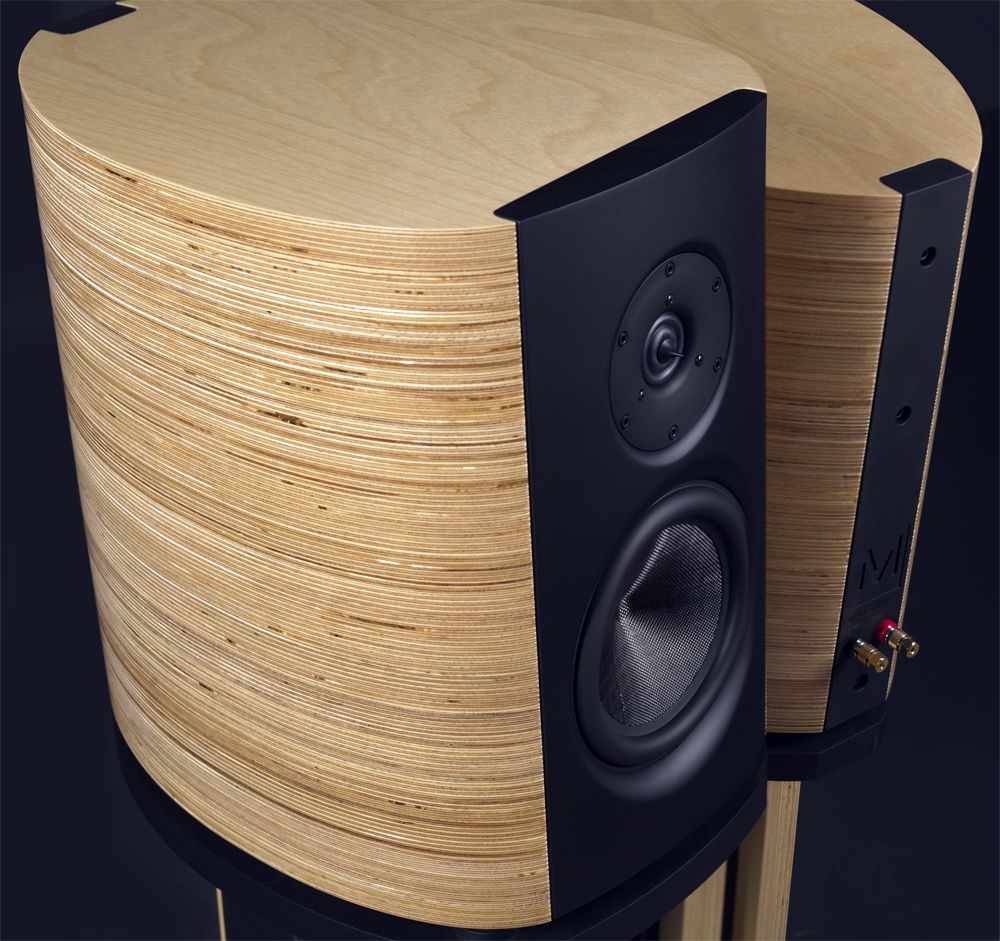

There are a number of designs out there using a stacking technique to get curved boxes, some even try to get a profiled inner surface to cut down on standing waves (debatable benefit given the length ratios involved).

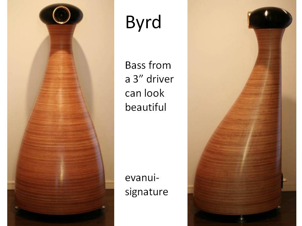

There are also nautilus shell type designs, glue a stack of ply together to give yourself a say 5” stack the mill out a nautilus shape for a full range driver e.g. alpair 10ms. Then repeat, stick together and fill to taste.
LoudSnail – Milling of the woofer enclosure parts finished | Crazy Audio
There are also a few transmission line and horn speakers made from stacked ply.

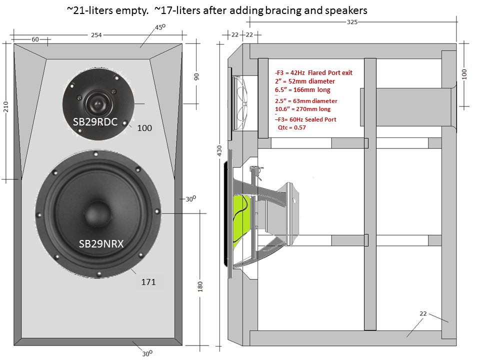

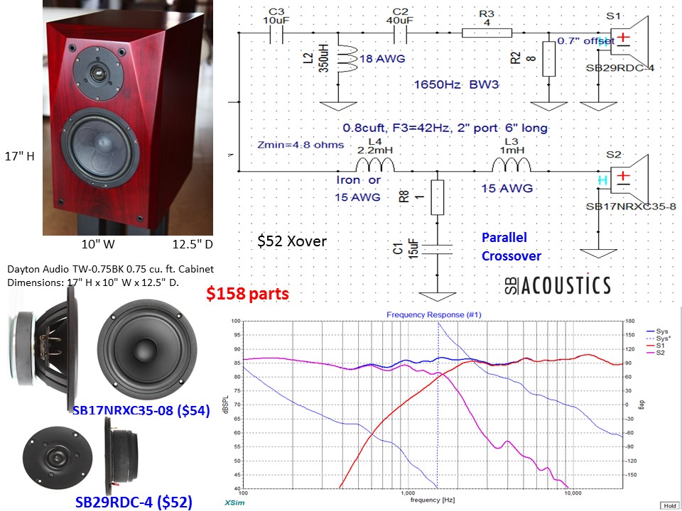

If the speakers are to be placed against a wall and to have a complex cabinet then something like a modern version of the Daline speaker might be an interesting option. That is, a wide shallow 2 way speaker using a 1" tweeter with a 5" or 6.5" midwoofer loaded by a chamber plus a long folded line. This is a picture of a variation but a brief google didn't find a link to the wireless world articles which I downloaded off the internet and possess somewhere. The downside (or upside depending on how you look at it) is that the speaker would need to be designed and I am not sure how well existing software would handle the chamber + line. Anyone?
You could build a modest complexity cabinet design like Troels Illuminator with SB_Acoustics drivers. The 6.5" midwoofer will deliver -F3 = 40Hz plus room gain.

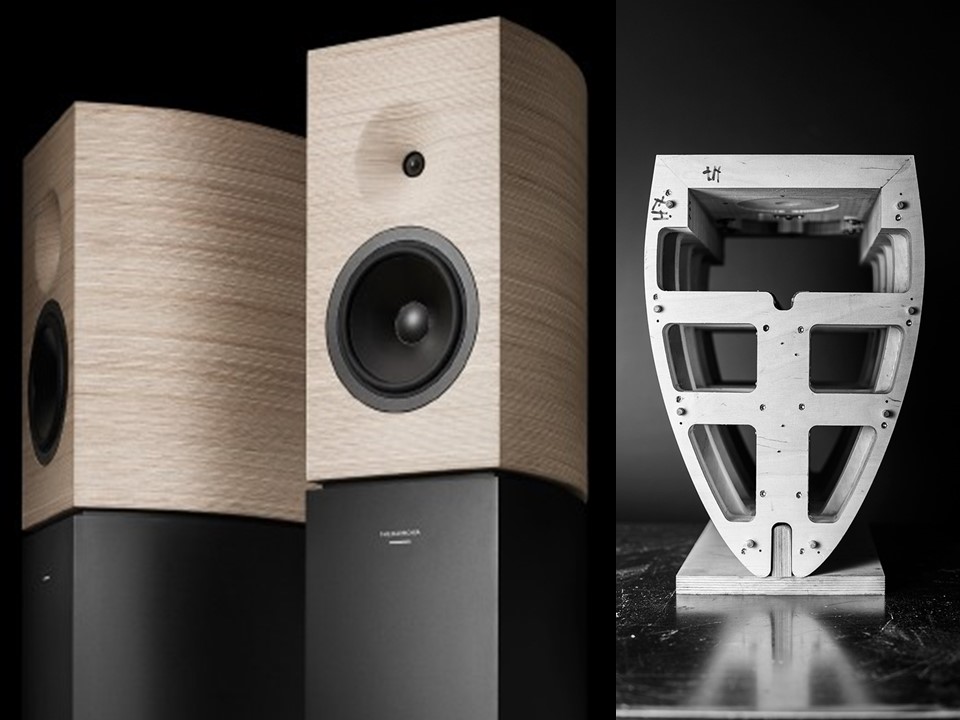

LATER.... you could work with your class to design a high value, high complexity, Artistic TransLam cabinet.
TransLam construction can provide several benefits -
=reduced edge diffraction
=functional internal bracing
=constructing a tapered volume behind the speaker to reduce resonances
=integrated waveguide
=ARTISTIC

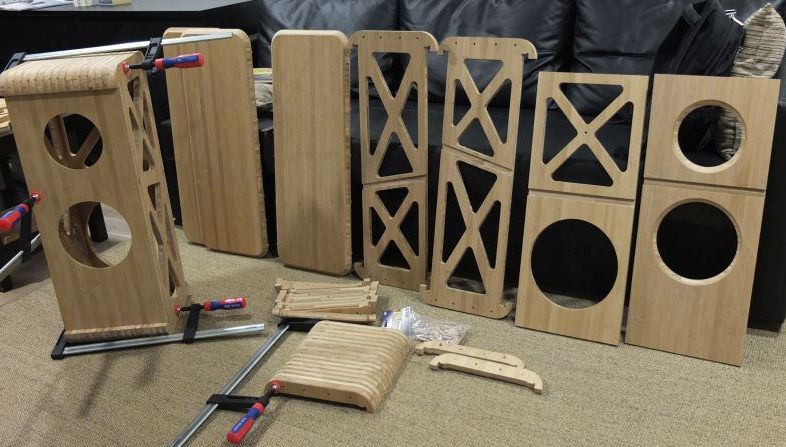

My version of Jon Marsh's Minerva monitors used quite a lot of CNC techniques...
Full photo album is here for possible inspiration on some aspects.
Not the most complex one can take this for sure, but this one is still looking as good 1,5 years later as it did when I finished it... My first attempt at stacked set of MDF layers 10 years ago did not share the same good faith.

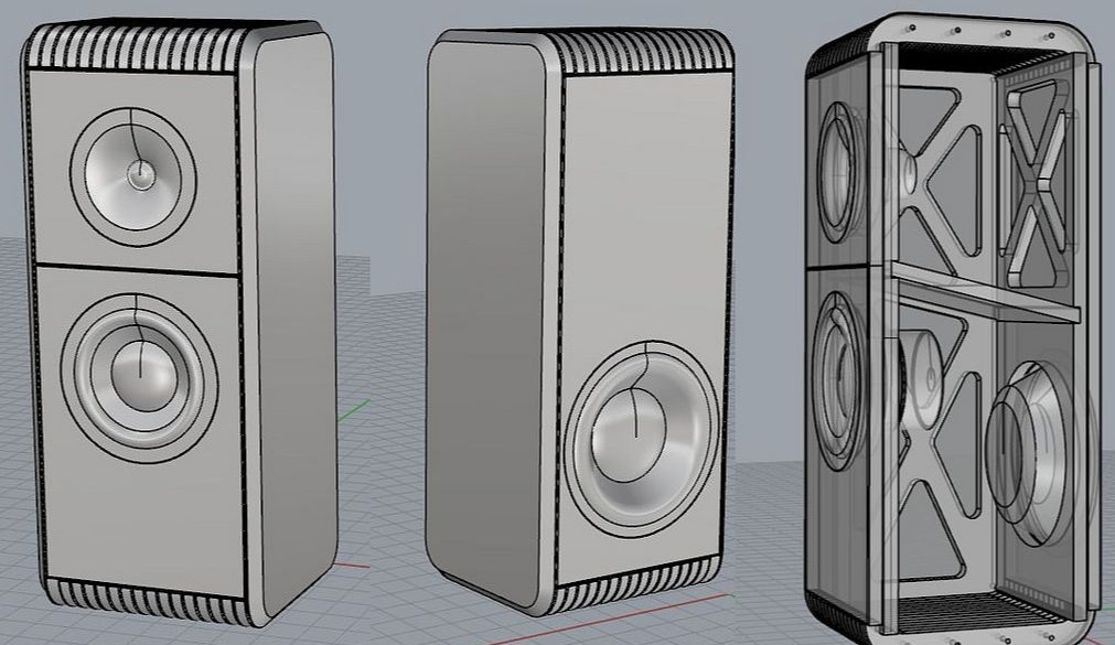

As for the hypercube speakers, Rhombic Dodecahedrons are almost trivial to do with the CNC router and a 60degree bit, and I actually just build a variable bevel angle crosscut sled for our bandsaw, so the square truncation shouldn't be difficult either. I have a crappy pair of drivers laying around and I might throw together a prototype in the next few days if I can find the time. As for decent drivers, I imagine something like a 4" midrange? I have an active subwoofer for bass so I don't need to go too low. Maybe I should try the hyperFAST design?

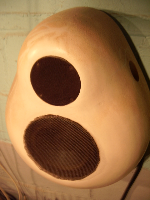

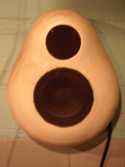

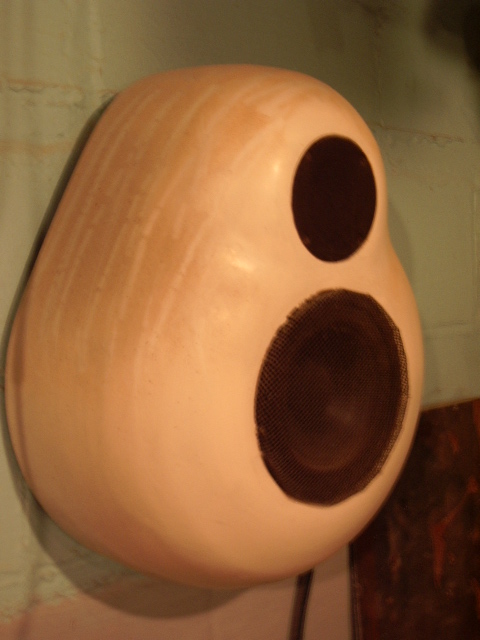

Beautiful, Voluptuous cabinet.
Do you still have finger prints after all the sanding?
What drivers and crossover slopes did you use?
Ikeda wooden bowls have been used to get low diffraction "music of the spheres".
