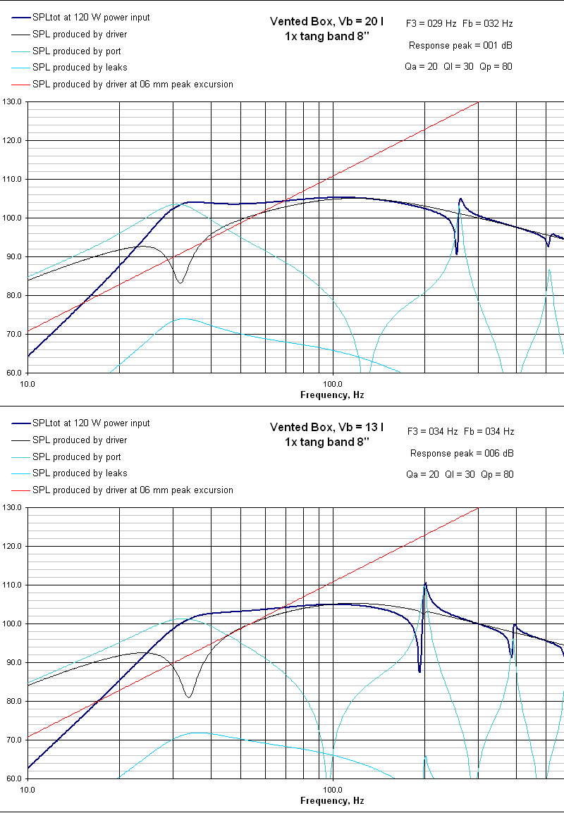

Try 20L box 8cm ID port Fb 31.72Hz (that results in approx 65cm port and the freq response when port resonance is taken into effect is much smoother! Sorry I'm a metric person, and didn't take the time to work out the box volume to be the same, just went with what unibox came up with (12.6L) and played a bit and came up with 20L.......
I modeled it with .5 ohm series resistance in Unibox.
Tony.

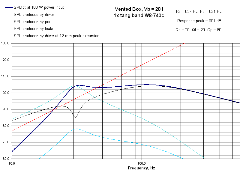

Here is the Tangband in a 28 liter box with 31 Hz tuning. Power into 4 ohms is 100 watts.
The green line is the SPL
The purple line is the cone excursion.
The red line is the impedance.
As you can see, the dip is at the point where impedance is high, hence actual power is low. So if you want to add a little extra voltage to the gainclone, you can easily make an equalizer circuit that will not use up power. The dip is easily correctable.

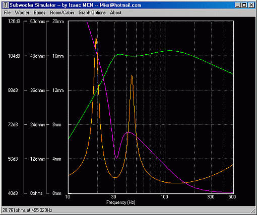

This graph is made by Subwoofer Simulator, a fine freeware written by our own member, F4ier.

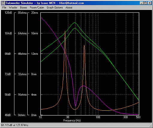

Increasing both volume and sensitivity is the 4th Order Bandpass.
Though it looks like it has a sharp peak, this should blend in with a midbass enclosure with an F6 of 55 Hz or so. Highly possible with a 5" vented mid.
Sensitivity is increased by 4 dB, from 84dB to 88 dB.
As before, this is the graph that assumes a drive wattage of 100 watts.
This time, I added room gain. The upper green line is the output with average room gain. The lower green line is the output without room gain.
The upper green line is the SPL with room gain.
The lower green line is the SPL withoutroom gain.
The box measurements are:
Vented chamber: 20 liters
Sealed chamber: 30 liters
Tuning frequency: 40 Hz.
Notice the cone excursion only goes into nonlinear range beneath the passband, and can be controlled by a filter, possibly the one on the sub amp.

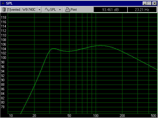

Just to illustrate there seems to be pretty much consensus between programs as regards calculation algorithm. Here's a vented SPL graph from WinISD Pro with identical box size, tuning & input wattage settings as done by kelticwizard in Subwoofer Simulator. For the record, when I input Tony's settings into WinISD Pro I get pretty close to the same response graph as he also. I must say I do like the way Subwoofer Simulator & Unibox can show the plots for different parameters such as SPL/cone excursion/impedance simultaneous in one graph. Makes convenient for posting results of all parameters. WinISD as yet can't do that. Must page through the different graphs, though it can show multiple alignments with different speakers & boxes simultaneous in one graph for easy comparison.
I could get close but not quite the same with Unibox. Had to play with the fill and leaks, and take out the port resonance to get close.
I like the range of graphs available in Unibox, but it doesn't have a all in one graph like Stephen mentioned.
One thing I will say though, I was wondering why I had a bit of a dip at 500Hz when I measured (crudely) my existing speakers (originally modeled in SW, or boxplot can't remember which). When I modeled in Unibox, there was a response dip which was almost identical to the one I was getting in real life. The other modeling programs I had used showed it being flat.
Tony.
Tony.
Interesting.
I was noticing in those 1st graphs you put up, the 2 sharp
narrow band high Q notchess in the upper pass band (just above the hump, in the range where the VC inductance shows up as the typical sloping roll off above mid bass).
What parameter is it that Unibox is deriving that from? Port resonance/Q...? I've never seen anything like that in WinISD & I don't see it in your last graph so I assume it's a legitimate function of some parameter that Unibox is picking up on & making a prediction on. Has to be one of the user definable parameters you tweaked out on the last graph. Port resonance would be my guess since the second dip appears to be a harmonic of the 1st. I may just have to try that program out, but I hate having to load Excel back on my puter. Downloaded Subwoofer Simulator today but haven't given it a whirl yet. I wish one of these freeware would add simulation for dual chambered reflex. LSPcad does but it cost $, though not outrageously much. I really admire & appreciate those that can develop programs like these.... & to offer it up free... makes me feel like a kid turned loose in a toy store!
Yep it is port resonance, there is a tick box so you can add it in or leave it out. The last graph I took it out so that it matched closer to the winisd and subwoofer simulator.
It's interesting to note the effect that port diameter has on it too! The peak (due to port resonance) when I modeled the 6' port was something to behold 🙂. Gives you something else (for better or worse) to worry about when modelling 🙂, but I guess its good to find out about it before you have started, rather than after you have finished!
