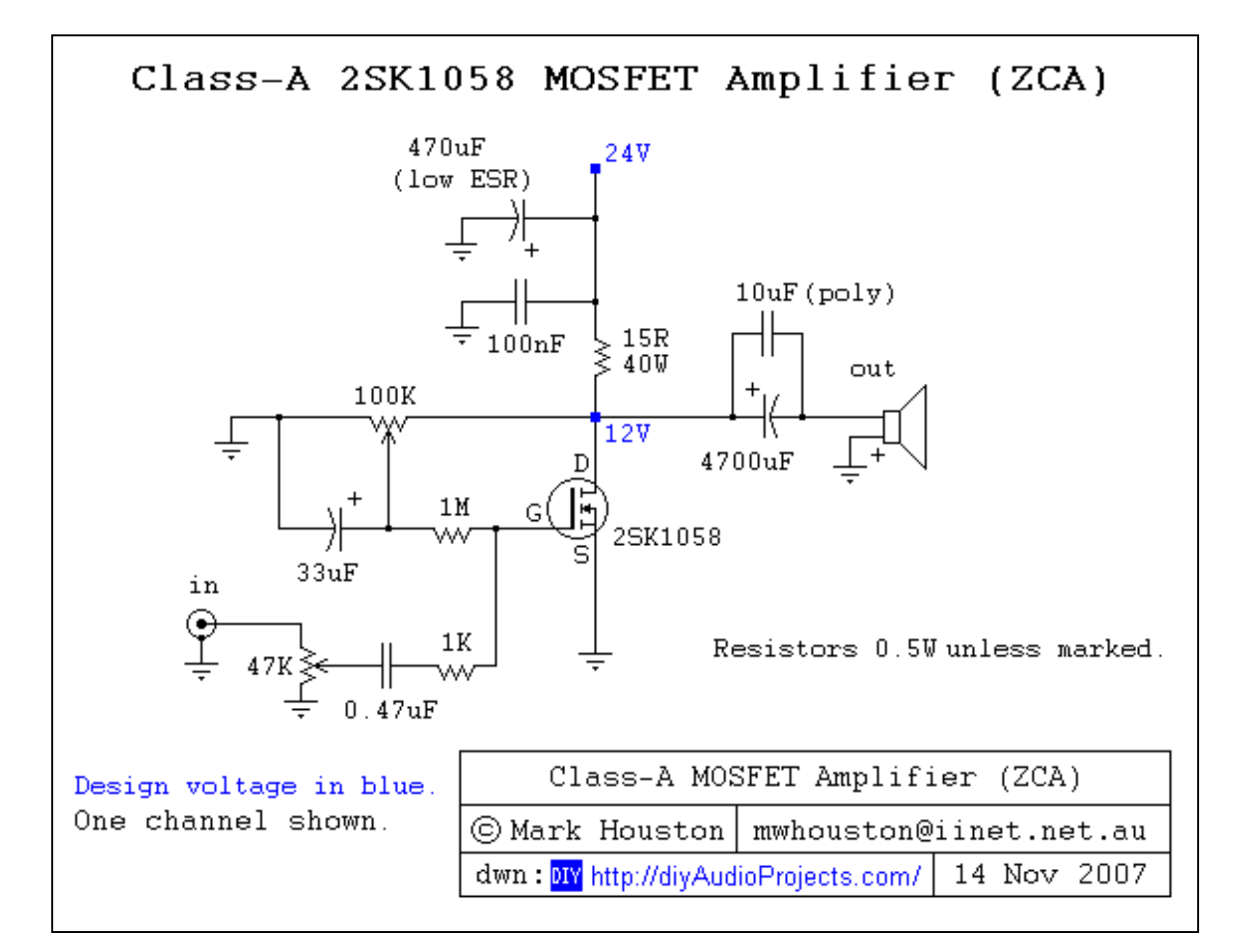

I am building the below amplifier. I have it done with the exception of hooking up a speaker. I measured from the point where the speaker connects to the cap and ground and I have 12vdc on my meter. Shouldn't the caps block the dc voltage? So why do I have 12 vdc there?
I am building the below amplifier. I have it done with the exception of hooking up a speaker. I measured from the point where the speaker connects to the cap and ground and I have 12vdc on my meter. Shouldn't the caps block the dc voltage? So why do I have 12 vdc there? View attachment 1289752
Leakage current through the capacitors causes the voltage to appear across the speaker terminals. If there is a DC voltage across a speaker connected to the stage, then I would deem the coupling caps as bad, since that much leakage current is defectively excessive. Under no load conditions, then a DC voltage could well occur across the terminals, but the current causing it to appear would be minuscule, not enough to disturb a speaker.

This is close to the ZV (ZEN variation, "Zen-lightenment" from Mr. Nelson Pass) from fig. 5 under

Highest sonic performance is only guaranteed when using high-quality components (this is particularly important with electrolytics) and the use of a choke coil.
