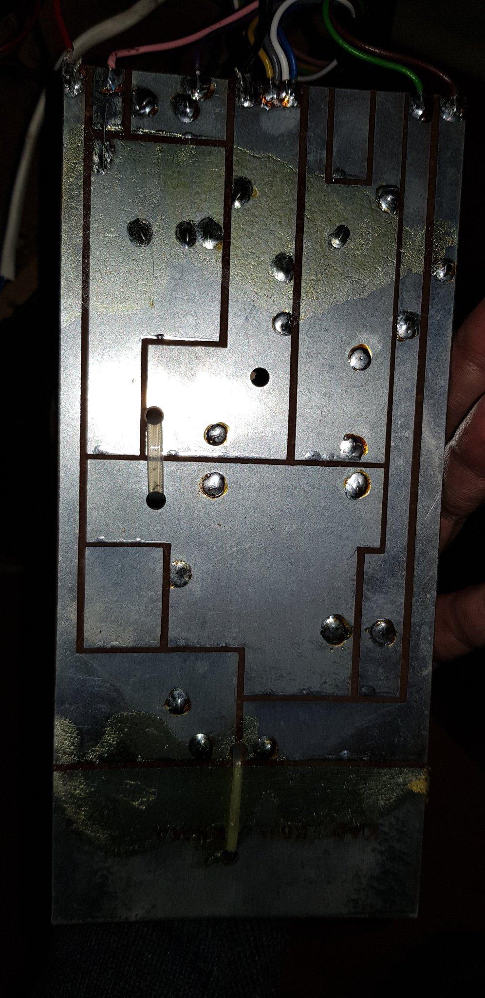

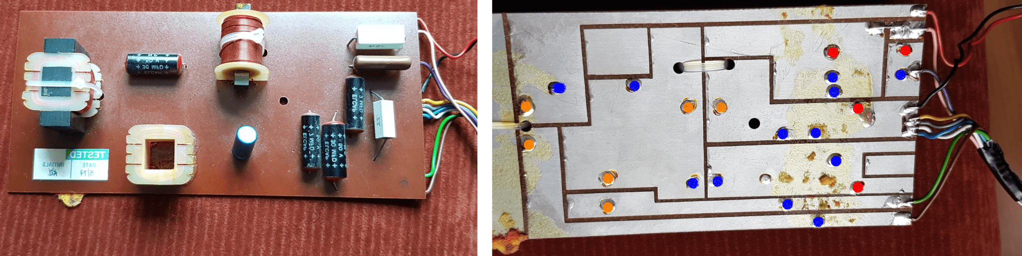

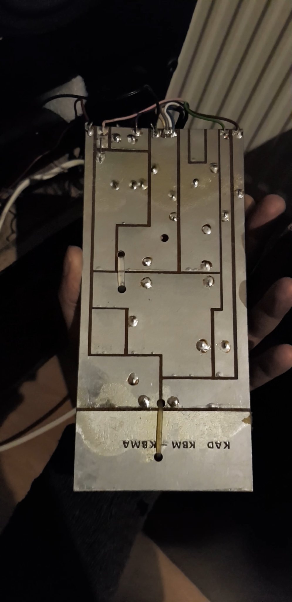

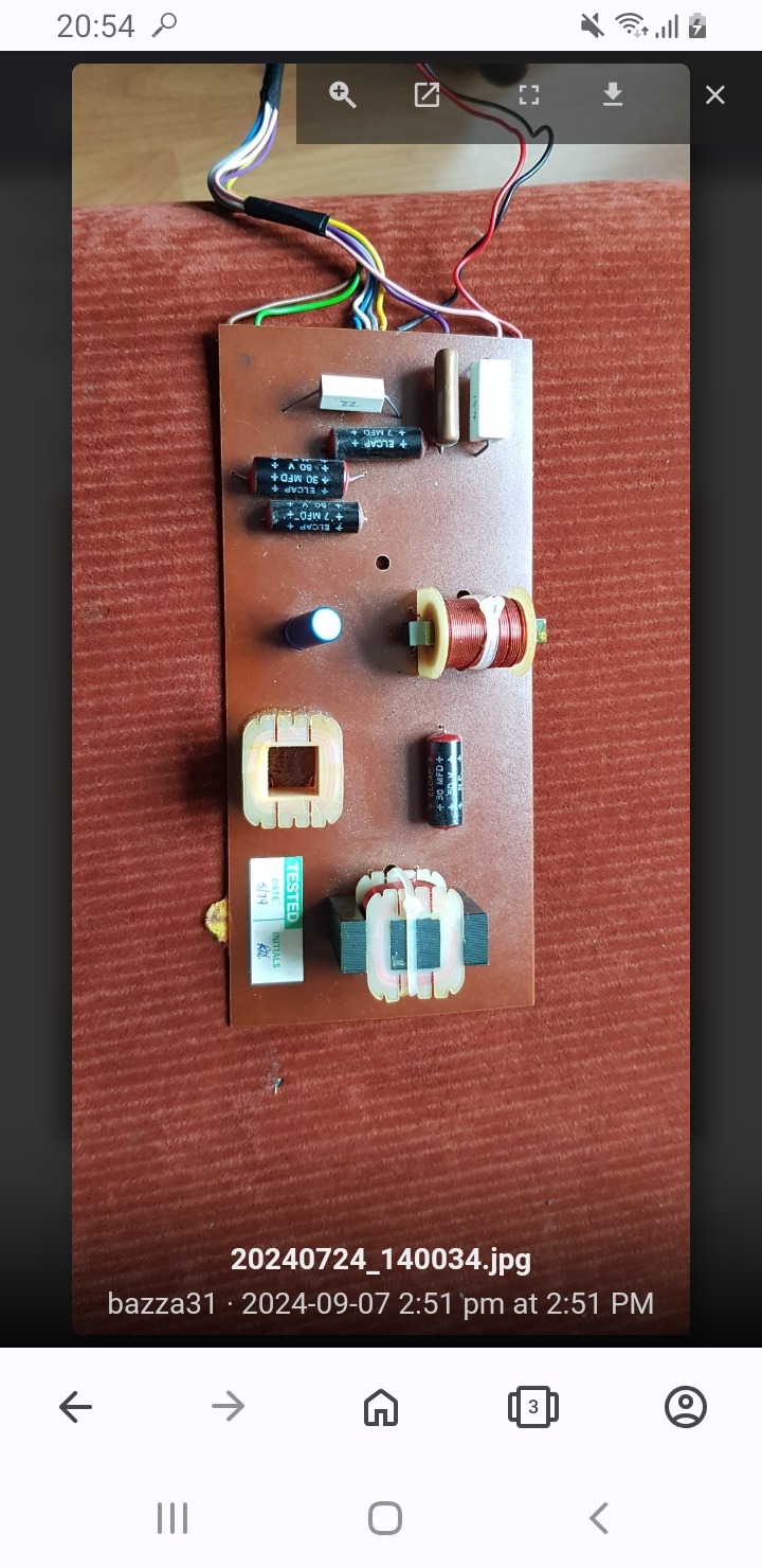

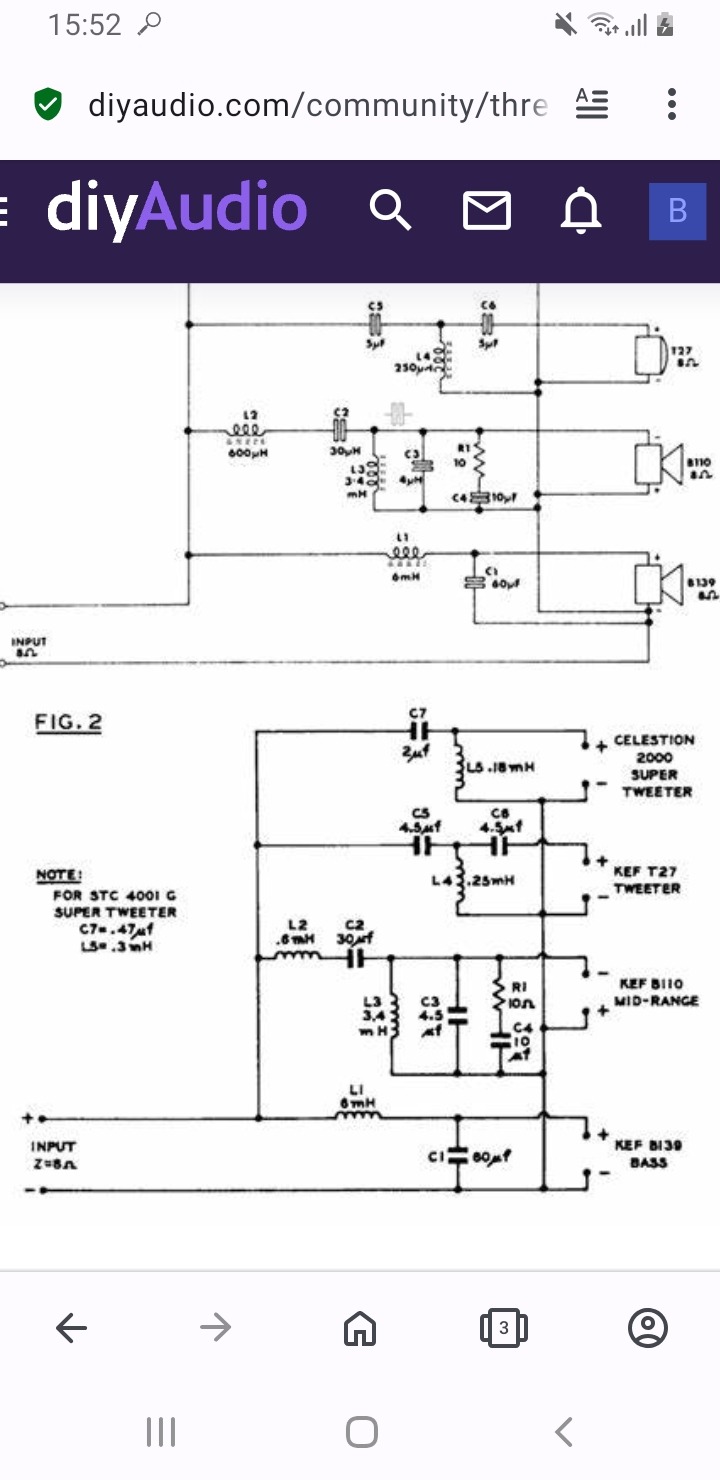

You don't have to modify anything. The T27 is connected to a high pass filter, not a band pass. So it gets the full spectrum from a few kHz up.
Are you connecting the original B139 B110 T27 combo?

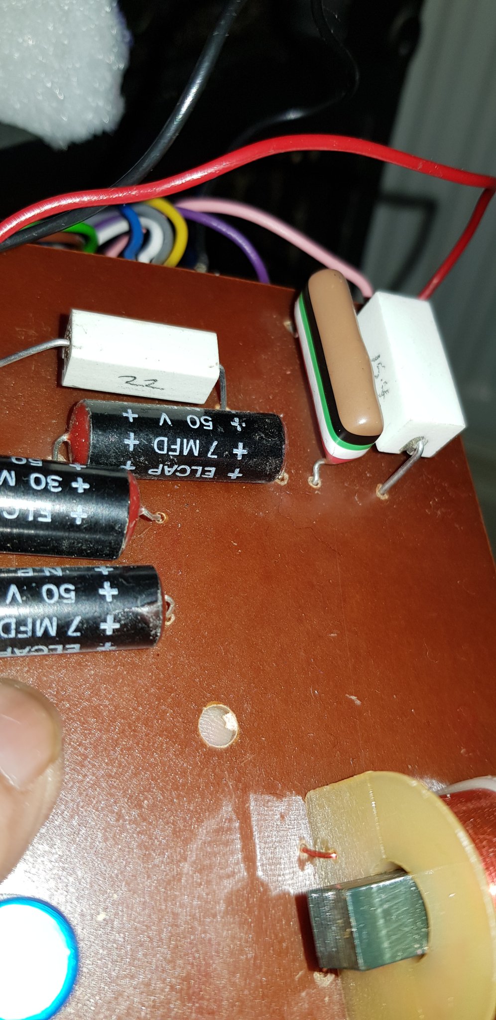

What puzzles me is that this filter is from a high-end English design from the late 1970-ies. Atkinson State-of-the-Art, Roger's Monitor. But the components (electrolytics, iron core inductors) don't look good at all. For sure the electrolytics have dried out and lost much of their value. Most of them can be replaced with MKM. And only L1 might be ferrite, not even iron.
Correct diagram

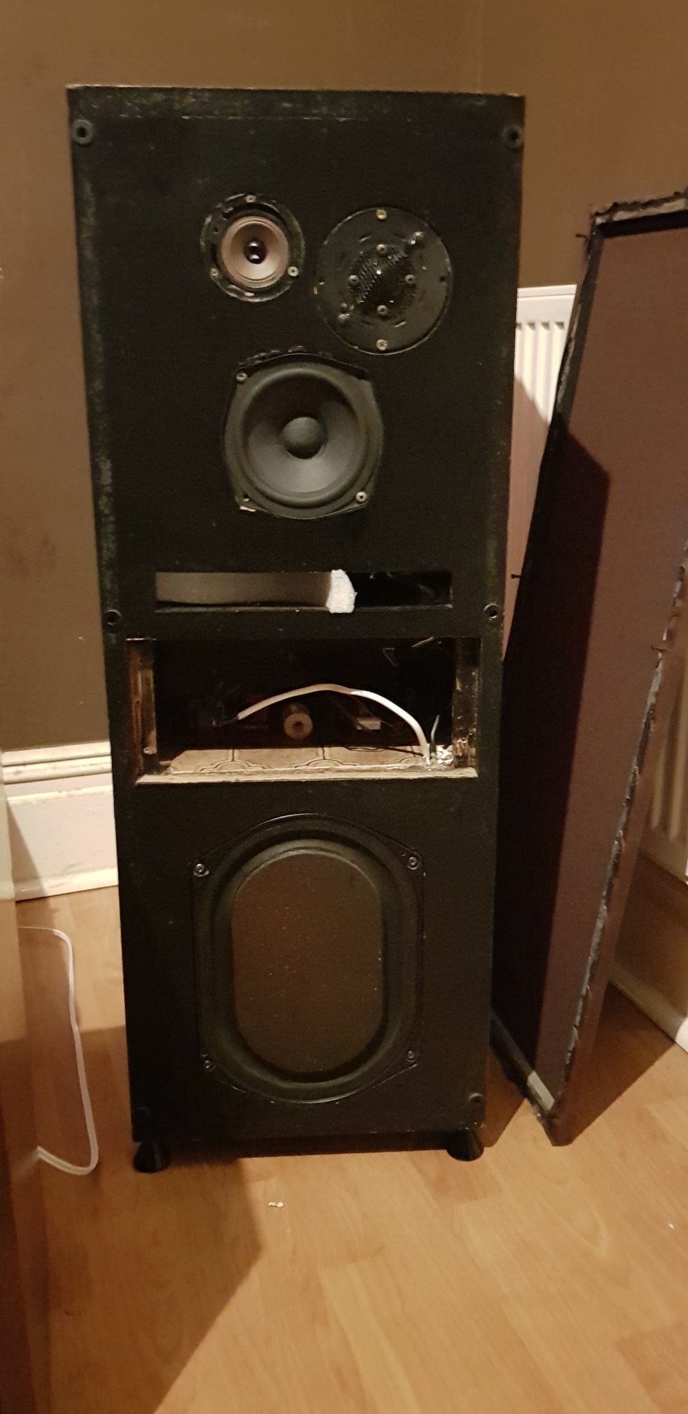

Thanks, I was told by may have been yourself that the TL's in question could sound better with less drivers. So I got thinking "(probably bad idea)" about how I could do this?...hmmm? The capacitor from my brothers old Epos es14's it is 4uf..why not try this for the T and have 3way. So I questioned whether it was possible to attach the cap to the T parallel with M. So can I do this without damage to the drivers and amplifier.
Ok, I was thinking to remove the super tweeter and connect the tweeter parallel to mid with the 4uf if its possible. So the crossover delivers to the bass and mid, then connect tweeter in parallel to mid with 4uf? Will I get full sound?
What do I recommend? I guess I'd leave it as is since it's a regular 3-way that way because both the tweeter and the super tweeter were running all the way up anyway.
Unless there's a problem you're trying to fix? Was there something about the 4uF and the Epos I'm not seeing?
Why do you want to change it, what itch do you need to scratch. If three drivers was good enough, why would the designer use four. Makes no sense. Changes does not necessarily mean better. If it is worse, which I imagine it would be, then you need to put everything back to what it was before. And the point of the exercise is.... moot.
